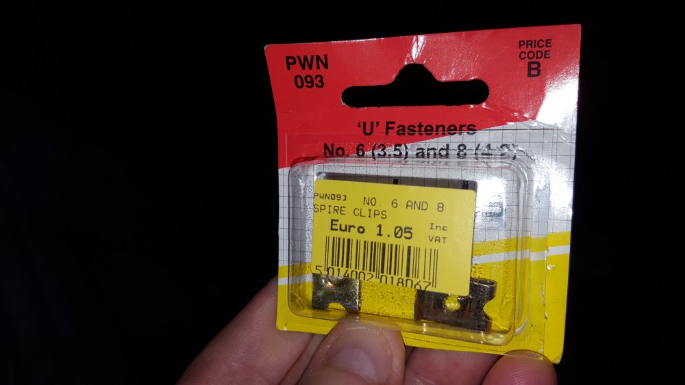

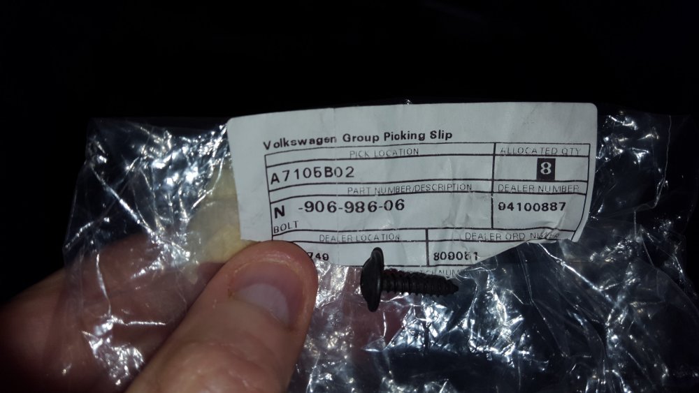

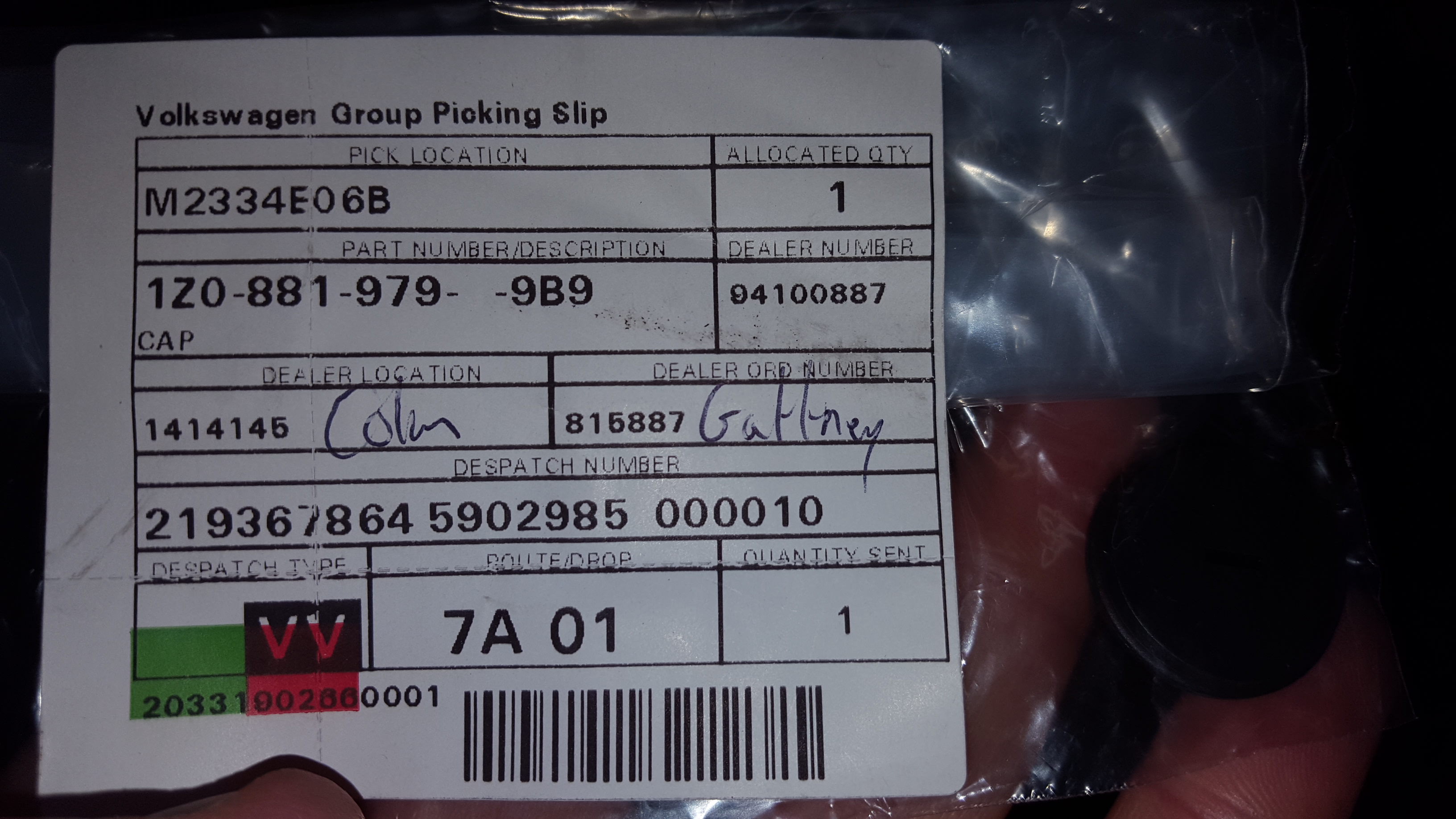

i bought the box from the parts dealer but it didn't come with speed nuts or screws. could anyone help out with the part numbers for the speed nuts and screws? thanks
I had a look in the shed and found these.
The speed clips weren't a Skoda item, but the others were.
Thanks @GAFF! Appreciate it.
