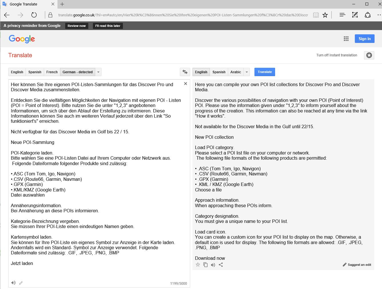

VW POI Site is broken!
Hi guys. I've just been to the VW POI site to create a new POI list with my latest speed cam updates from Pocket GPS and found that the site no longer works!!
The usual web-page link ( http://www.volkswagen.de/de/navigation/discover-pro/poi-listen-sammlung.html ) refused to load.
I've found a new page which when put through Google translate appears to be a new version of the old page ( https://webspecial.volkswagen.de/de-de/infotainment/downloads-nav-companion ) with the same functionality BUT clicking on the buttons has no effect. I've tried in Internet Explorer and Edge but same result in both.
As the Skoda POI update as never worked this now leaves us with no way of loading POIs to the nav system.
I just can't understand why Skoda has still not fixed their site, it's been broken for at least 2 years.
Can anyone get the new VW site to work ??
Edited by Rifleman
Attached google translation
Go to the first page of this thread. Find my 'how to' entry dated 8th March.
The link in Step 2 is the one you want.
Rifleman, Yes you are correct the buttons don't work, it is very frustrating.
@BillyJim your link did work originally but it won't now.

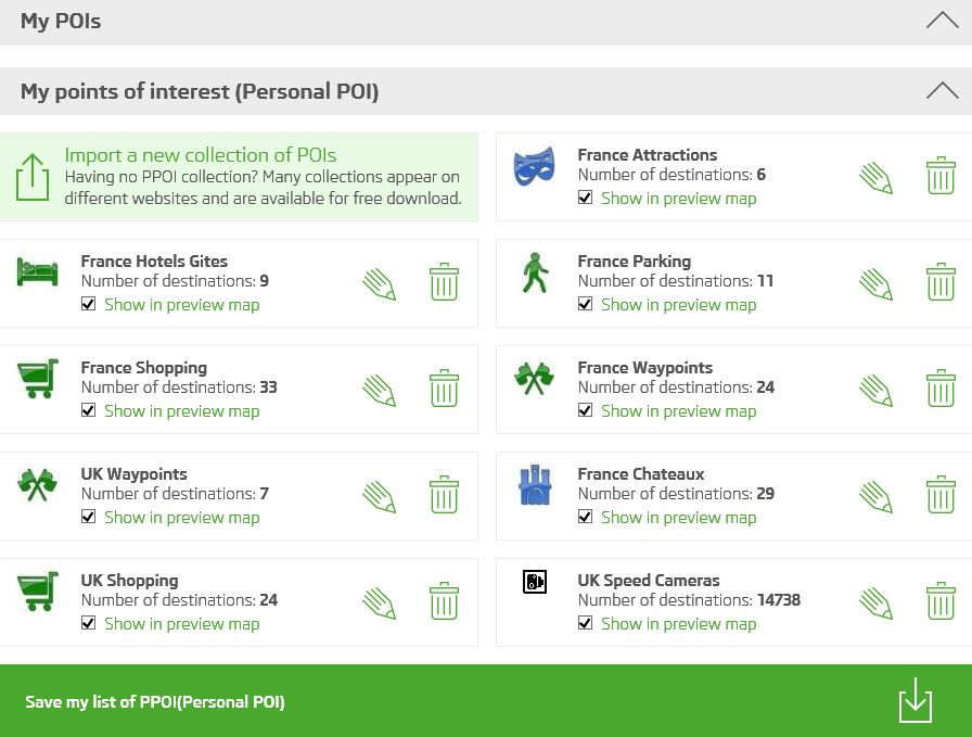

I've been experimenting with the Skoda My Destinations portal.
None of my POI  .kmz files from Google Earth will import. The site processes them but the resulting POI set contains zero entries.
I looked around for POI format converters and finally found 1 that will convert .kmz files to various POI file formats.
Tried a few formats until I found that by converting my .kmz files to .gpx files the Skoda portal will now recognise and process them correctly, the resulting POI set now contains the correct number of entries ! ;0)
I've also downloaded the speed cam database from Pocket GPS world in .gpx format and that is accepted and processed too! ;0) ;0)
Now, do I have the courage to try to upload the data to my Columbus..... :0|
I'll get back to you.
I have been using .gpx files from the start. The Skoda portal processes them fine but the file it then gives you to put on an SD card and import onto my Columbus is not recognised when inserted in the car.
I only hope you can make it work!
