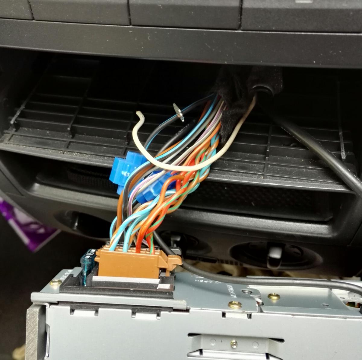

Then I took it out, and these are the wires:
Some red, but no yellow.

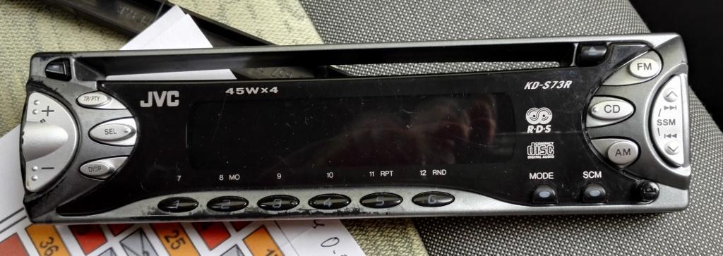

This is the stereo:
Any suggestions?

What are those blue connectors for? Looks like maybe an aerial booster?
(Edit: see my next post)
Edited by wiredsoftware
At least one of those blue connectors seems to be on the "black with blue stripe" wire. That wire is the permanent live that runs directly from fuse 45 in the fuse box. I'd be very suspicious of whatever that is giving power to.
If you need to move it to a switched live, I think it's the wire that's brown with red stripe on connector A to the head unit is switched with the ignition. Make sure you get the one from the right connector, as there is one of the same colour on the speaker connector!

Take the Scotchlocks off and see if the current drain goes away. Then see if anything doesn't work that previously did.
That is indeed an aerial booster and it should NOT be attached to the permanent live.

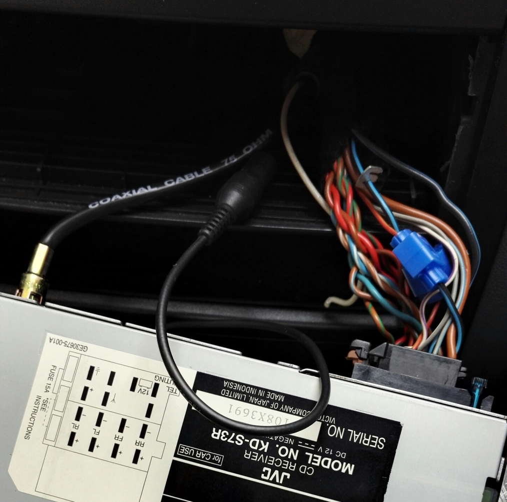

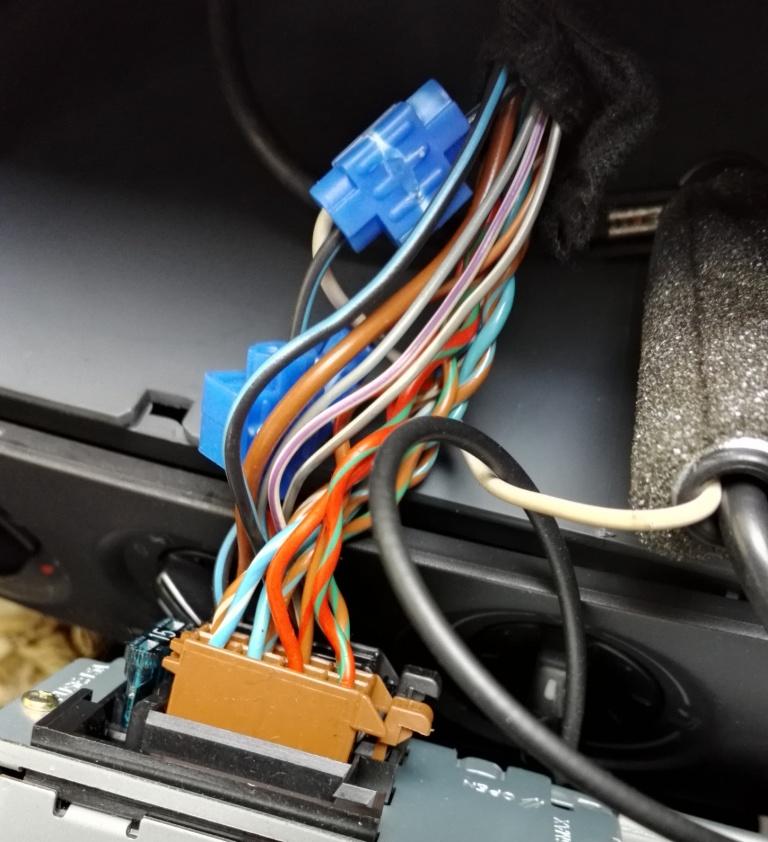

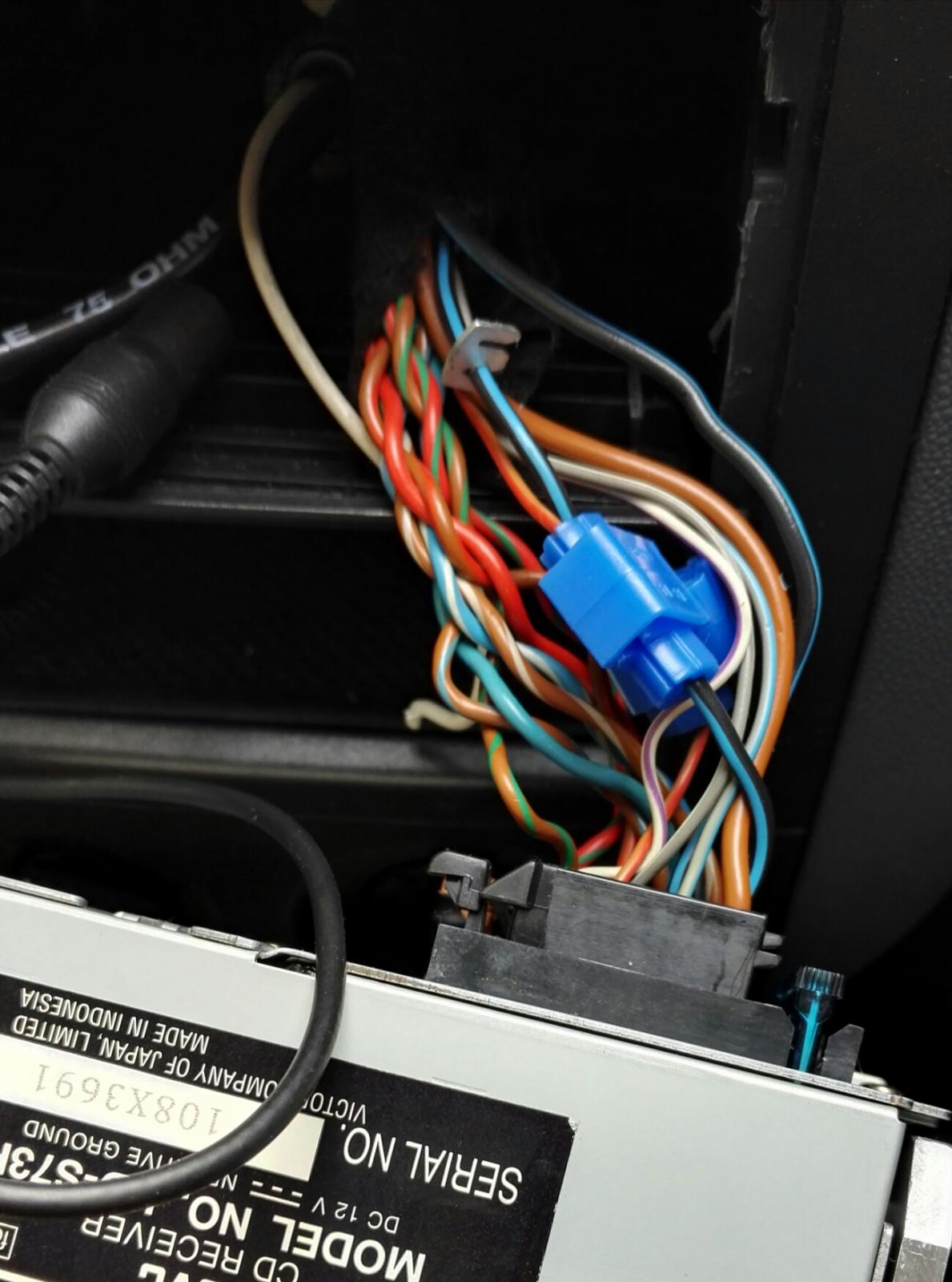

I think I've clocked what is the aerial booster.  I've uploaded a couple more photos with the unit turned upside down to get a better view of the wires in the black connector... Do you mean the switched live is the thin brown and red wire coming out of the black connector??
Also, the thicker blue/black wire coming out of the black connector has a separate brown/red wire scotchblocked to it. What's that all about?

What Flapperjack7 meant to say was I think "Speaker connector is the brown block (i.e. all the speaker wires are on the brown block). The Black BLOCK is everything else (e.g. power cables, earth cables...)"".
I see in the second picture that you have part of a scotch connector still on the black+blue wire (the metal bit shaped like an "E"). For God's sake remove that, it's at risk of shorting behind the radio and causing a fire.
"Do you mean the switched live is the thin brown and red wire coming out of the black connector??"
Yes. In your pics there is a brown+red wire that is just under the black+blue one, that is the switched live, the white wire should be patched into that to put the booster back.
I can't see properly, but it looks like the brown+red wire may already have another connector on it underneath the one you have pictured, don't know what that is doing...
