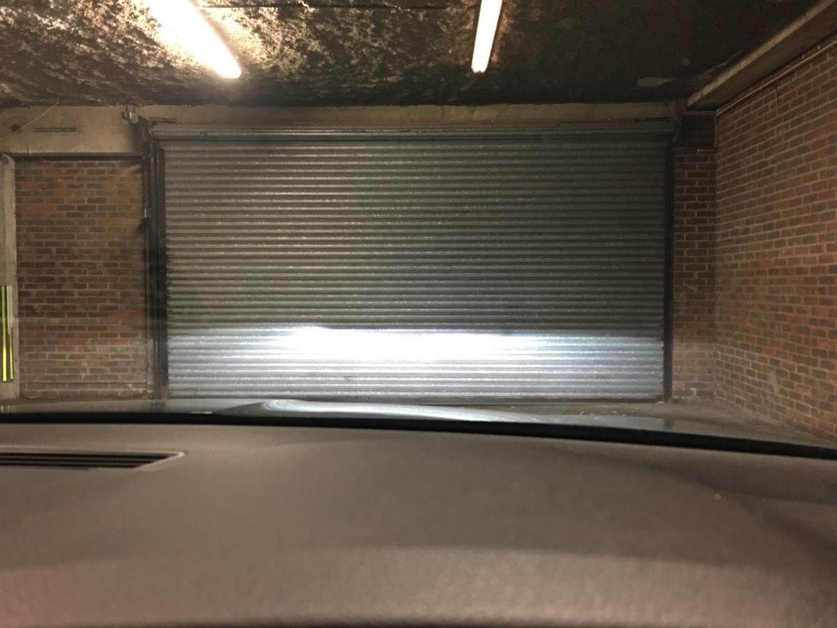

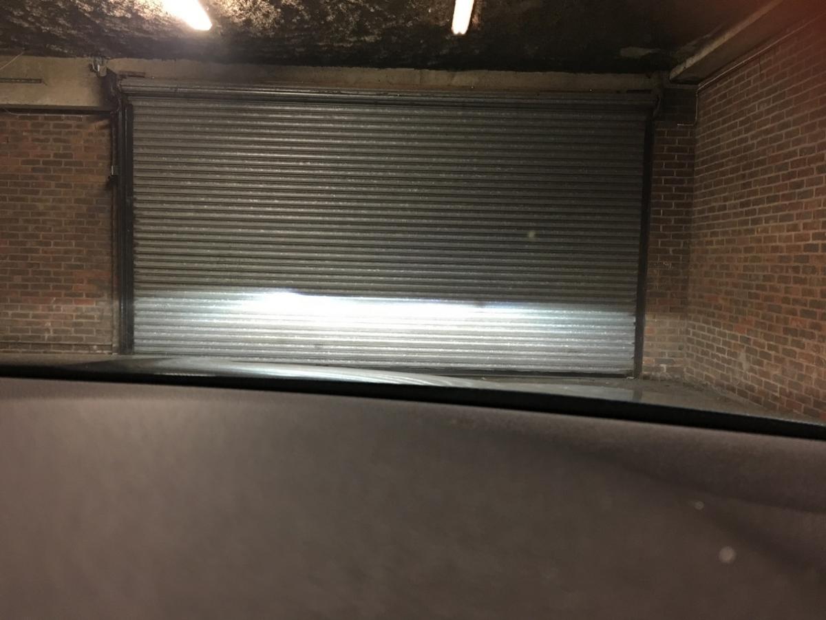

Sorry everyone but I didn't get a chance to get a before and after video. I haven't installed my dash cam and filming with my phone whilst driving was not ideal  :|
I took a before and after picture of the headlight beam, but to be hones it's nigh on impossible to pick out any difference in the pictures, you can thank my iPhone for that.
In real life the new lamps do look a little better, a colleague of mine also thought the new ones were better. They also turn more more blue when warming up which would suggest the chemistry in the arc chamber is quite different.
It may be subjective but I felt the new lights performed better on the way home from work at 1am. For example, the SLA operation was more noticeable than it has been before which would suggest better light output.
As I say, this could well be a subjective influence, and the lamps have only run for about 2 hours so need more time to burn in.
The jury is very much out on this one, folks......
Before:
After:
Slight difference alright, the upgraded ones seem to have more light lower down....... or I need an eye test...... :-)
The new ones certainly seem to be brighter as the door is ‘washed out’ a little bit more than before.
I was hoping there was going to be a bigger difference, not sure if is worth the extra cost... yet.

I don't think there will ever be a 'night and day' difference when comparing OEM standard/E marked lamps like this because they are all the same wattage and all have the same luminous flux.
The only major differences are the chemistry inside the arc chamber and how the igniter on the base of the lamp (D1S and D3S) manages the current for the arc. I'm still curious about the claims of a longer beam throw. The cutoff element in the projector unit is what dictates the length of the beam - headlight aim aside.
Anyway......I'll have to let them burn in a little before making another comparison against such a scenic backdrop as that roller shutter  :D
Position of the arc perhaps?
I would expect the arc chamber to be in the same place across all E marked lamps. Maybe the arc shape is slightly different? I'm thinking out loud here, I might be wrong.......
Before:
After:
Beam pattern seams a bit weird...
Edited by fuzzz
I'd say the foreground is better lit and the throw against the shutter door is definitely brighter. Difficult to judge but looks better to me.
If you look at right side wall on both pictures you will notice "after" shot is brighter than "before" shot. This indicates exposure for both shots were not the same. You can take a look at details on original files on your computer to confirm this. If you correct for exposure, you will probably get two almost identical pictures. I'm not saying upgraded bulbs are the same as OEM, just it is very difficult to judge from posted photos.

I'm still expecting the lamps to perform better once they have had time to run in a little more.
The only way to photograph the difference is to shoot in manual on the camera.
Shooting in Auto mode will show different exposures and not be accurate.
