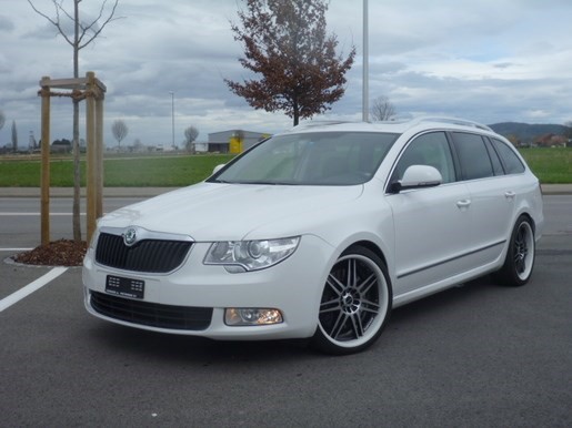

I run 19's in the summer (came with car) and 17's in winter (also came with car). Photos of my car below on the 19's (and more on here in the gallery too somewhere...)
I love the 19's aesthetically and when I'm on my own or with one passenger all absolutely fine. Four up with load the inside rears rub...
On 17's all fine whatever is in the car...but the arches and 'stance' of the car looks empty.
Ideally I think I'd go for 18's ideally, 8" width all round possibly....
But for now, until the tyres go, I'll stick with the 19's and the family can walk or get the bus  :D  :x  :p
