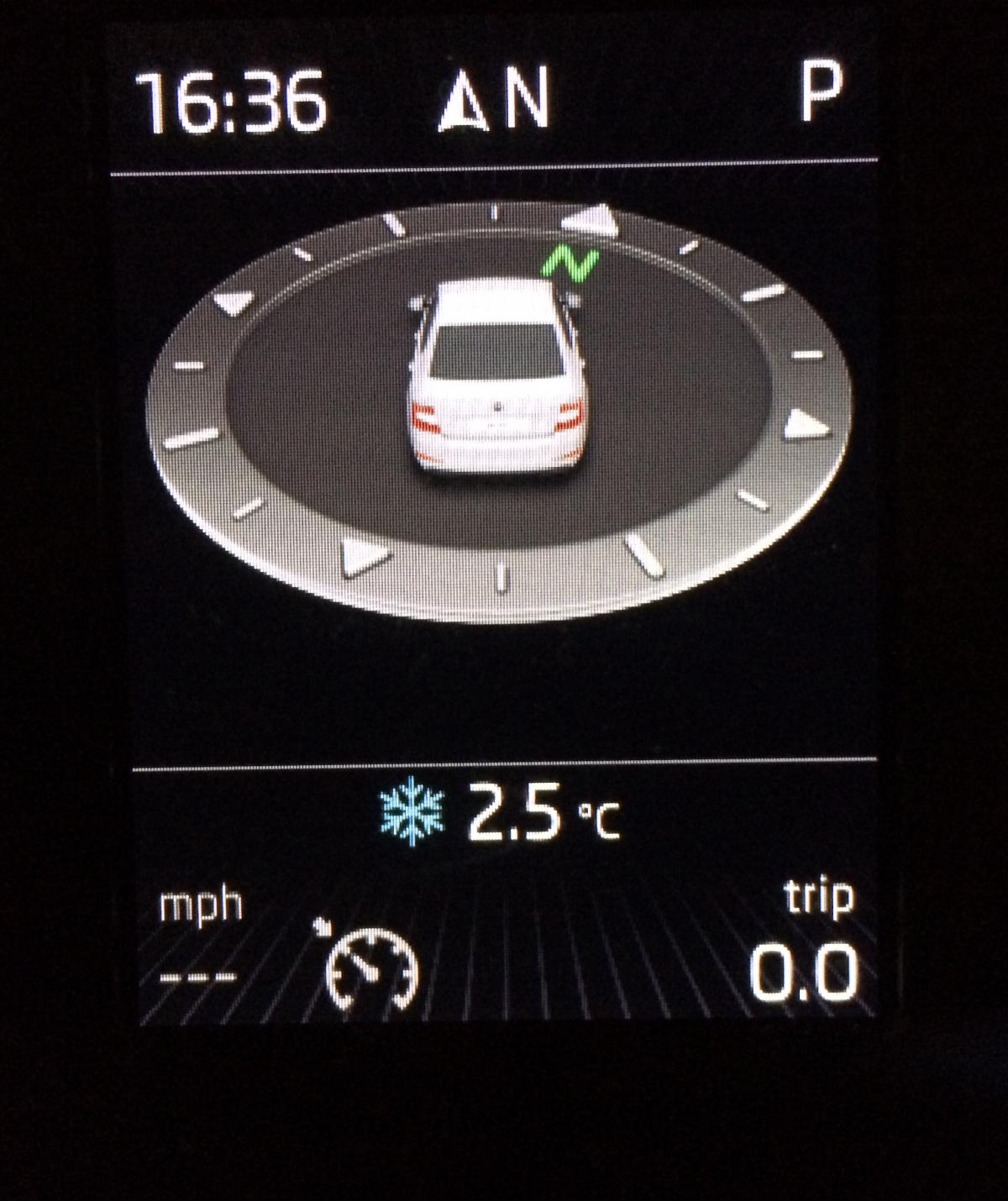

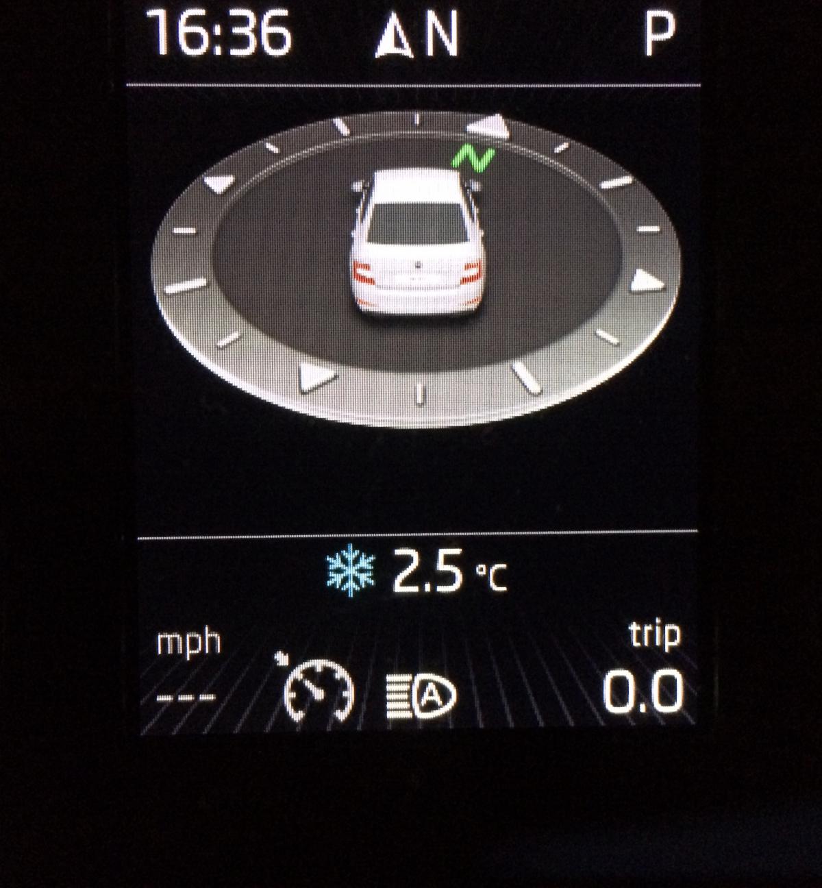

When HBA is ON you'll see a lamp symbol in centre of display. When it's OFF, you won't. See pics.

I didn't see that.  I have checked & do have HBA, perhaps I need to activate it via the menus system, I assumed it was on by default.
Is that the same for the non colour maxidot display?
