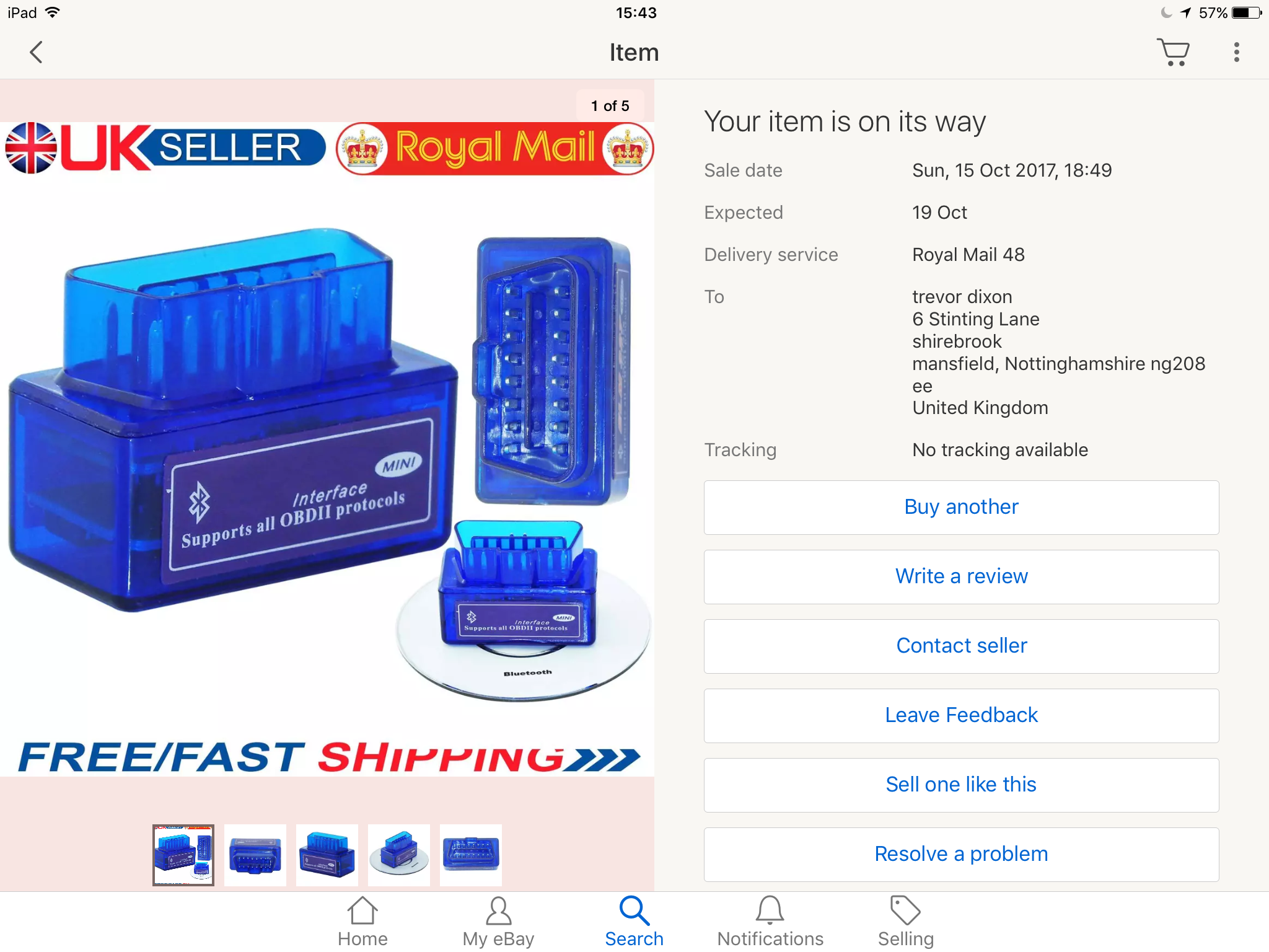

Hi speed man what obd2 did you buy mate
Hi, My OBD reader was a cheap one from ebay - did work fine but is now playing up and although it connects to the app, it doesn't give any readings.
Obd2 mini it was £3.75 it works fine its just elm
Edited by Razzertrevor
Have you tried another free app to make sure it is your obd2
