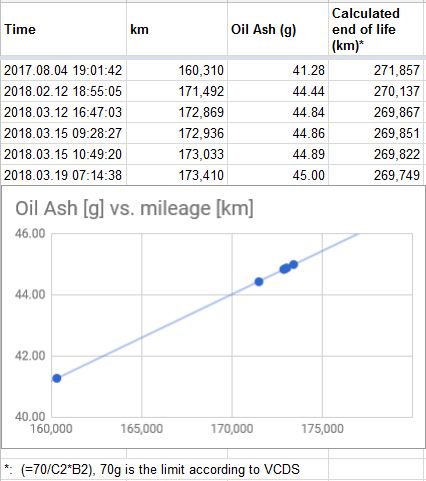

Based on the logs provided from VAG DPF I've started to monitor the oil ash value on my 2012 CAYC Octavia. You may also find this info useful.
Since 2017.09 I also use the car in the city (2x12km/day), previously I only used to travel only on highway (180km continuous routes ). I worried about the DPF lifespan and it looks like my concern wasn't irrational if I presume, that the wearing is linear.
(The line in the graph is a linear trend-line inserted by Google Spreadsheets)
I don't think you need to be worried about it as it looks like it's working normally. They aren't designed to last forever and 270,000km is pretty good considering some of the early failures others have experienced.
On my CFHC (2.0 140ps), the oil ash is shown in l (litres) rather than g (grams), I don't record it often but I have a figure from April 2016 and another from today:
- 82,000 miles (~132,000km) showed 0.06l
- 137,000 miles (~220,000km) showed 0.1l
Assuming the maximum is 175ml which is suggested on various other forums, I might get 240,000 miles (386,000 km) from the DPF. Interestingly, there are people claiming that 175ml isn't the maximum and they've hit 250-300ml before having issues.
Based on that, you might find that although 70g is the 'replacement' value for your DPF, it'll keep working above that :)
Since the ash value is held somewhere, how long before we get 'dpf lifespan correction' services :(

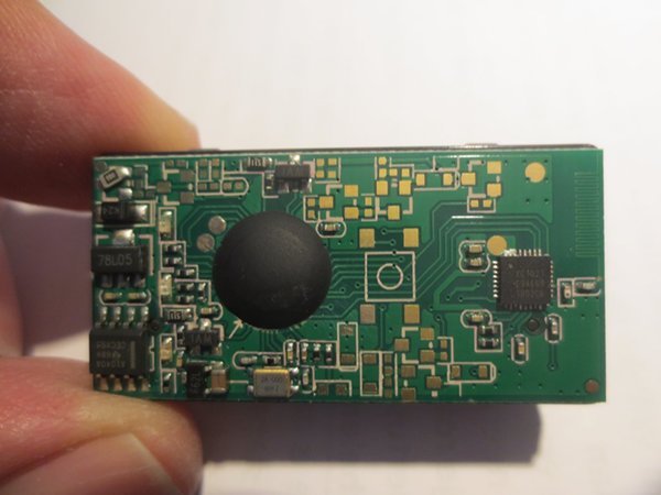

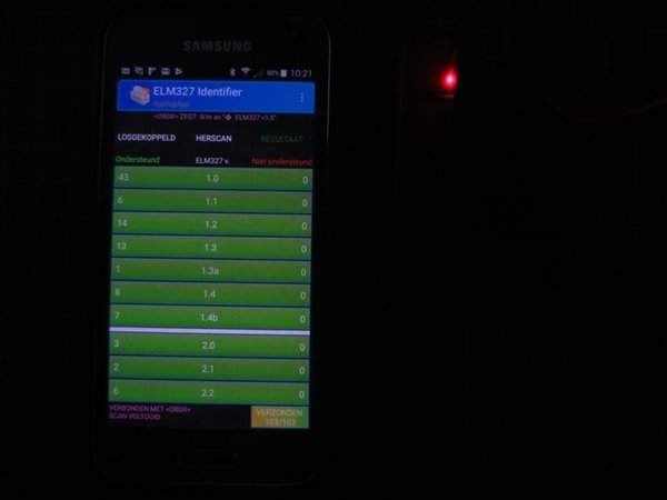

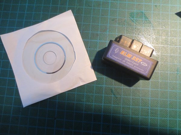

Which odb2 to work best with the dpf app ??
i got this one of aliexpress ,
results , NOT suitable for long term use ( aka it goeswrong after 2 minutes ) .
i am now thinking of the viecar white elm dongle which is bt 4.0 .
Any better ideas/advice  welcome
