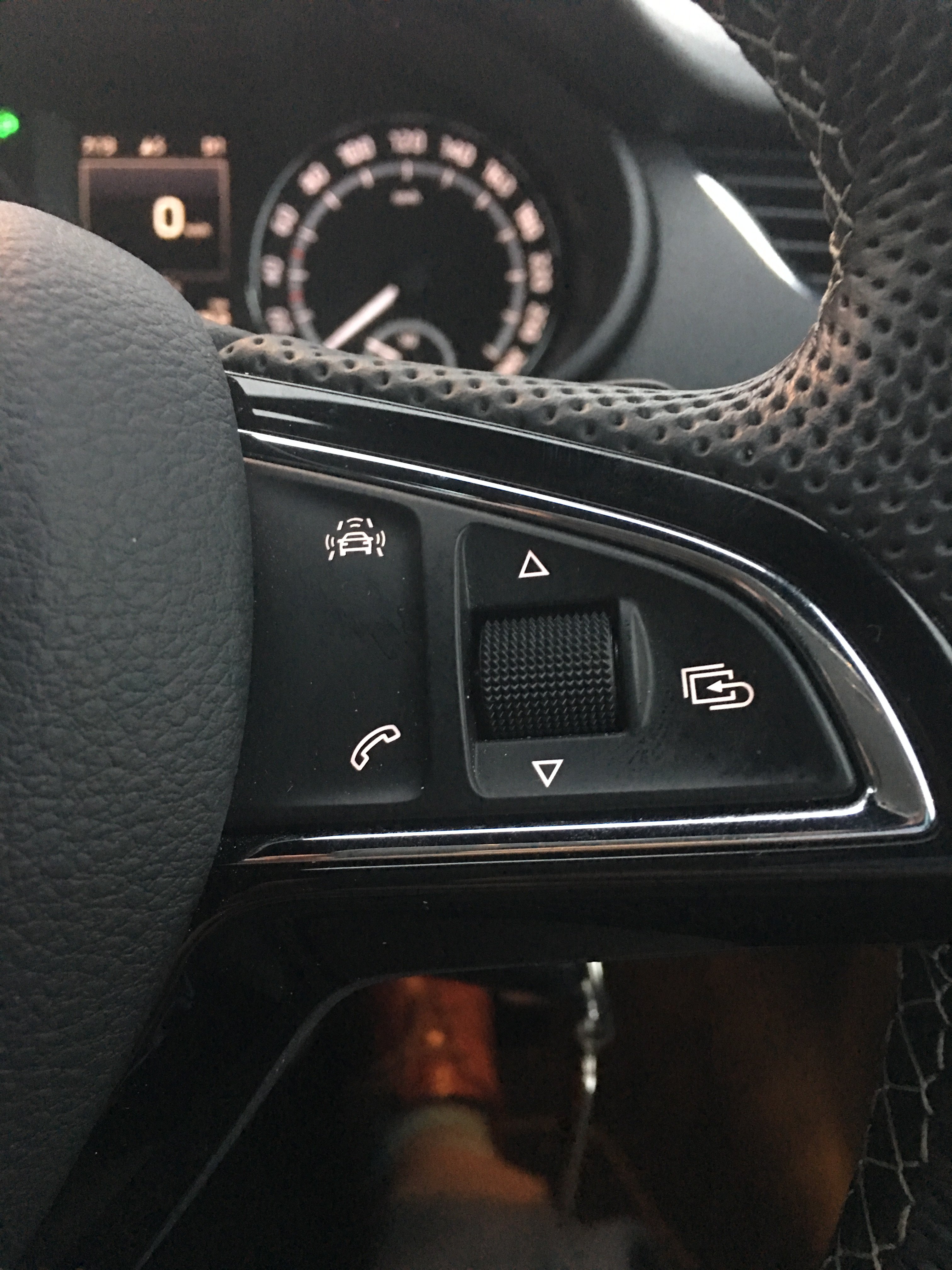

PS: I know you can cancel it on the screen, but didn't realise you can cancel it from the steering wheel @Item - which button?
Mine has a button with a small icon of a top down car chassis with the wheels turned slightly - this turns on/off driver aids i.e. parking.
Not 100% sure you will have it on your Superb!
I misremembered the icon slightly - you can see it here above the phone button on the right hand side of the wheel
Thanks @item - yes, I do have that button. I'm not sure I've ever used it! So I guess one press will switch the reversing screen back to normal if it's hanging around? That won't switch the reverse sensors 'off' though will it? I need them to check whether the backend has left the next county or not, even if they do hang around a bit longer than I might like at times... :biggrin:

Yup! just engages/disengages as you like, but doesn't stop it from turning on/off automatically. I think if you have other driver aids like lane assist etc it may trigger those on/off instead if you are going fast enough, but don't quote me on that!
