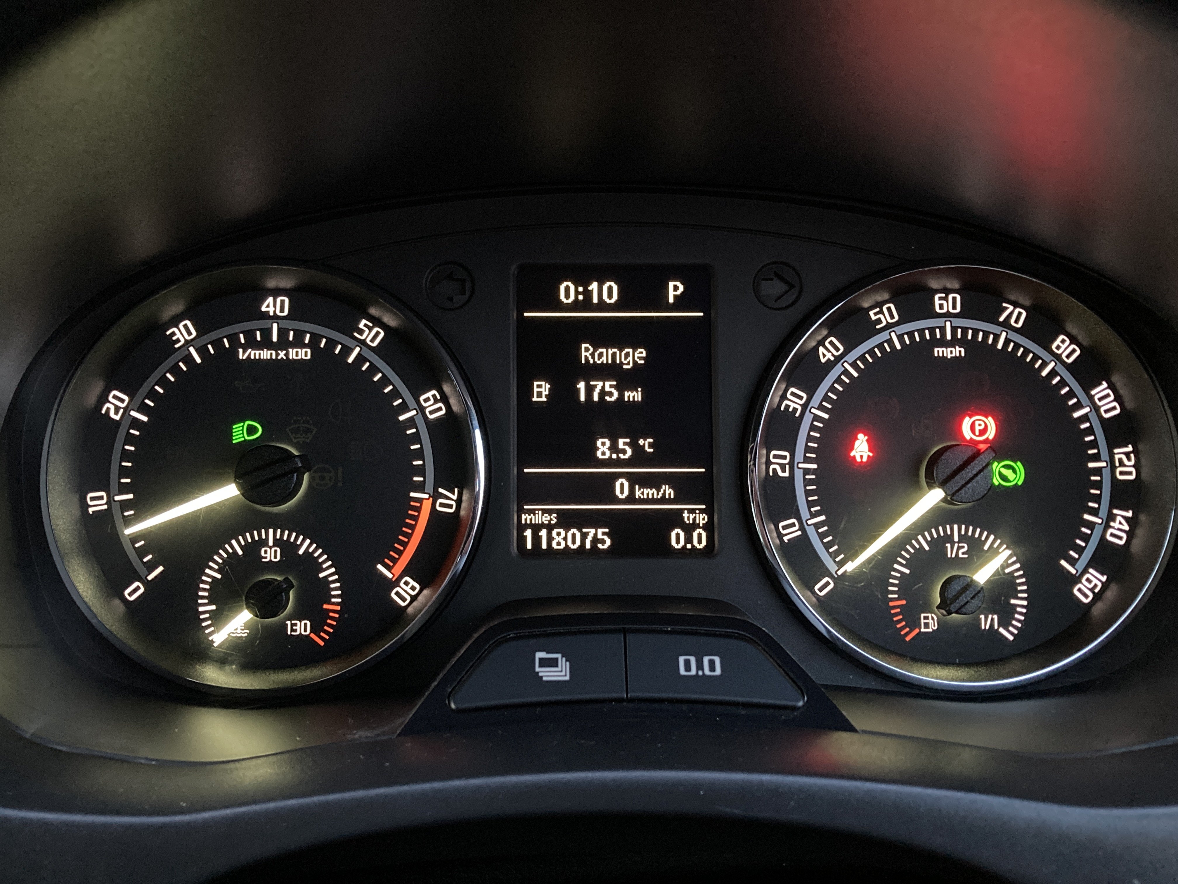

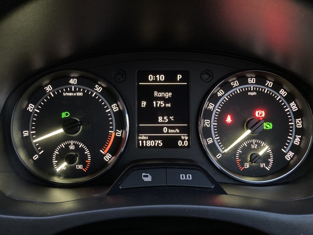

Very good guide! I had the leds behind the rev counter and Speedo needles fail. Bought a pack of LEDs for £2 and was a straight forward fix on my 2013 Fabia VRS. I replaced the temp and fuel needles at the same time to ensure they all match. Realistically took 1 hour 30 mins.

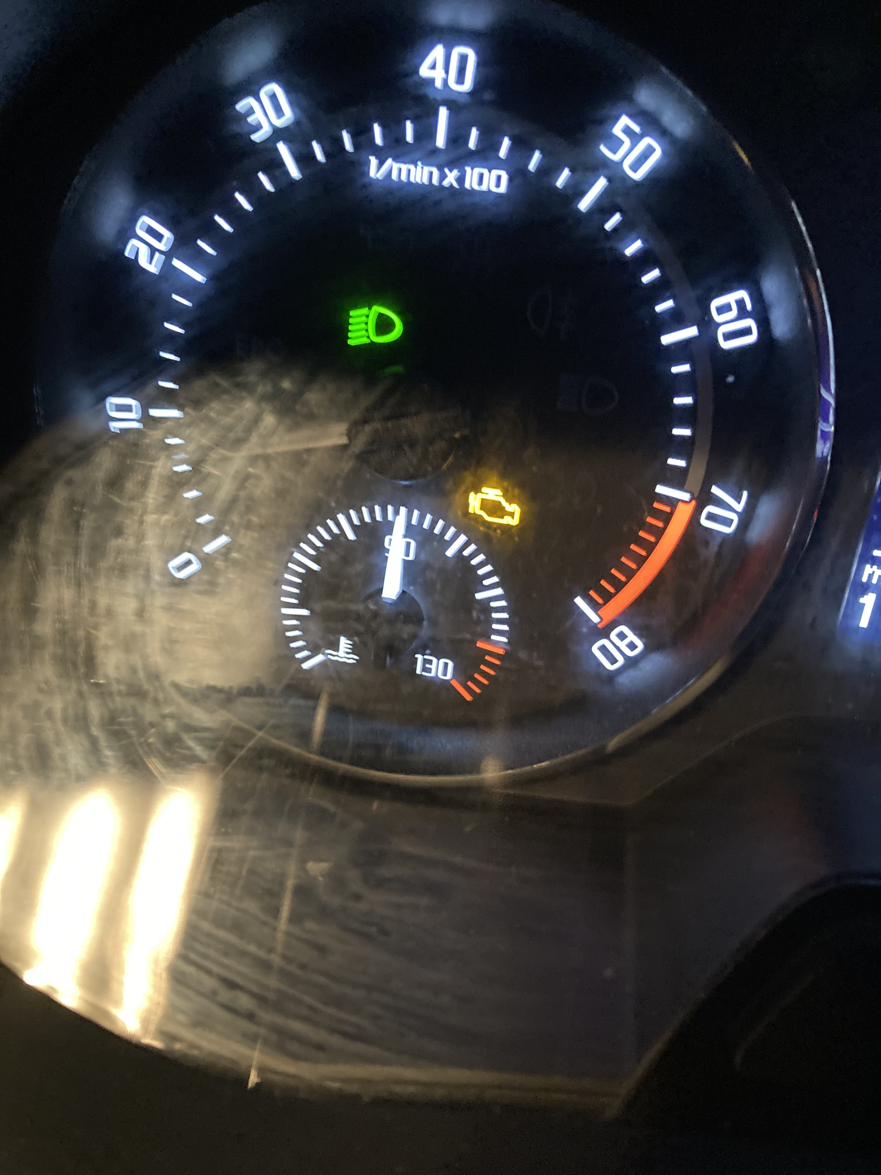

Hey guys, it sounds like this is the solution to the flickering speedo and tachometer lights on my octavia 2010. However, I don't understand how an LED fails so that it flickers on and off? I thought LEDS just died totally. Why would they flicker intermittently? And why did it happen to all of them suddenly? Mine just started flickering recently - the speedo, the tachometer, the fuel and temp gauges. It makes me think some other component that powers the LEDs is the real culprit. Am I wrong? Should I just get new LEDs and solder them in?
