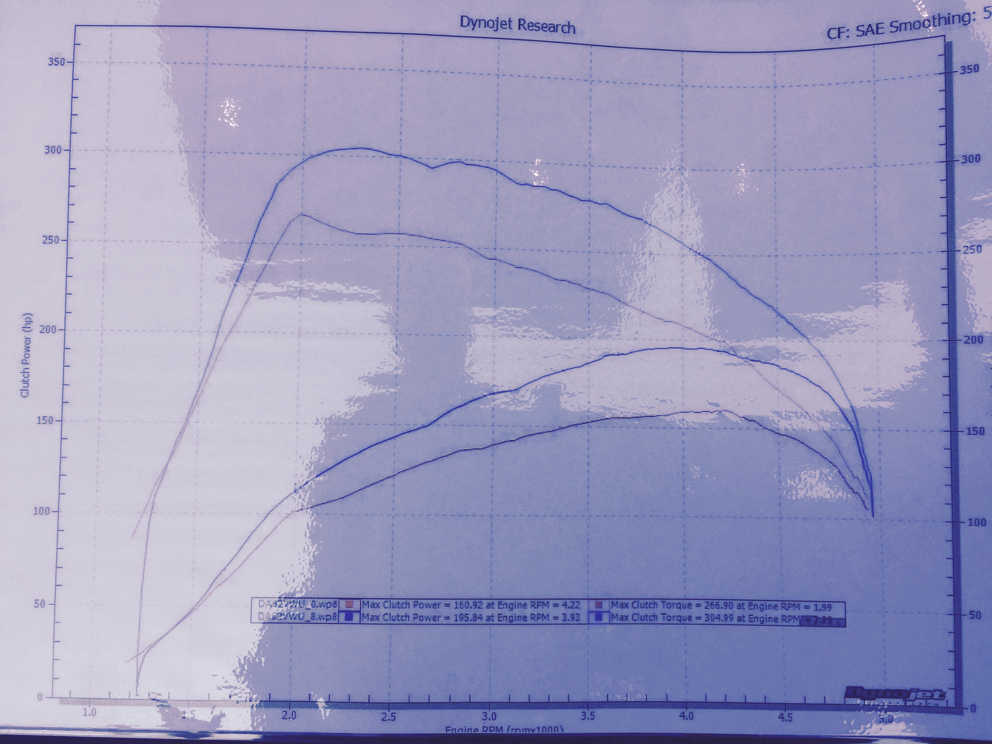

I got the standard 'Awesome TDI - Stage 1' map with dyno runs before/after included on my CR170 DSG..either Awesome's dyno is under reading a little, or my car was pushing out less than expected as stock.. which is possible, but VAGs normally achieve a little more than advertised 'out of the box'.
Even so my results were:
Stock: 161bhp @ 4.2k   -  266ftlb @ 1.9k
Mapped: 196bhp @ 3.9k  - 305ftlb @ 2.3k
So a 35bhp & 39ftlb torque increase.. I'm not one for 'number chasing, but I must admit, I was expecting a little bit more torque out of the remap. It's certainly made a nice difference though, seems a lot smoother to drive, which is quite impressive considering it was pretty bloody smooth to begin with!

Are your figures at the crank or the wheels/axle? For an off-the-shelf remap those figures are quite good. Custom would get you a little bit more, and more control over how it changes. If you have the dyno plot, would you mind posting the before/after here? It would be interesting to see how it changed throughout the rev range.

Photo's below, apologies for the quick 'n dirty shot but I was outside in the sunshine :)
According to Awesome, their dyno output's measured at the wheels. No idea if that's good/bad etc, but from reading your post it means it might explain why they don't show as 'high' as expected, if figures being banded about are usually at the crank?
That looks pretty good. Aside from the peak gains, your torque curve is smoother now so the power delivery will be a bit more progressive.
When I had my old car remapped, the peak power only went up 11 bhp but it developed more power across a much wider rev range than before which made the car much more flexible on the road.
The remap figures for my 2011 car are flywheel figures and it was, IIRC delivering 169 bhp (Slightly better than the 170 PS (167.7 bhp) it's officially rated at - this is another source of confusion PS and bhp are very similar units, but not the same) before any update. My previous 2005 Octavia 105 PD was at 122 bhp before remapping, so 105 PS at the wheels is believable. Both cars were remapped by the same person and tested on the same rolling road. The rolling road was calibrated for driveline losses by driving the car to a set speed and then letting the speed freewheel down to measure the deceleration due to the components between the engine and the rollers.
Based on other posts I've seen, 200 bhp at the flywheel can end up being more like 170 at the wheels, so if your figures power and torque at the wheels you've done extremely well. Since the legend on the graph says max clutch power and I've never seen anyone claim to get significantly beyond 100 bhp/litre without swapping out turbos or other hardware on the CR170 engine though, I suspect you're looking at flywheel figures.

I'll drop them an email and check.. as I say, I'm not really bothered about the actual numbers (although obviously I want to see an improvement for my cash!), so I wasn't chasing figures, just a more 'drivable' car. :)
Looking at the torque curve in particular, I reckon you won't be disappointed with driveability :biggrin:. Once you're over 2000 rpm it should pull like a train - it will spin the wheels in 2nd and even 3rd in wet conditions (1st is a dead loss for hard acceleration wet or dry even without the remap) if you're not paying attention pulling hard away from a stop or through roundabouts. It's well worth getting the limited slip differential (XRD in VW abbreviation speak I think) activated with VCDS if you don't have it on already as it reduces the problem of one tyre breaking traction and all the acceleration being lost. With nothing done but the remap and with very good tyres I'd need to change to a 4WD Superb before any further power increases are justified.

Update - Mailed Awesome for clarification re: the output.
Their dyno can output either wheel or flywheel (referred as 'clutch' on the Dynojet) power depending on the customer's request.
I didn't specify a preference, so was given the default flywheel option. :)
