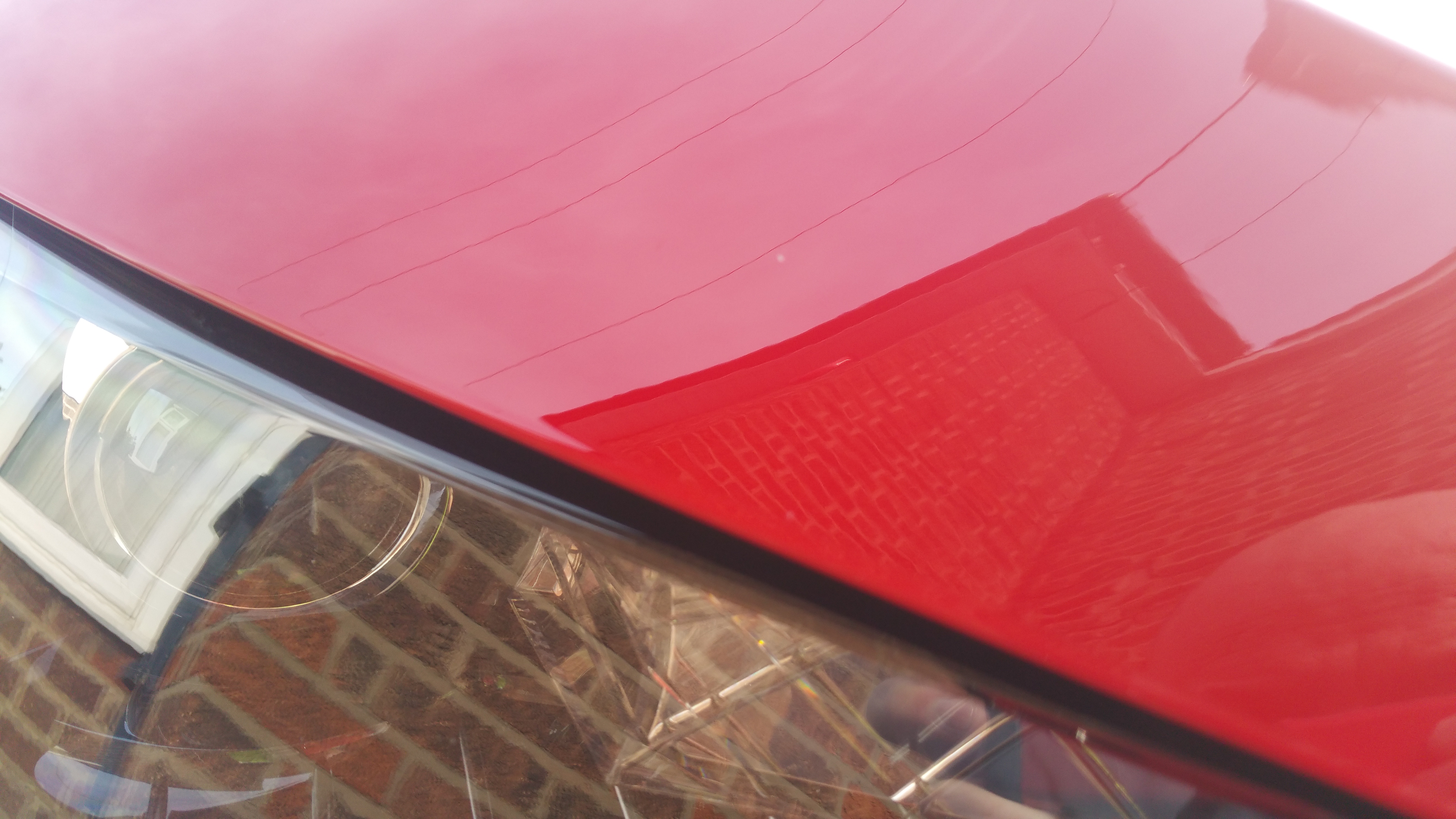

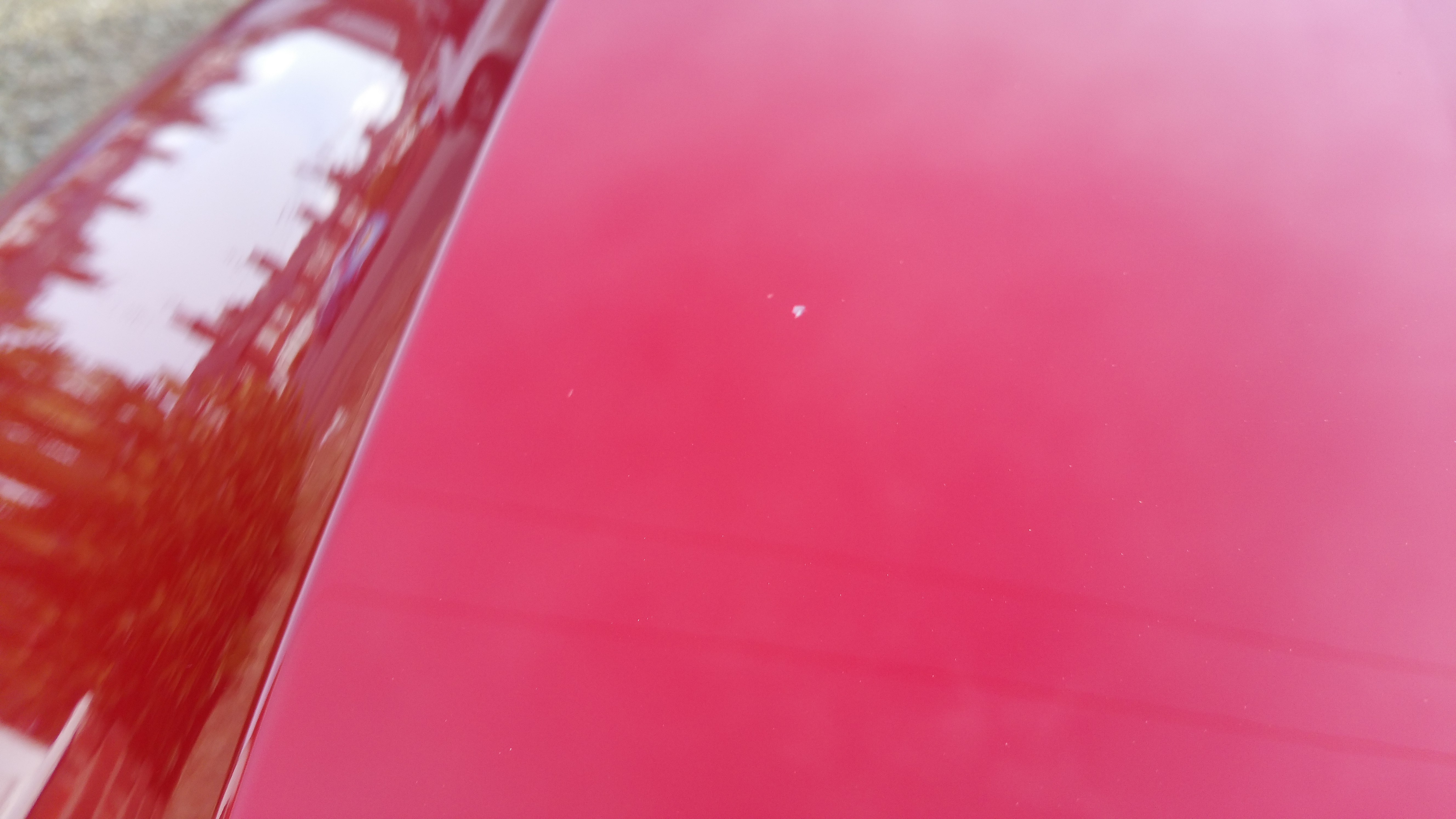

Having washed my car earlier this week I've noticed at least four stone chips on my bonnet of my sportline. I've done less than a 1000 miles and have only been on motorways twice in in the last two months since i took delievery of the car. For reference I also had the car coated with gtechniq cs black and exo when new.
I've always know skoda has relatively soft paint but this is ridiculous. Even my last two vrs's didn't have this problem after three years of ownership (and my last one was corrida red)
Has anyone else experienced this. I intend to visit my local dealer to discuss. What kind of response may I expect?

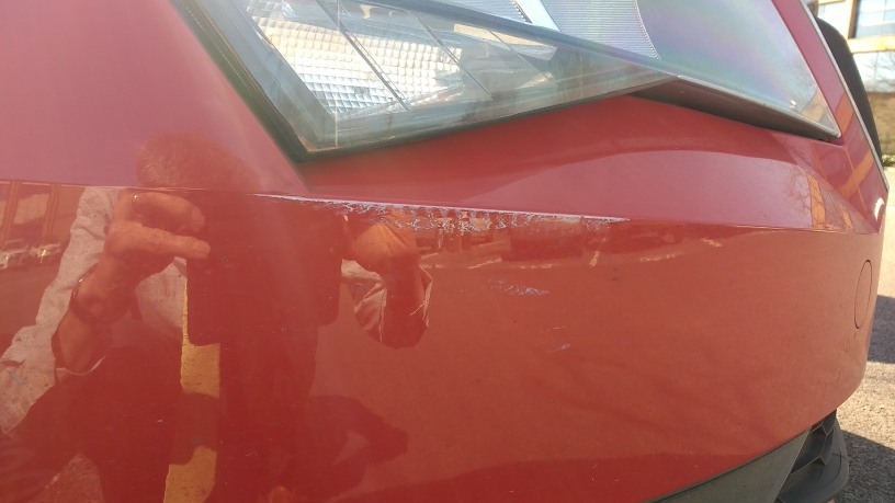

Had a quick look at lunch and it's rough, but feels proud rather than scratched.  I rubbed against a white painted metal barrier on a building site so I suspect I've possibly transferred paint if not scratched the car - the first time I went through a car wash after this the mark did seem to reduce in size.
Looks like this:
I work in Histon, so sort of Cambridge if that's close - grateful for any help as I'm not a gifted car cleaner (hence using car washes)!  Happy to sign any waivers...! :D

Yeah, that looks like paint transfer but could be masking some damage too.  I work in Milton but due to major building work there's no parking (power supply access) close to the office so I can come to you sometime.  The paint will be thin in that area and it's right on a swage line so I'll need to be very careful.
I'll have a go but at best it might be a case of just reducing the quote a professional will give you to sort it properly.
It's a fairly large area, which is a nuisance, but you could try some T-Cut or Farécla G3 Professional Scratch Remover and see if the white comes off/fills in. After, use some red-based polish. Turtle Wax comes to mind. Then, cross your fingers...

Thanks - I'll let you know as the car park at my office is usually full and the attendant doesn't like double parking!  Could meet down the road, but if you need power it won't work.  Appreciate the offer, would be nice to meet another Briskodian!

I'd wondered about some T-Cut but wasn't sure if it would be too harsh.  I've actually got some somewhere, along with some colour wax so might rick it on a small area...!
