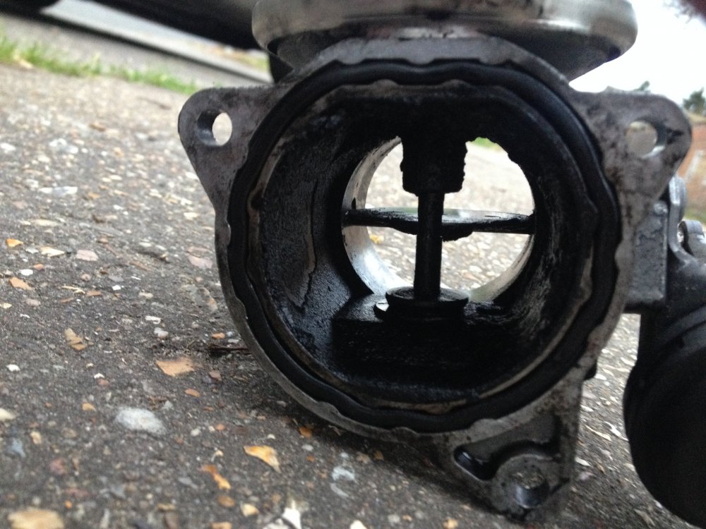

Well, having had an engine light on for a few months now I finally got around to trying to sort it out. The fault code indicated EGR insufficient flow. I admit I should have checked the EGR valve before ordering a new one but as I sourced a brand new valve for £45 I thought I'd go for it.
I removed the old valve (A 5mm ball ended Allen key enables removal of the bottom bolt with relative ease) to be surprised that it wasn't bad at all considering the car has done 179,000 miles and the valve has never been cleaned before. It also held a vacuum to both the EGR and ASV.
After fitting the new one anyway (having checked it held a vacuum first as it was a cheap valve) I cleared the stored fault code and went for a little drive. After about 150 miles, the light came on again. Same fault code as before.
Any advice on what to try next? Shall I just clean up the old one and put it back on?

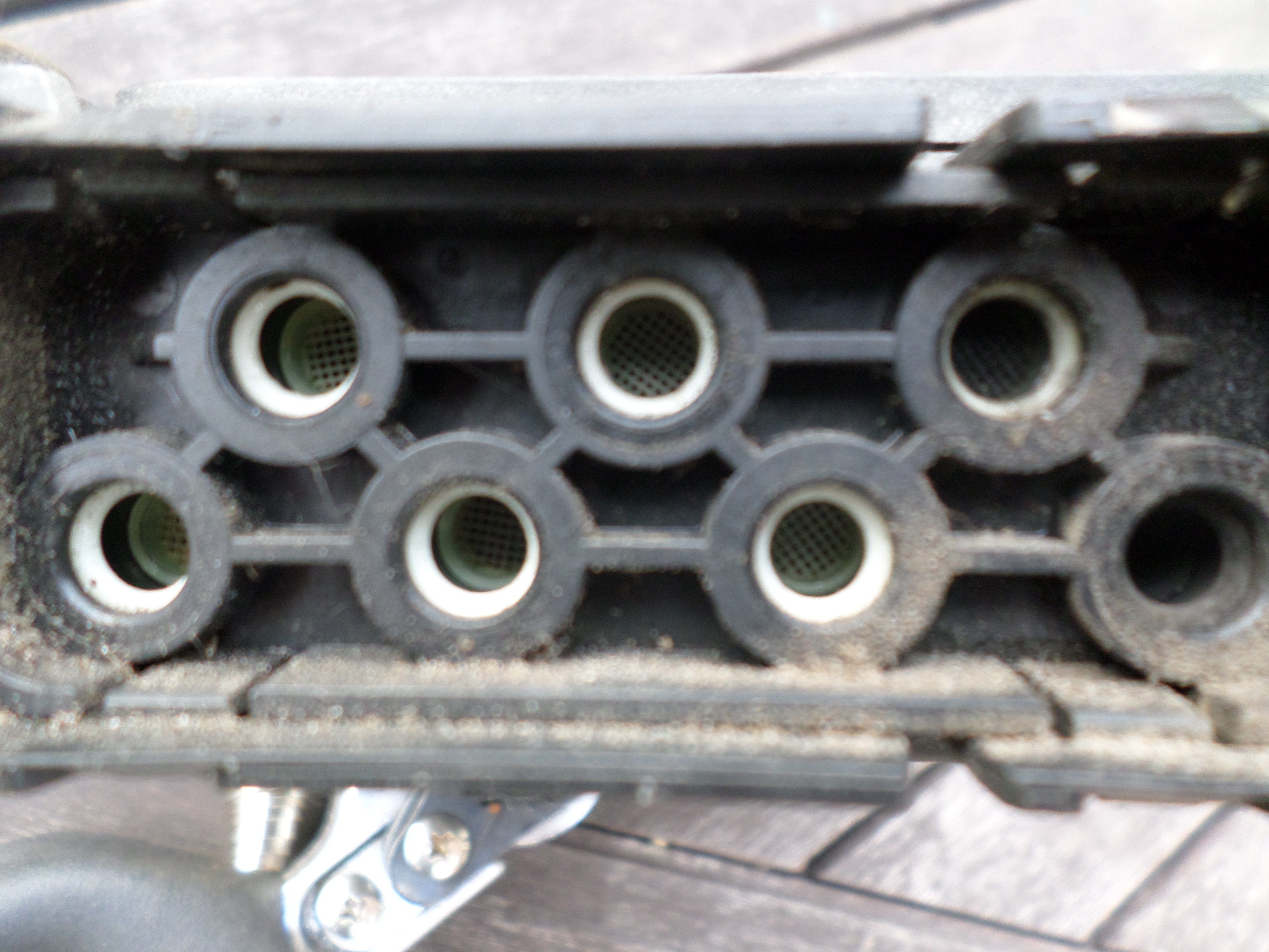

One thing I noticed on the old Vac unit I took out is that two of the ports on it seem to be full of black stuff, each port has a little filter doesn't it, could these choked up little filters be that problem?
If I CBA and assuming the fix is indeed permanent I may just clean the filters and re-fit the unit to see?
So I took a piccy of the old vacuum vac unit, the photo vaguely shows the blackness of the gunk in the filters of the two right hand ports on the shot.
