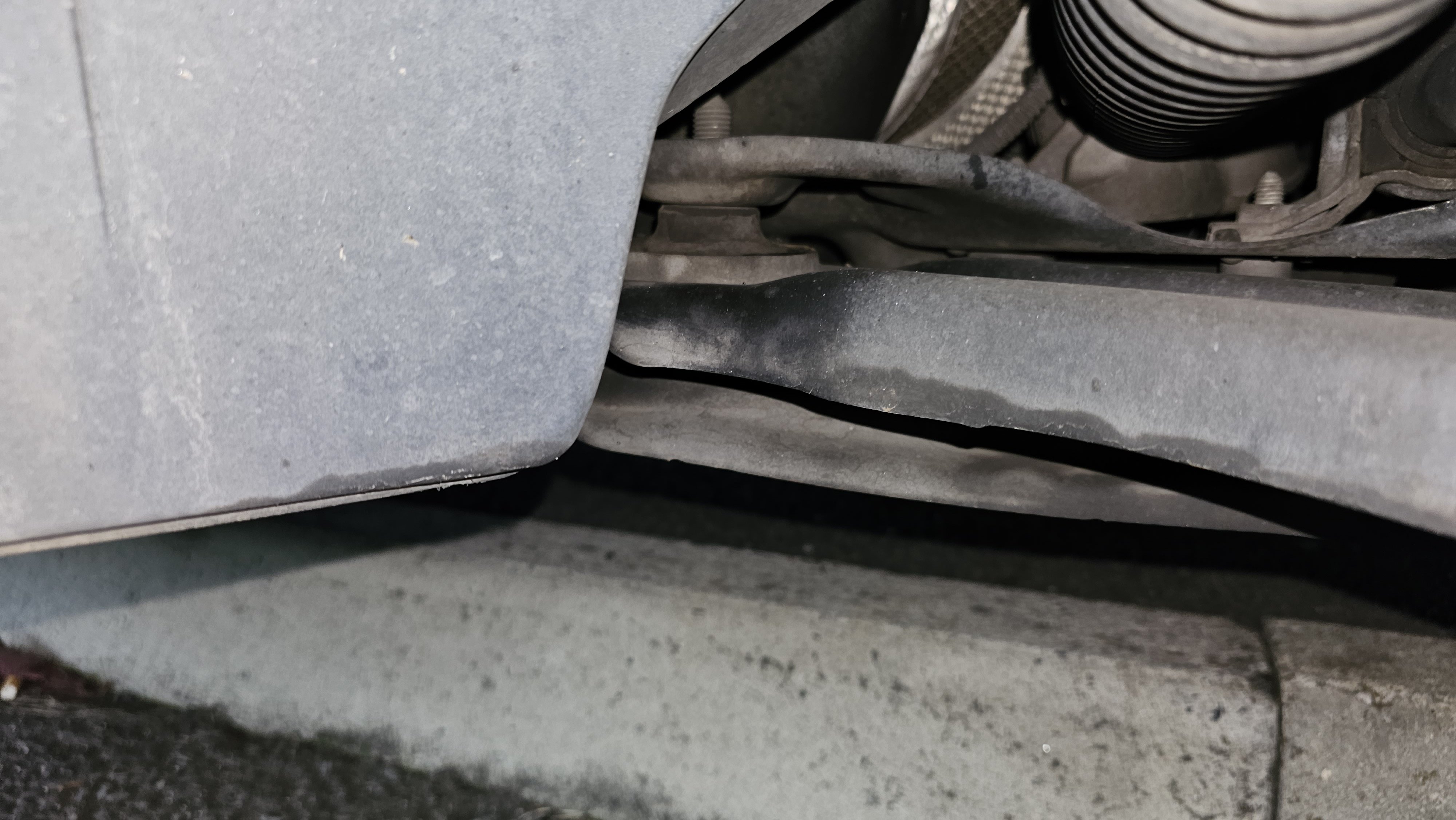

My 2029 Superb has creaking suspension every so often most often noticed over speed humps as well.
I traced it to the wishbone bushes nearest the drivers and passengers footwells where they attach to the under body.
I squirt a few sprays of Holts silicone spray on each bush and it's squeak free for a few months.

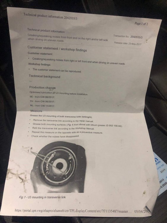

it is fixable … at least my dealer managed to fix it and it’s not come back yet … now been years.
They did the grease initially but then changed something that sorted it. I may or may not have posted what they actually did it’s now that long ago I can’t remember !

If I followed your fix correctly,  replace anti roll bushes but grease up well and must use correct lithium grease.
Alternatively use better, polyurethane pattern part bushes not the cheap oem ones,
