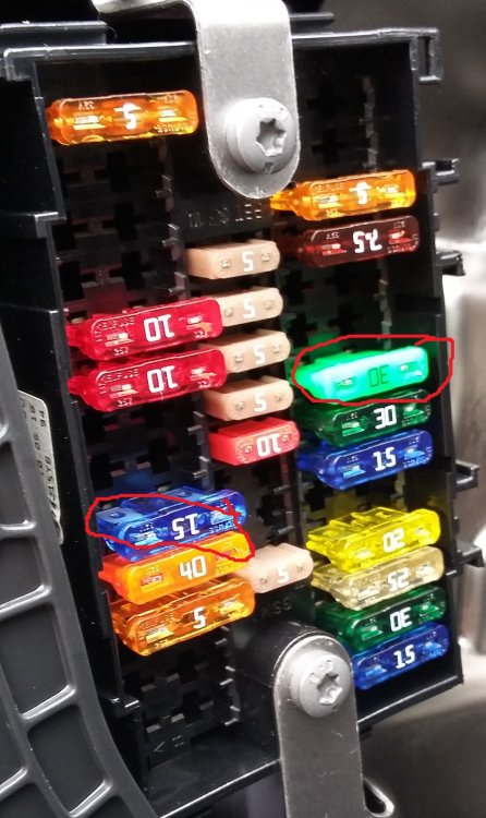

Most would use a piggyback fuse on the ignition switched live for the rear wiper in the fuse box.
It's very straightforward.
As Urrell has suggested, piggyback the rear wiper fuse for the switched live.
Nearby, you will find a bolt that can be utilised to provide earth.
Run the dashcam supply wire behind the rubber door seal up to the headlining.
Then run the wire behind the headlining across to the dashcam.
Mine is a BlackVue DR380G-HD, which fits behind the rear view mirror and cannot be seen from the driver's seat.
I have not fitted a camera to the rear window, but I believe a switched live can be taken from the rear wiper motor.

Just done mine using a Nexbase 312Gw took about 30 mins. Next base is a very good dash cam with a great mount and hard wire kit to piggy back in the fuse box. I've fitted in a few different cars and the yeti is the easiest because the fuse box is so close. Mount as stated in the other replies. If you don't fancy doing it yourself Halfords will fit it cheaply while you wait.
Which fuse board do you use the one in the dash or the engine compartment?
The one in the dash.
See Urrell's excellent diagram of the fuse board layout in this thread:
Sorry for my ignorance but what exactly do you mean by piggyback?
Ok I've found them on Amazon its just a double socket that fits in a single fuse (rear wiper socket) to provide another fuse for the dash cam.
