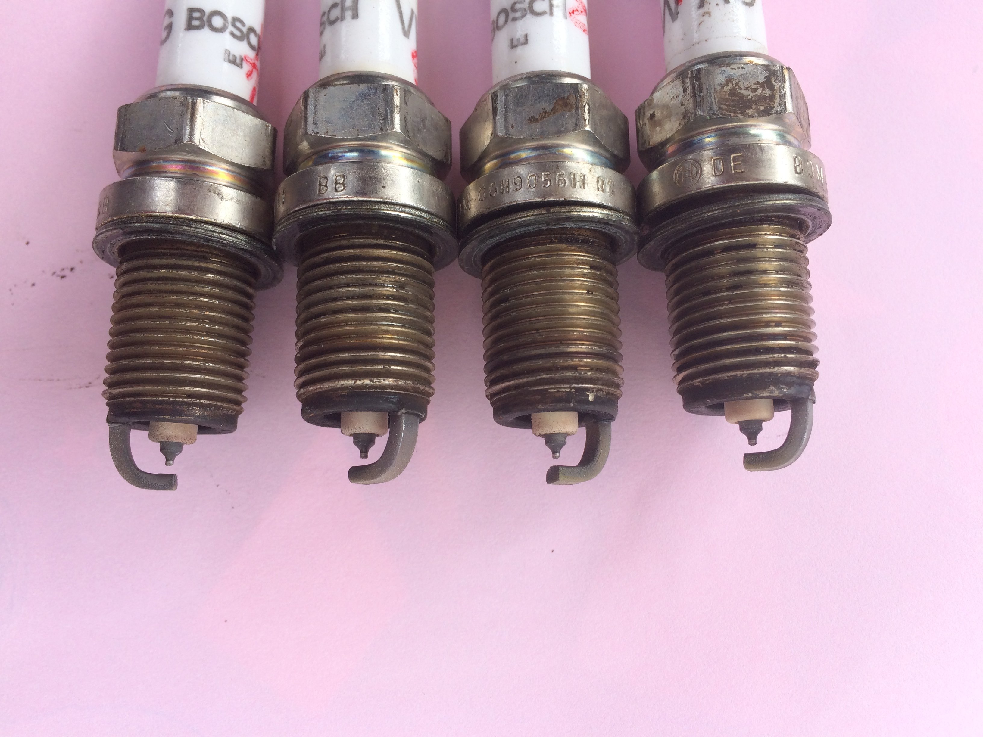

Tried engine running and disconnected coil packs one at a time. All of them had a visible effect to the running of the engine. Included an example of the spark plugs
Not bad looking if all 4 are the same.
Looks like wear on the tip, so check the gap and see what all 4 are.
New spark plugs might well be an idea since you went to the expense of remapping it.

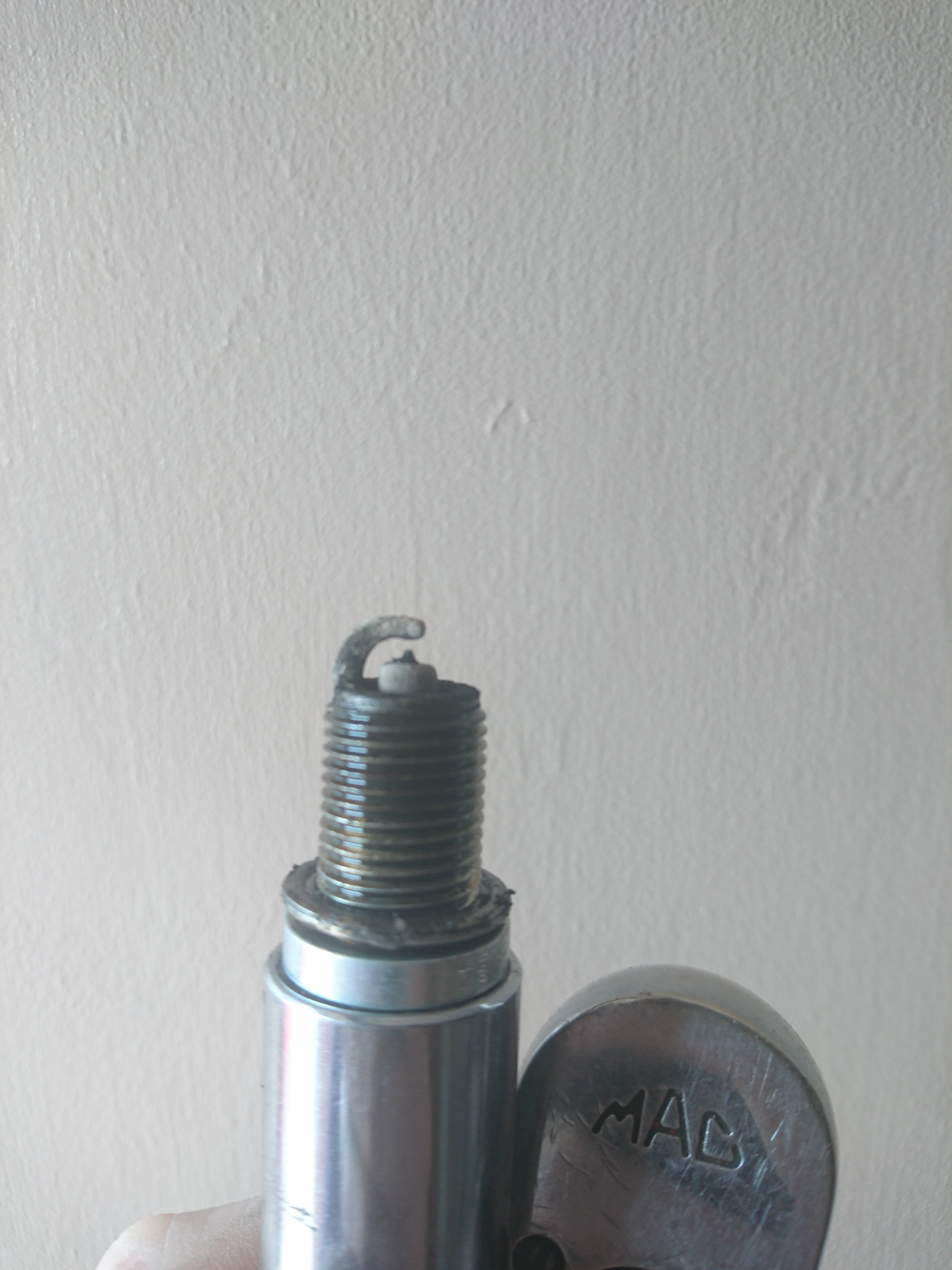

I included this picture as it seems to be the worst one of the four. I'll just pop round Halfords and change them anyway and hope for the best. What should the gap be?

Genuine or even OEM specific fitment should be pregapped 0.6 or 0.7mm depending on who you listen to.
The one picture posted looks quite oily on the thread and some carbon build up around the eletrode.  Although a bit hard to say as it doesn't show detail that well and no benchmark against the others. Gut feel is I'm not sure about 12k miles so probably change.

Also, it is possible, the car is using oil, which will be a problem if it is being burnt. The only plug photo had some deposits and appeared a little oily, but didn't look bad bad. It wasn't the best photo for examination though.
I suggest you monitor oil level over set mileage, like 600 miles or more to make sure you don't have problem.

If you pull all the plugs and take photos, especially around the business end of the plug, it may provide some more insight.  How much oil went in and over what distance?

If you've got all the plugs out. Take good photos of all the old ones together on a bench with light background and post.
