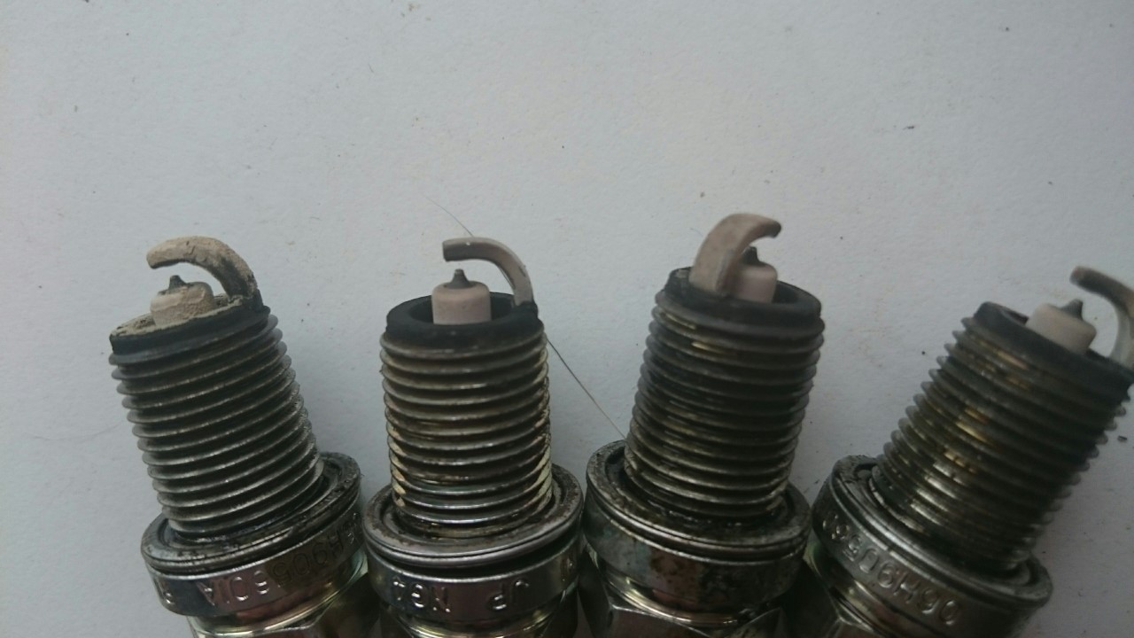

Photo needs to mostly show the electrode end of the plugs. So angle from the tip of the plugs and doesn't really have to show anything past the thread. Look at the photo I put up previously for reference.

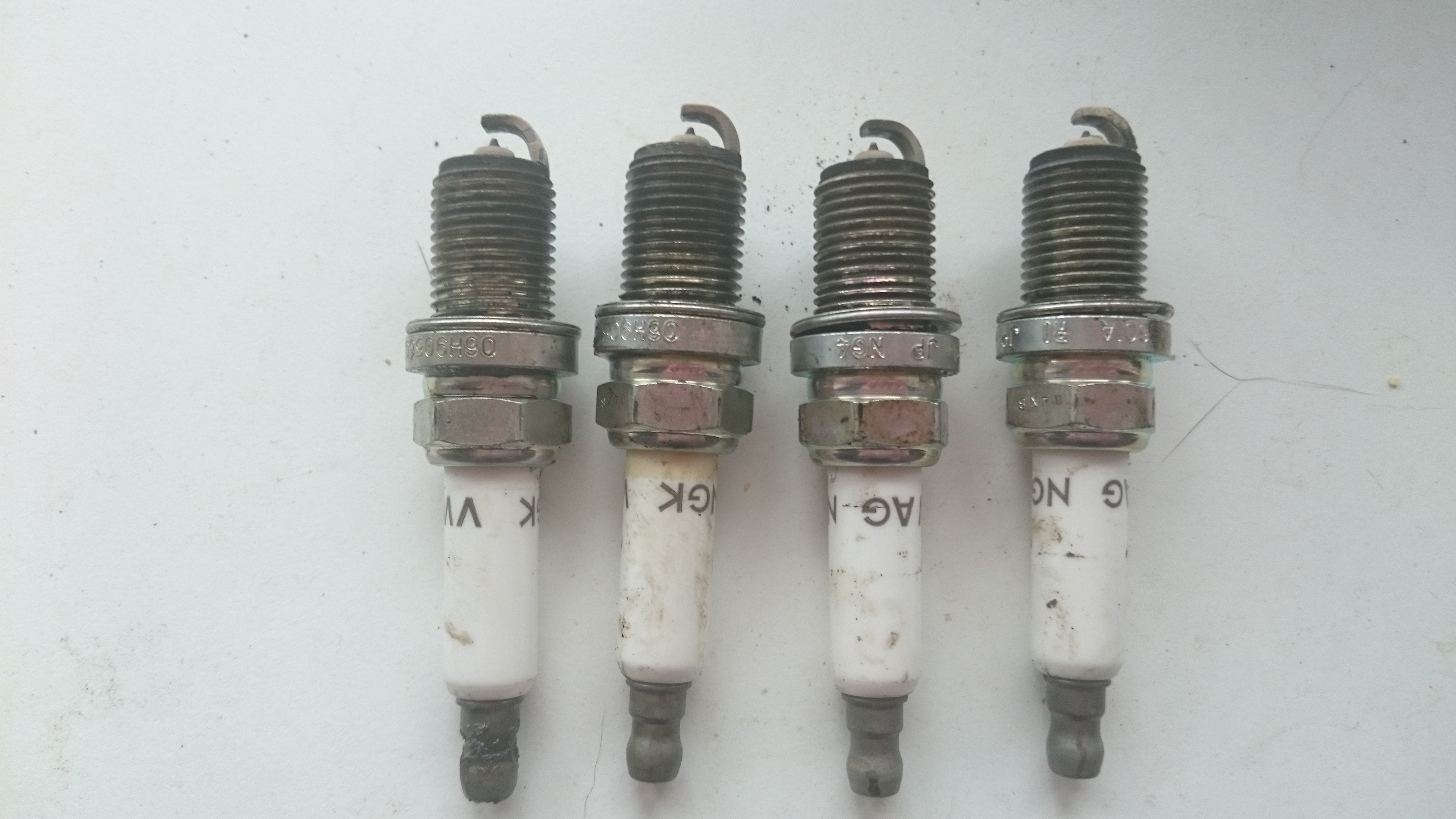

is that better?
First one from the left seems to have too much deposits. Second bad one looks the first one from the right.
Hard to add anything else, now is important to know the oil usage, keep an eye on it.

Yes, better photo. Like rayx says, far left has a lot of build up and appears significantly  different from others. The remainder don't appear to tell much of a story.
