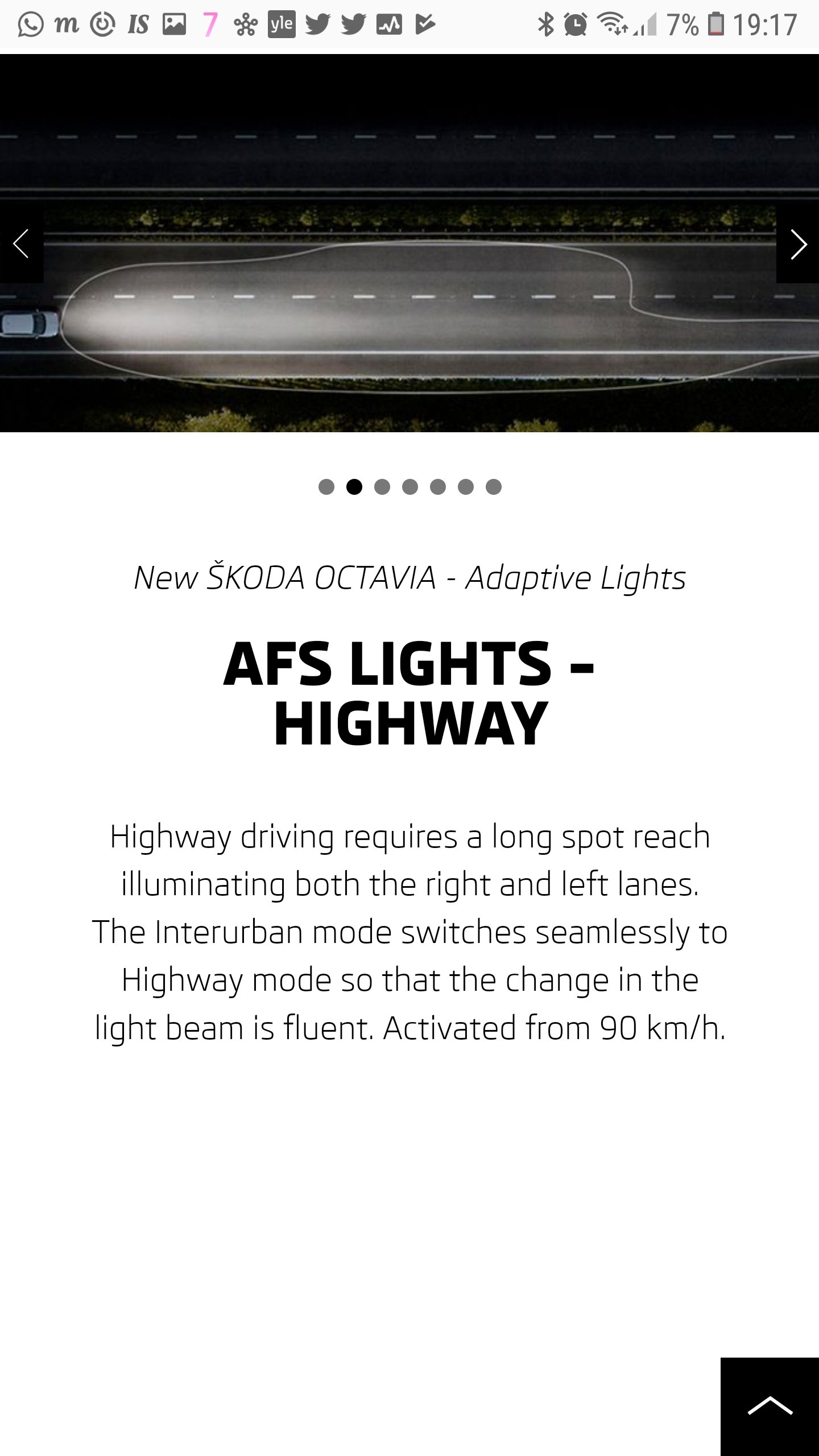

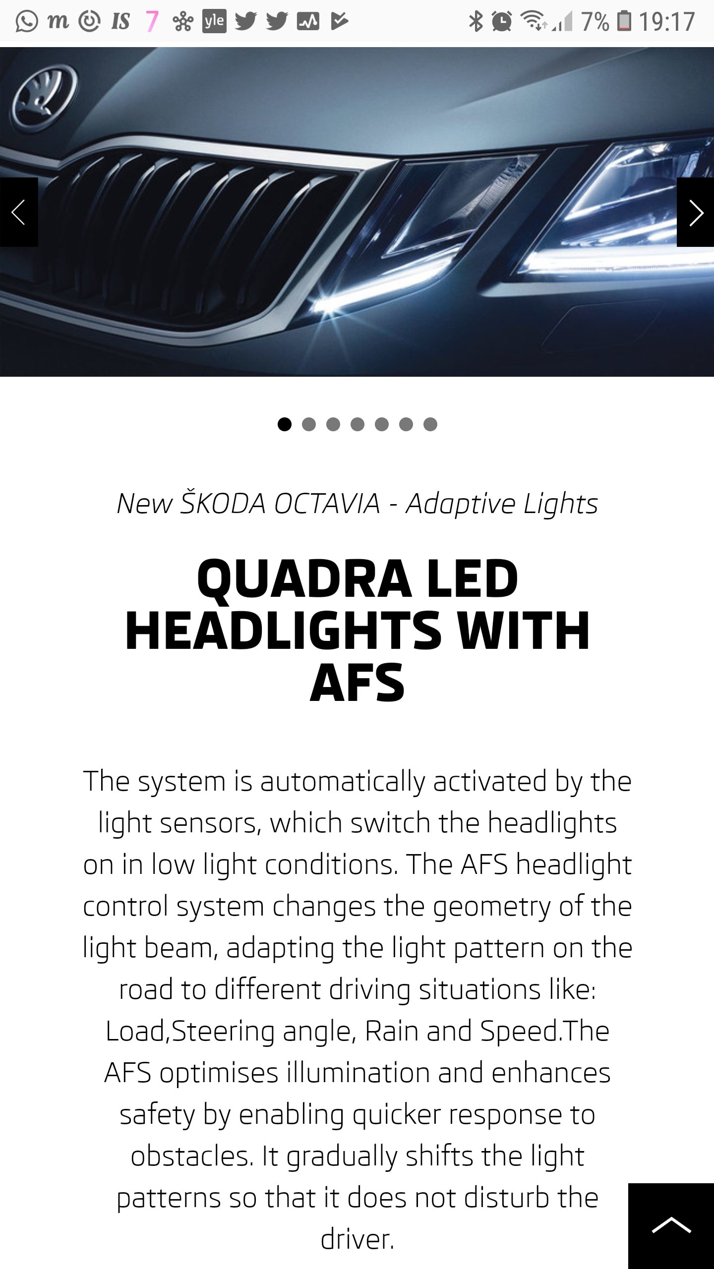

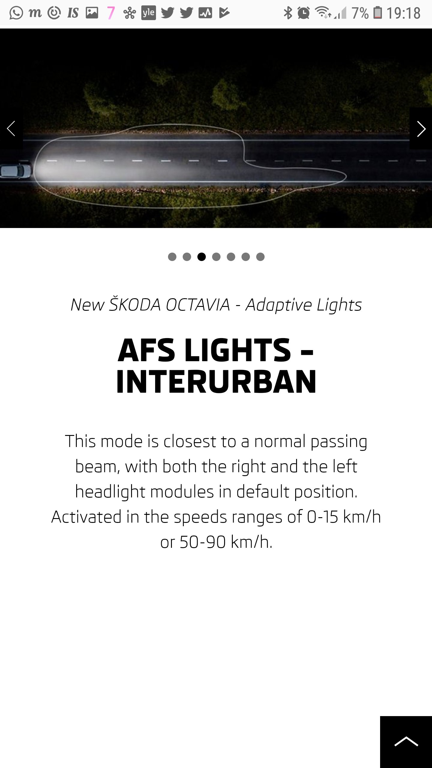

I took these screenshots in Feb 2019.
The LED headlights are projecting just as far up the road than the halogens (and to a lesser extent xenon), but as mentioned LED has a very sharp cut-off i.e. perfect light output on one side of the imaginary line and pitch black darkness on the other.
With halogens there was a lot more light bleed over the line, so they probably did offer a little more visibility at the extremes of the beams reach.
There are lots of advantages of LED, but some disadvantages too.
Please don't manually adjust them higher, you'll likely dazzle other road users.

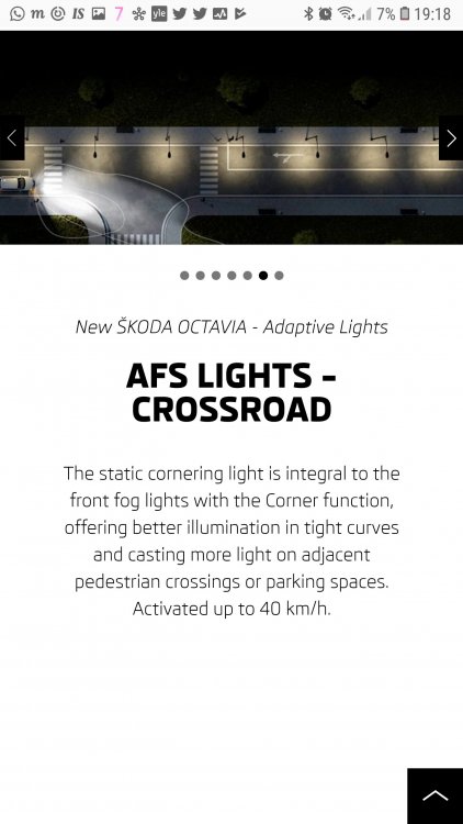

Oh yeah I found on anohther thread that the highway mode actually increases gradually from 90 - 120 kmh. This could possibly be so gradual, that I wouldn't have noticed it between 90-105 kmh which I was driving.
As the so called "Highway mode" is presumably legal, it should be considered the standard position, which means that below 56 mph you are getting reduced range. On rural British roads you need maximum range down to at least 40 mph. It should switch to highway mode at 60 km/h, not 90!
That seems a better idea if adjusting the low beam up would rise all other modes up too that would be bad, but maybe just bringing the highway mode speed treshold down like @Rodge  suggests would be a good solution. Could that possibly be changed with the vcds? And could the beam still lift gradually depending on speed?
