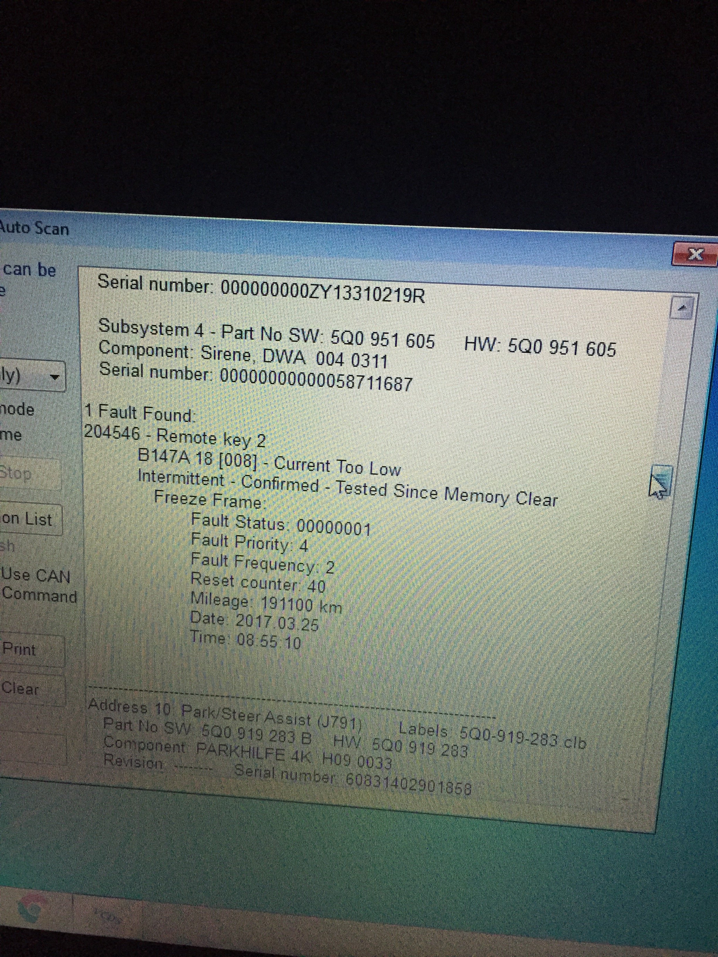

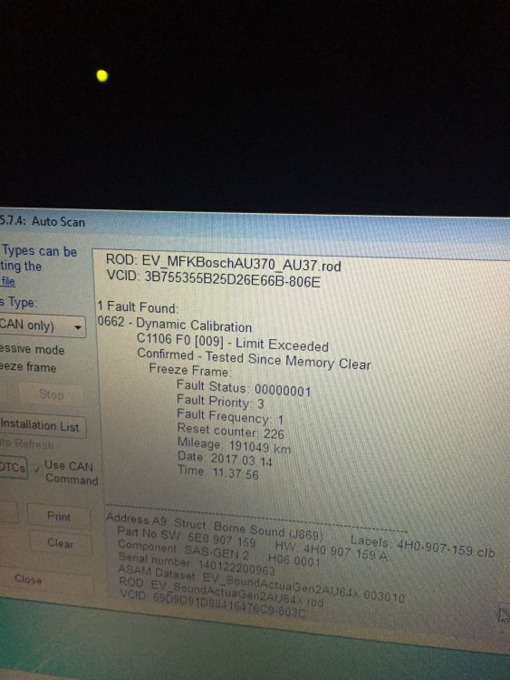

I know a vehicle tech who has the VCDS so, a check was carried out with the faults highlighted below.
A reset was carried out and the engine management light came off, HOWEVER, driving this morning, it came back on, and mor worryingly, whilst driving, what can only be described as a hail hitting windscreen noise arose (to the point where I was looking for imaginary hailstones) then the engine overheating light came on, temp rose, then dropped back to normal within seconds.

Excuse my ignorance, but the water pump issues are related to the "overheating" and not the engine management light/ lambda sensor vcds read out?!
correct, the water pump issue starts with the temperature gauge "sticking" rising very high then back to normal.
After a while it gets worse & you will get a "stop engine now" message as the coolant stays too high.
Your MIL light is caused because the Lambda sensor is open circuit according to the VCDS readout.
This should be a separate issue.
