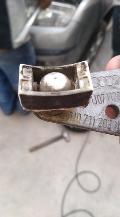

Possibly this.... Or something similar.
I laughed at the cardboard shim until I saw where he placed it.
If the fabia is the same set up then that looks like a good easy fix
I think an appeal is in order then...
Has anyone out there performed this or similar on their shifters?
On a Fabia...
Doesn't show the shimming but shows the plastic ball, rubber/plastic socket and the metal top bracket.
i.e. Looks the same to me.
Take the gearstick surround off for a better look. I was going to add that there is a pictorial guide but due to a combination of age/entropy and bl**dy photobucket, there aren't (piccies).
If anything else is wrong this mod won't fix it. It's not exactly expensive though. Just make sure not to drop the torx screws down into the mech. :)

Holy thread revival. Yes it does work. Worked well on mine anyway.
Plenty of things get worn. My cable ends are on their last legs, slider is pretty much nonexistent. The bad thing is that most upgrades (soild bushes, cable ends, brass sliders, short throw shifters, etc) are for 02Q, 02J and 02M transmissions, 6 speed transmissions and little else. Not much for my little close ratio HZK 02T gearbox.
Make sure to keep everything clean and well greased. Made a world of difference, though I'll have to address the worn stuff sooner than later.
