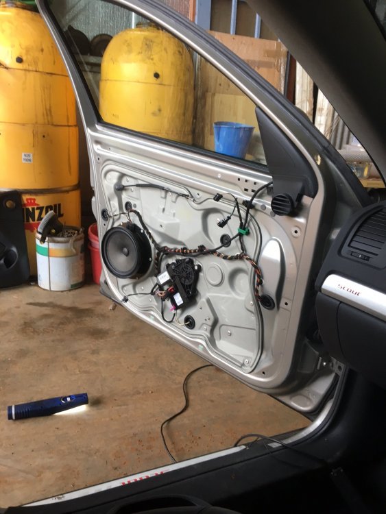

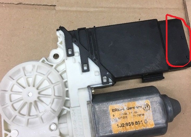

My Mechanic is back from his holidays and his comments are mixed on one hand he says bloody Germans always over engineer and complicate matters (He is German) he thinks the problem is in the door controller, this is a small box attached to the window motor there are 27 wires running through this box and it seems to control everything the two main leads in are showing good connections and there does not appear to be any broken wires or any sign of water ingress, (see picture attached).
I have also attached a photo of what seems to be the problem part, it does have it's own barcode so I am guessing that it should be available as a separate part probably for $20,000 or some such stupid price.

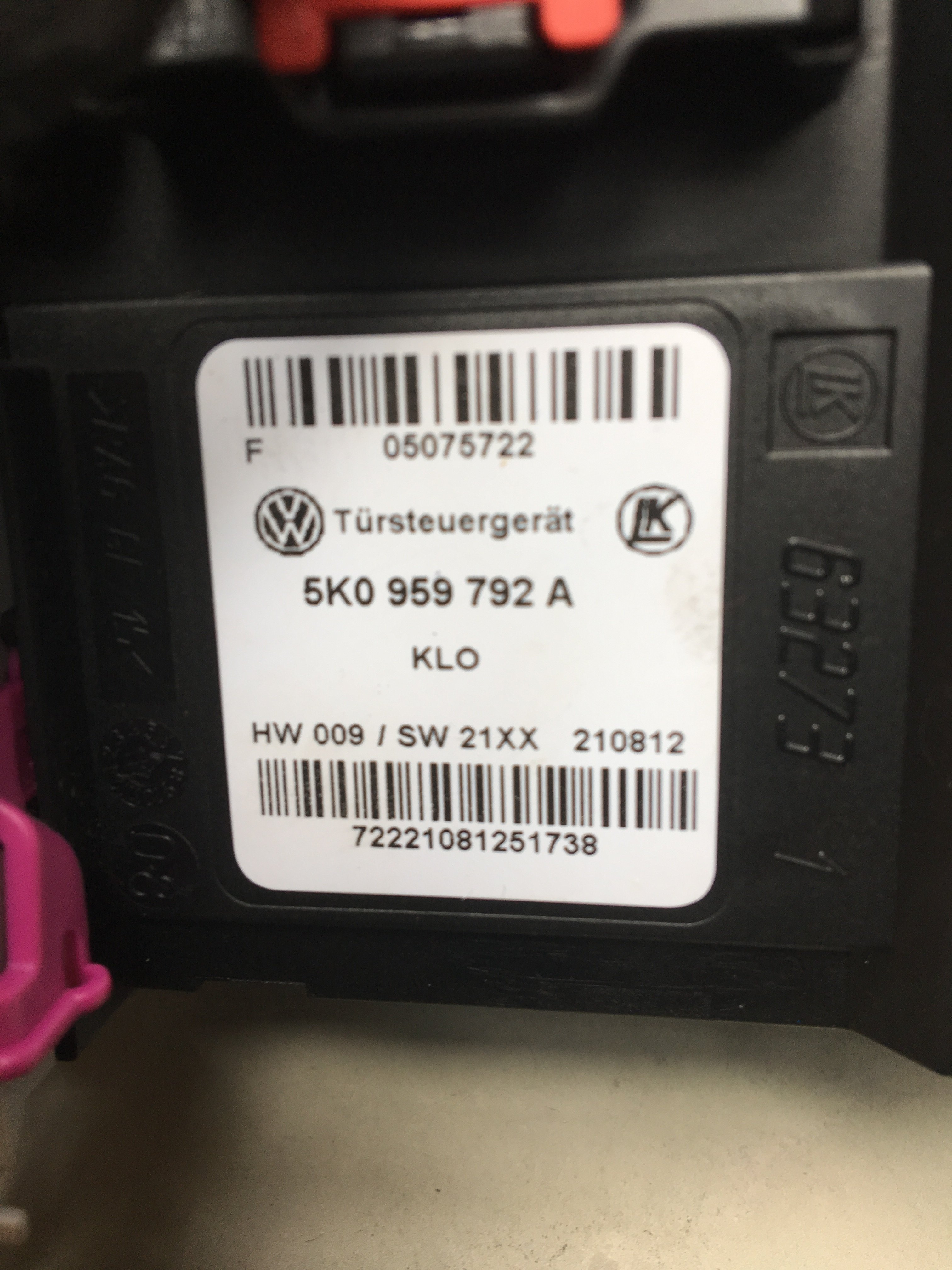

Looking at the picture of the inside of the passenger door there are two white labels attached to the window motor the box in the second picture is the lower of the two labels.  Do you happen to know a Skoda wrecker in the UK that has late model parts?

I may have a spare module from when I upgraded my car. I will have a look for you and report back.
Hope you find the problem. Module could be faulty but do re-check the wiring thoroughly.  It is the most common and likely fault for mirror failing. Window too unless the switch its-self is damaged/corroded. Take both ends of the door bellow (Or snake) And really look at all those little wires and make sure each one passes through and connects. They can snap so close to the door it looks like they pass through.
The mirrors are, if similar to the Fabia, quite simple to take apart so try swapping the duff one for the good one and see if the duff one works in the other side. If it does, the motor is fine. No need to remove again, put the known good one back in the duff ones place. The motors SHOULD be identical.
Usually, you will pop off the plastic trim, pop out the glass and unscrew the motor. Disconnect the wires and do the same to the good one. Take care to use plastic tools to pop the plastics and glass, to prevent cracking it. If the duff motor still doesn't work in the other side, does the good one now work in the duff ones frame? If so, thats one of the problems sourced. Worth re-checking everything else now in case its started to work!
Just checked my old modules and unfortunately the part number is slightly different. Mine is 5K0 959 792
Sorry I couldn't help.

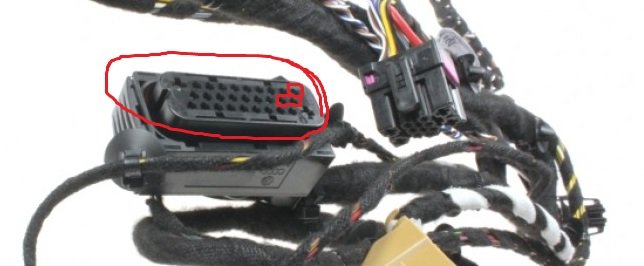

Hi Guys . I really founded The Problem where is it !
First Check The fuse Box m when fuses are ok,
be sure problem with connector motor window . maybe leaked or you have to replaced the Cable !
look the Red Line

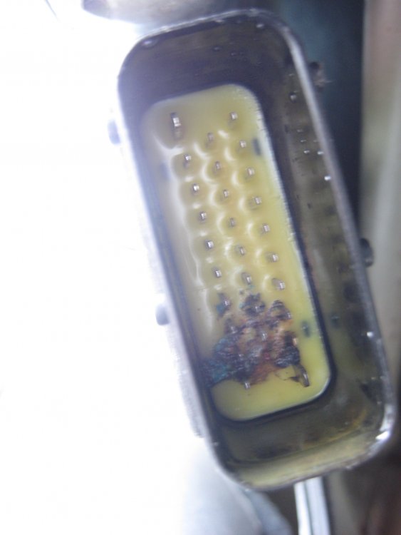

Look at pins on the motor unit too. They may be corroded away.
I thought this problem had been fixed with the different design on the Mk2 to stop water running into the connector.
Here is what happened on my (and many others) Mk1 Octavia
