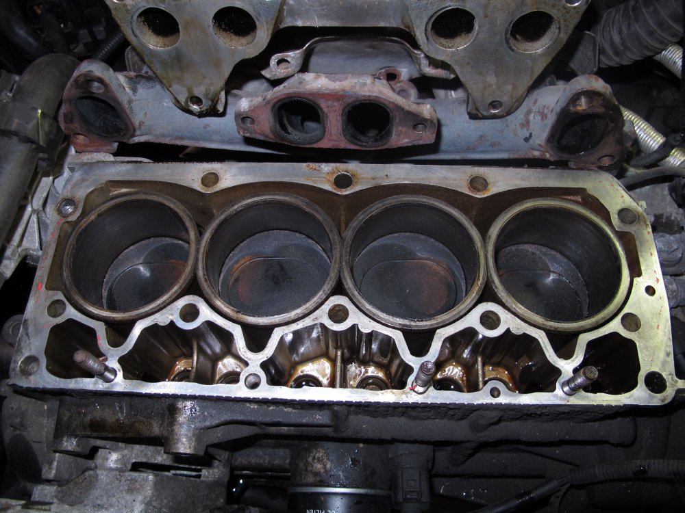

Have read that the head gasket on these are a weakness and took the job. I found out in a bad condition, and it could look like it had leaked both between cylinder two and three and between cooling system and compression room.
When I also found water in the pan I was confident that this should go well. There was also "oil" or mayonnaise in the cooling water reservoir that was not water-based / miscible with water.
Should you have goal HC in the cooling water before I started, all the indications indicated top counts. So was also the case.

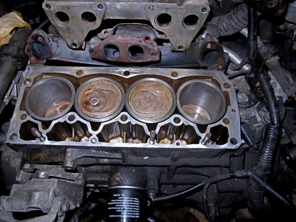

In the process I found some corrosion in cylinder three, but apparently ok.?
Also found that the wet cylinder linings were slightly moving (be careful), but they thought they were clamped in place with a new cover.
A little scared that the paneling below the cylinders has a bit of leakage?
Took a small cushion on the valves, but they looked nice .... The top cover became the planet on sandboard, something that has always worked.

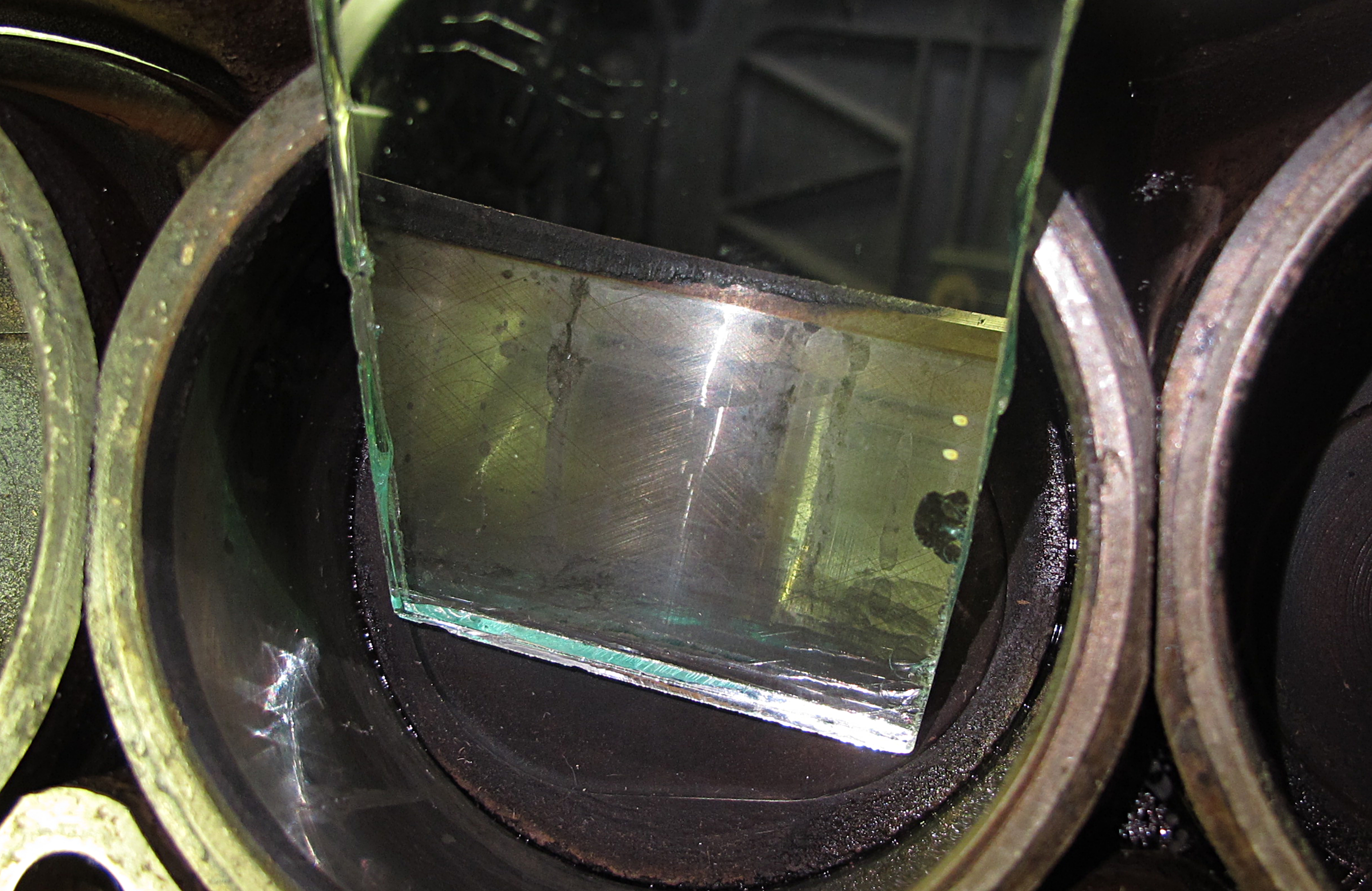

The top cover looked very good and was only slightly bent, approx. 0.05 mm.

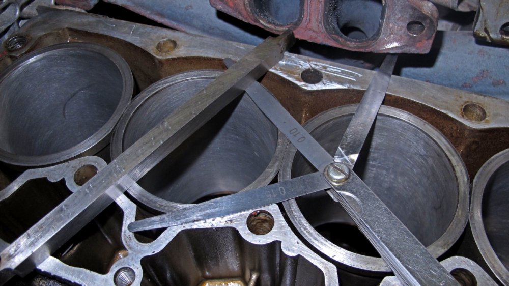

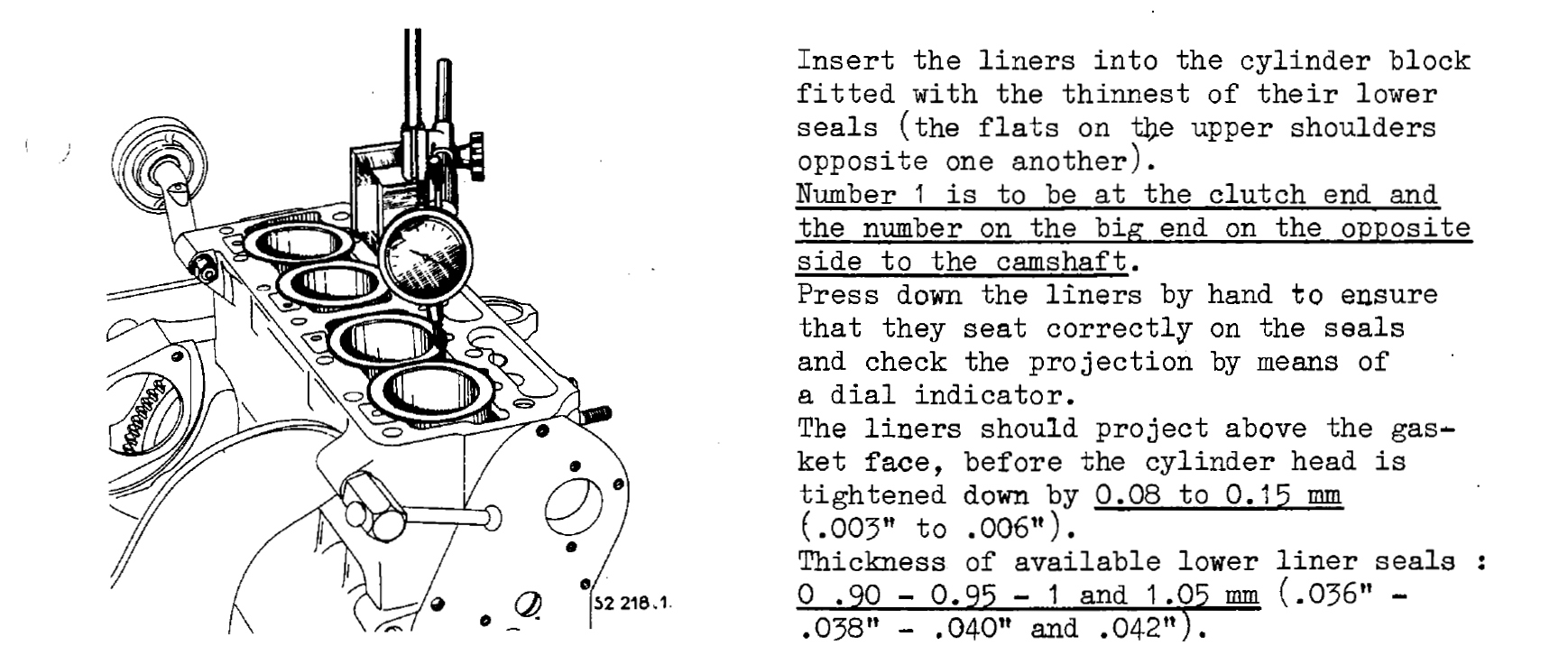

I will change the piston ring and hone. And the copper-rings (sealers) under the cylinders. There is tree size, and i bought all to get there right hight on top.
Measuring first measuring the shim old shim, and then 0,05 extra . I think that will be ok?
The cylinders shall be about 0,1 mm over the engine block?
I most look in the spesifications...
New liners shall bee good!
(but first off all I must have some service on my body and head)
Edited by Torbo
0.07...0.12 mm
Edited by TMB
I think an engineers square and some feeler gauges  will work just fine and 0.1mm sounds about perfect.

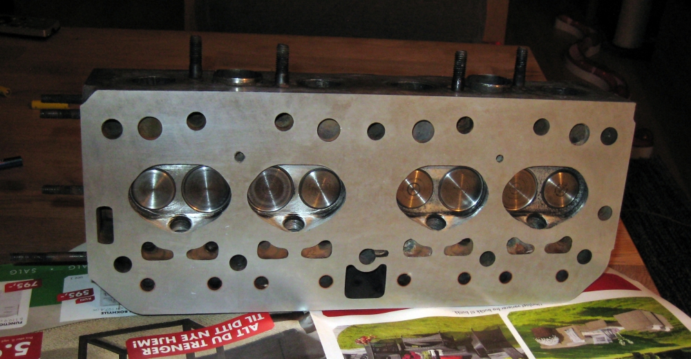

Her is my cylinder head (Gordini) fresched up and 1 mm cutting off, for more compression.
