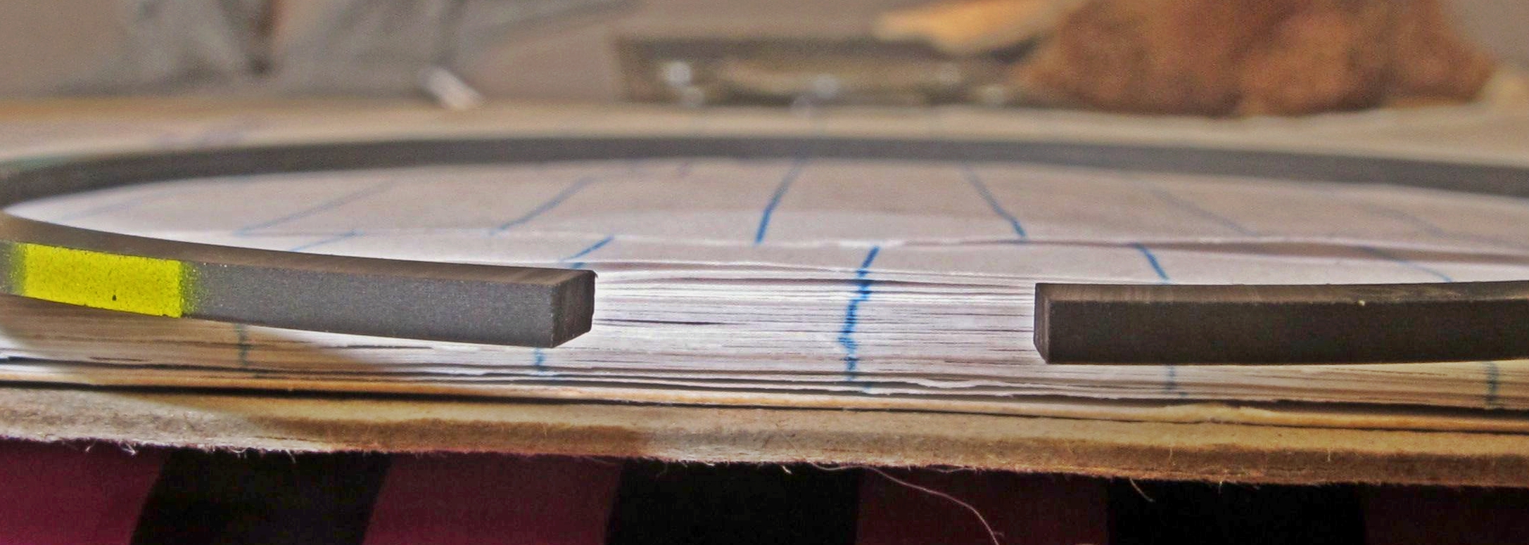

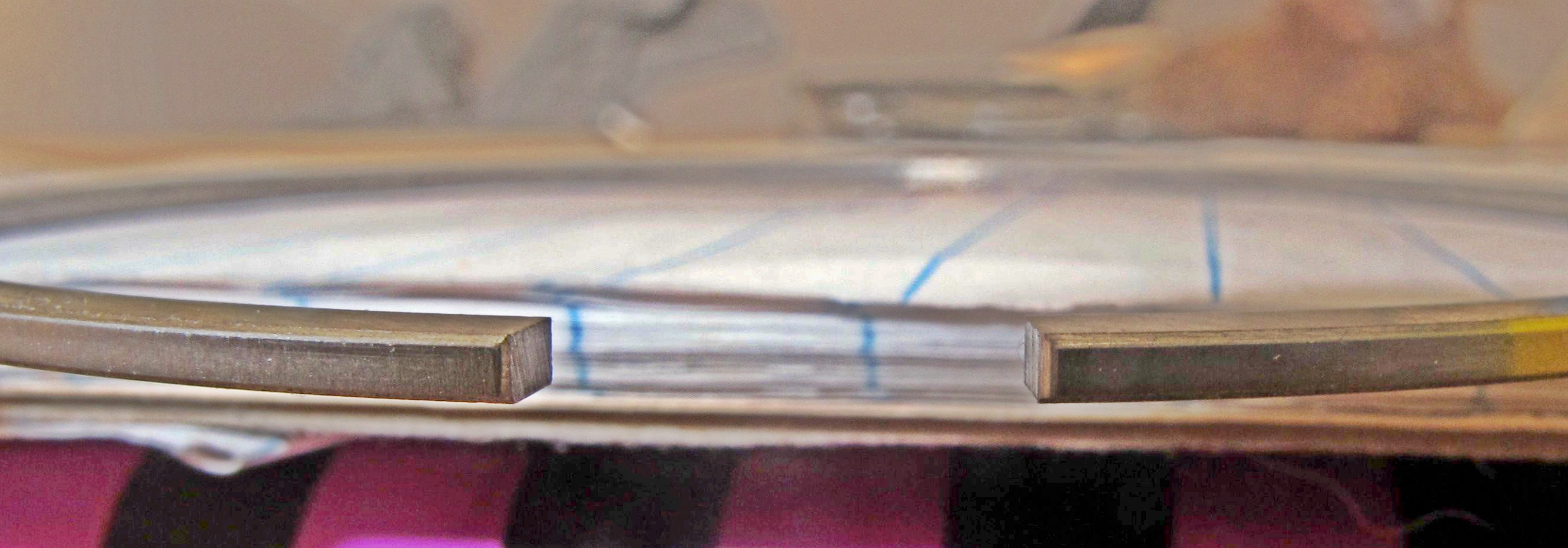

I got some piston rings to day. One "crome", one black and tree oil rings.
Should I install the chrome ring at the top of the piston? There is no TOP-marking on it...
The black ring is marked TOP, som thats normal..

I would install the chrome ring as the middle and the black as the top ring, a chrome ring will not bed in as quickly as a plain ring and the cylinder will leak compression badly otherwise.
I'm not saying that's the case, it's just what I would logically do.
I hav thought the same. But I think the chrome ring shall be in top to endure more heat from burning.
Other engines has the chrome on top, but the black casting ring can give faster adaptation.
I have to think twice here...
some picture of the new piston rings: - The ends to see the difference
Dude, that plated ring is not Chrome, it's a PVD coated steel ring and it's definitely the top ring because it's much more expensive than the black plain cast Iron ring. It has no markings because it's symmetrical and can be fitted either way round.

Thanks! It look like a top ring to me to. The black ring has top marking. Hope I can fix the engine next weekend. No I have some other health challenges... Hope the service on me is ok/repaired wednesday !?

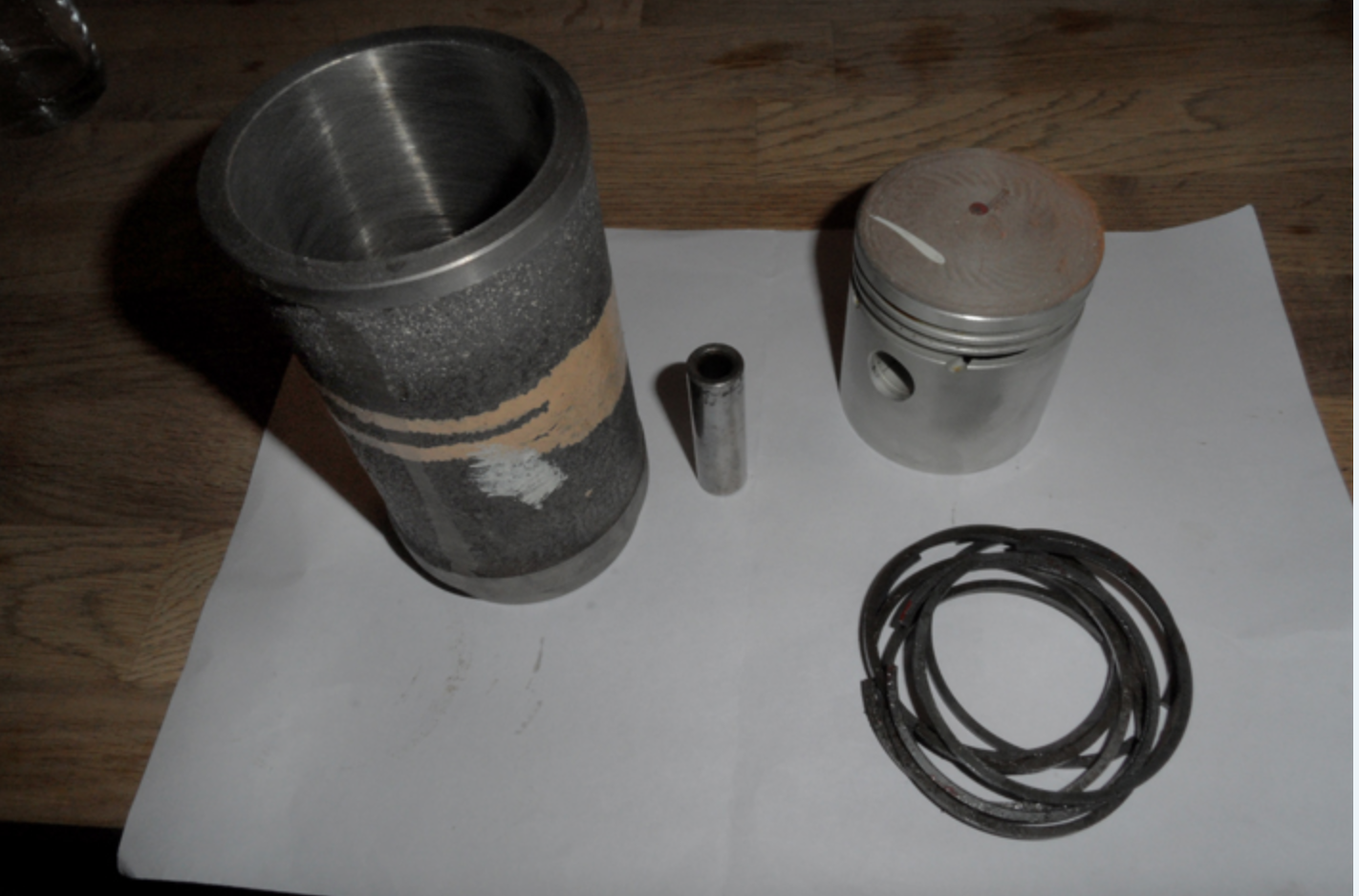

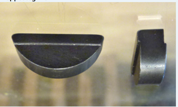

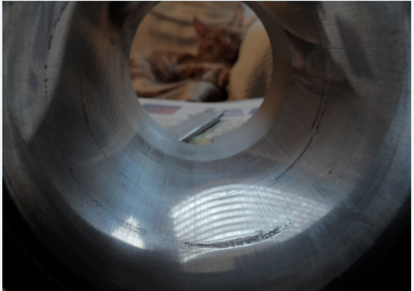

A little break. Her is my new cylinders and pistons to mine Dauphine.  And one of my old with bad surface and my cat... Have not got the Fabia-sylinders yet. If I get time I will put in a wedge to forward the cam 3 degrees to get more torque in low rpm. ?
