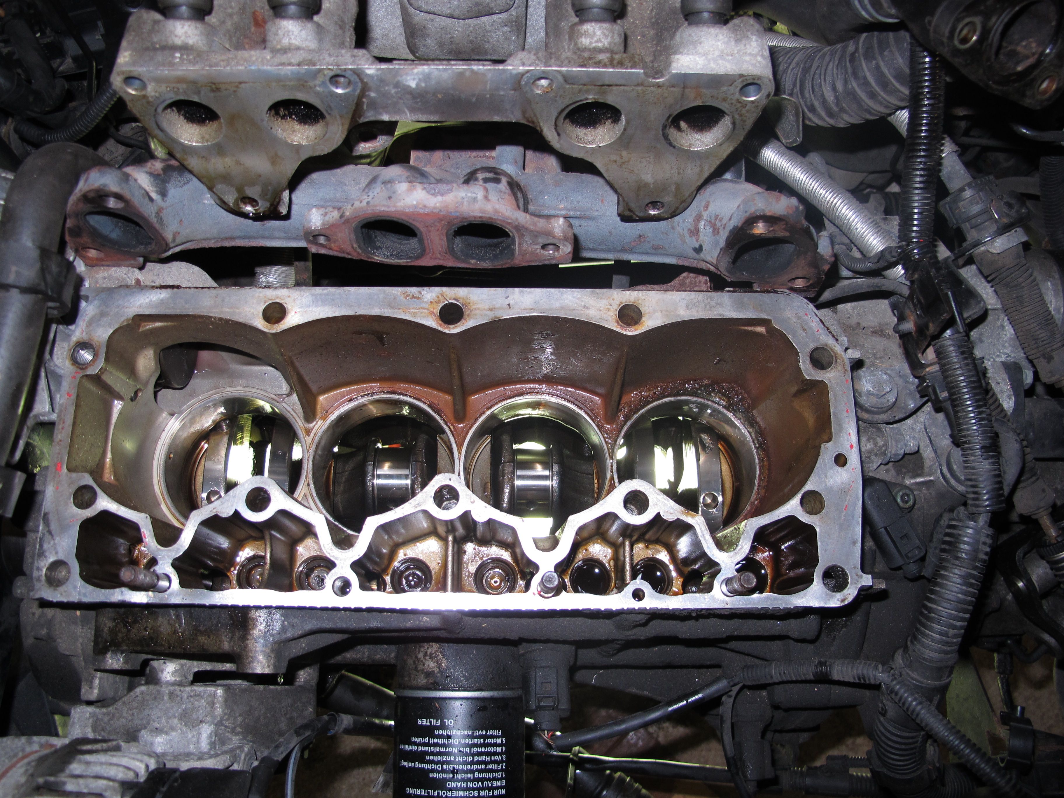

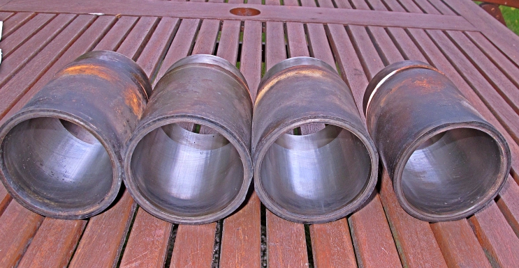

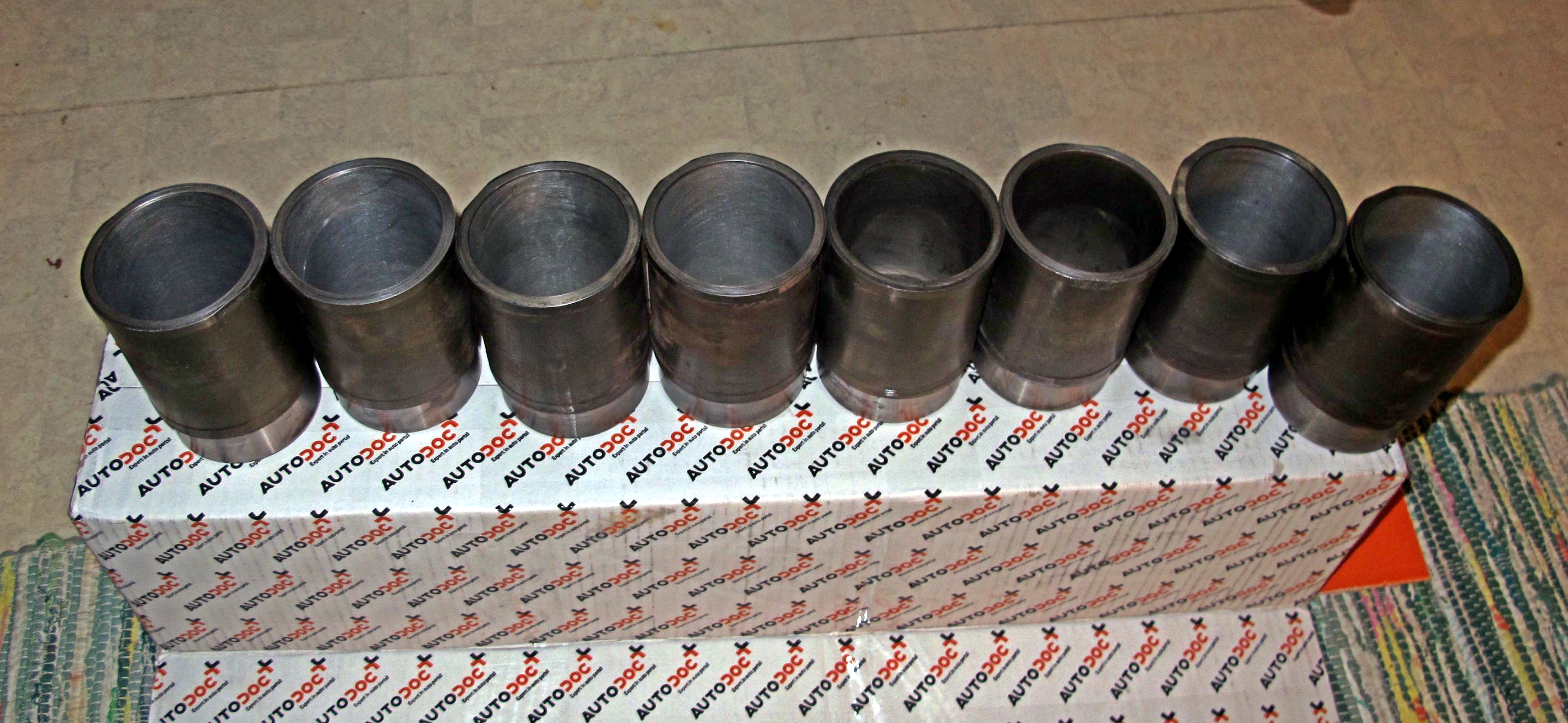

Then I got four nice cylinders. I will hone them tomorrow. New piston rings and new copper gaskes/ring in the bottom.
59c4182a5c3cf_nysylinder2IMG_7391lll.jpg.2765fce0df81ffb242406dc881339ab9.jpg59c4182956018_nyesylindreskodaIMG_7389ll.jpg.fac8f38b53831f5465c823b7e834a40a.jpg
The first thing to do is tapping oil, and stydy it. Water in oil?

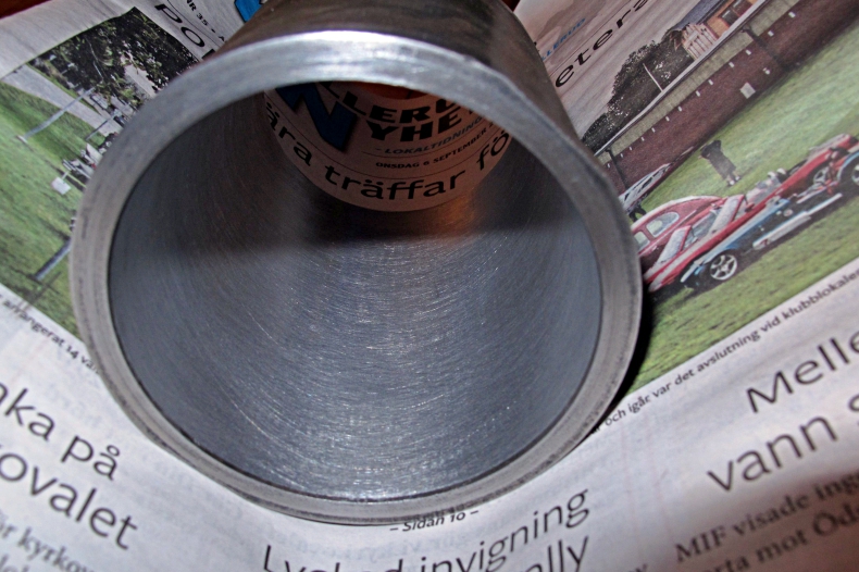

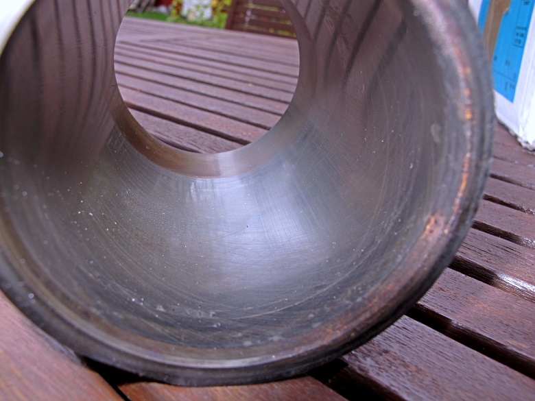

A little honing:
^ Looking good :thumbup:

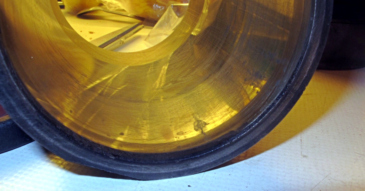

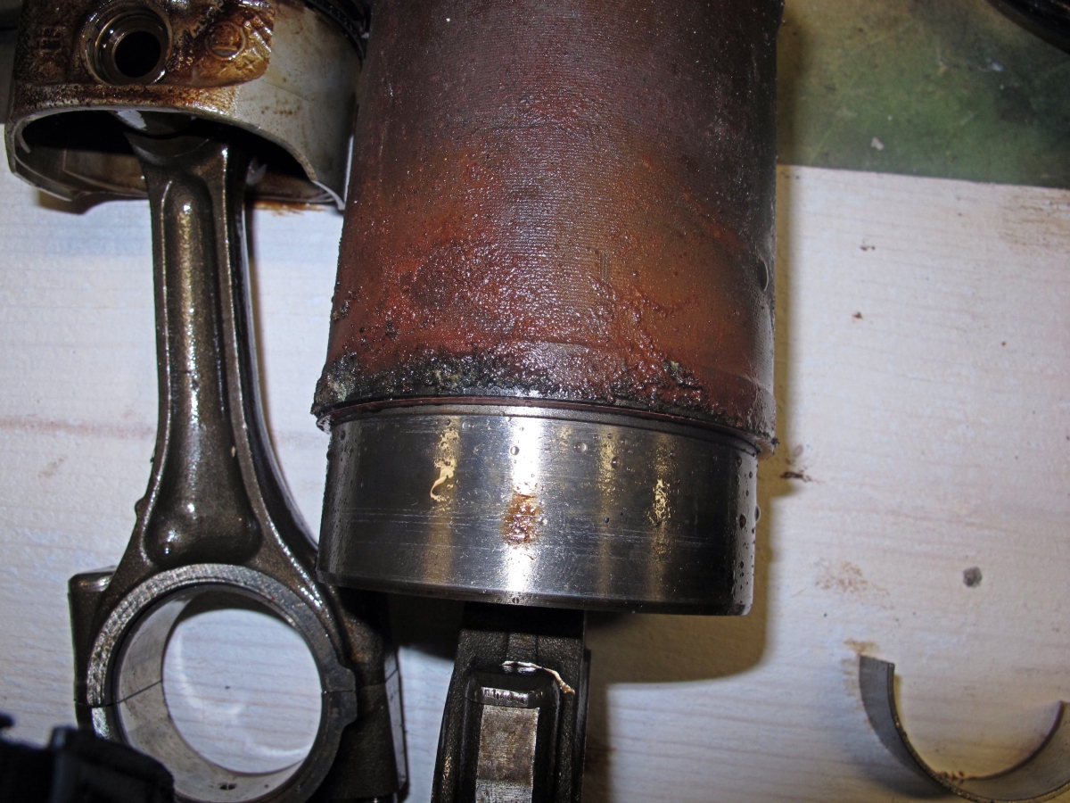

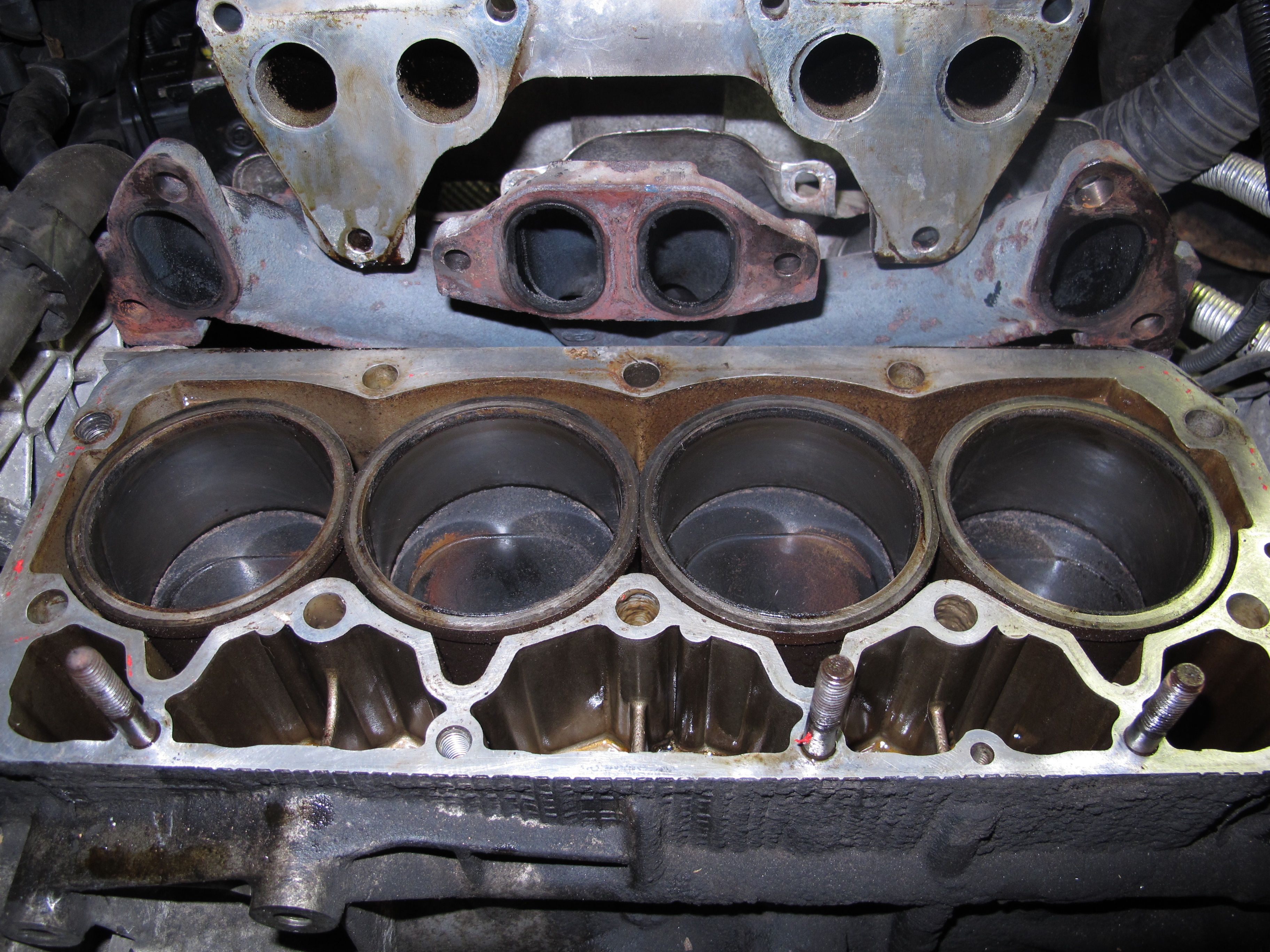

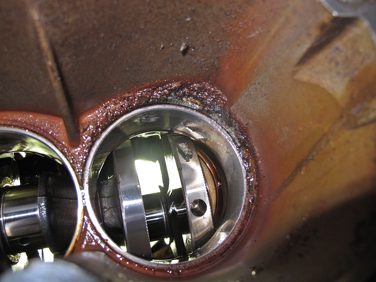

To day the cylinders came out. A little surprise: The cylinder number 4 was very rusty along the bottom - beside the sealer ring.
The crack in the first photo looks better now in other lights. May be not the main problem – not problem at all? Only a mark in the inside, and the top of the cylinders is very strong, no mark outside... So the cylinders should ben taken out when I changed the top gasket. I most adjust the hight perfect before I put the piston in. Messure first without sealer in bottom, and then put the right sealers on. The pistons was good, but they will get some new rings. And I will not use the same gasket - naturally.. When I was under the car I saw a rusty metal tube i the right side of the car. May be to se servo steering? The steering oil is falls on the container under the battery.

No the engine is going good! I will drive it various, hard an light. And get it breaking in with mineral oil - about 2000 km.

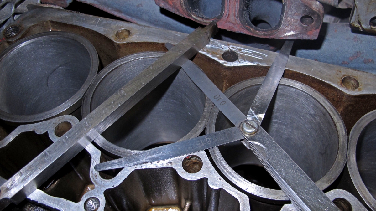

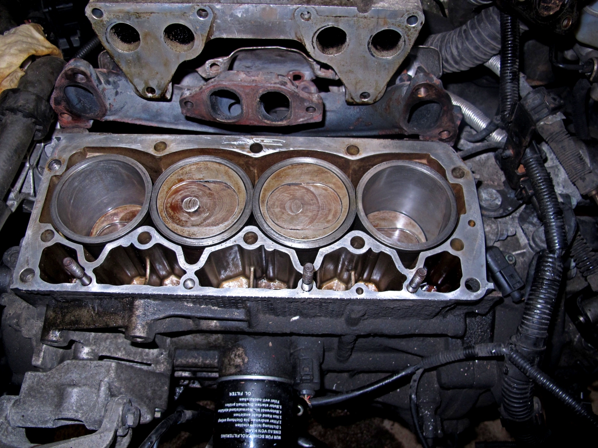

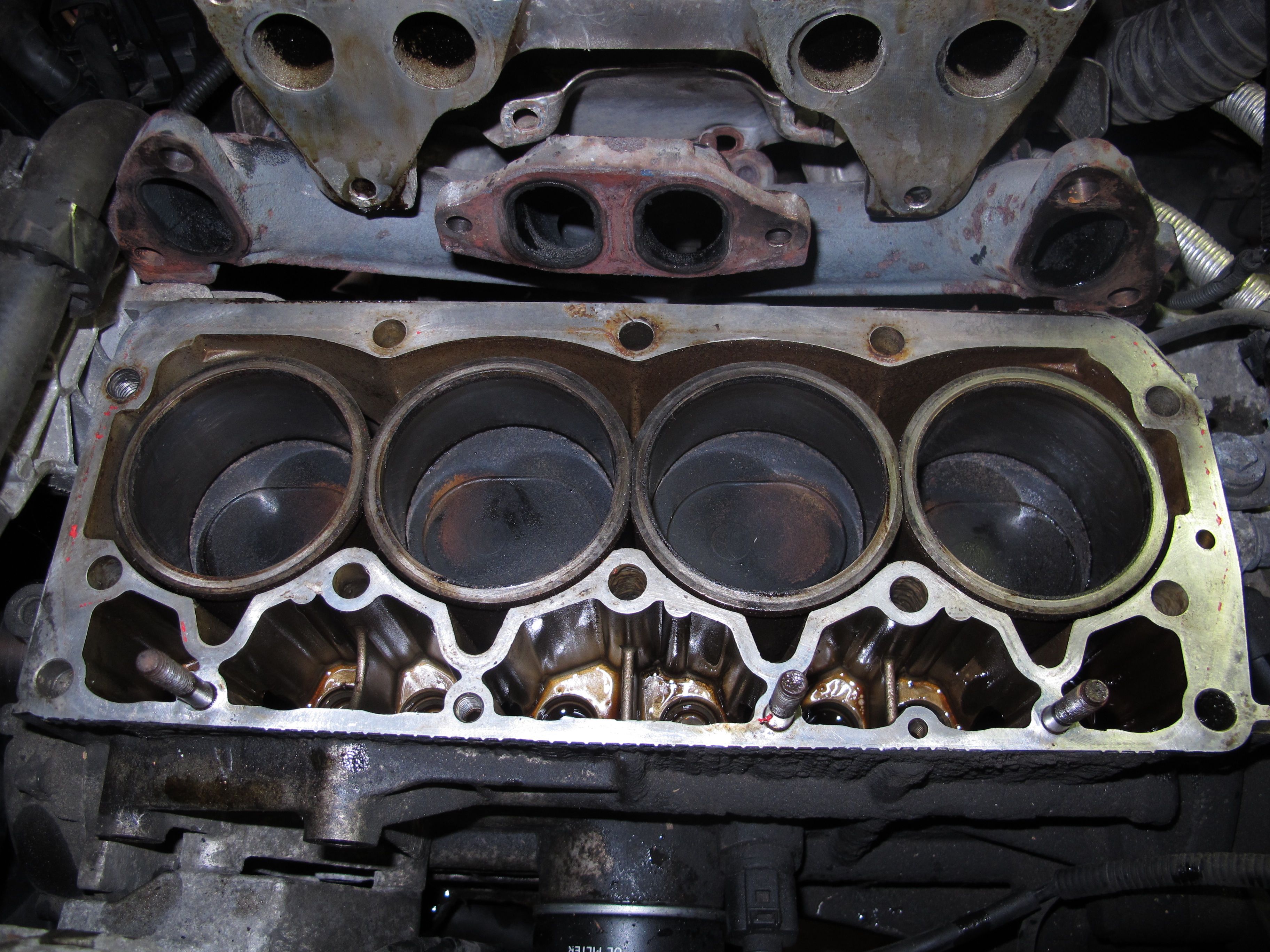

I had to adjust the cylinder high with 0,05 to 0,10 mm to get them 0,15 mm over the engine top. First I measured without copper rings. Put the rings on and measured again and fine adjust to 0,10 - 0,15 mm over block. Before and after pictures under... Honed cylinders and new piston rings.
