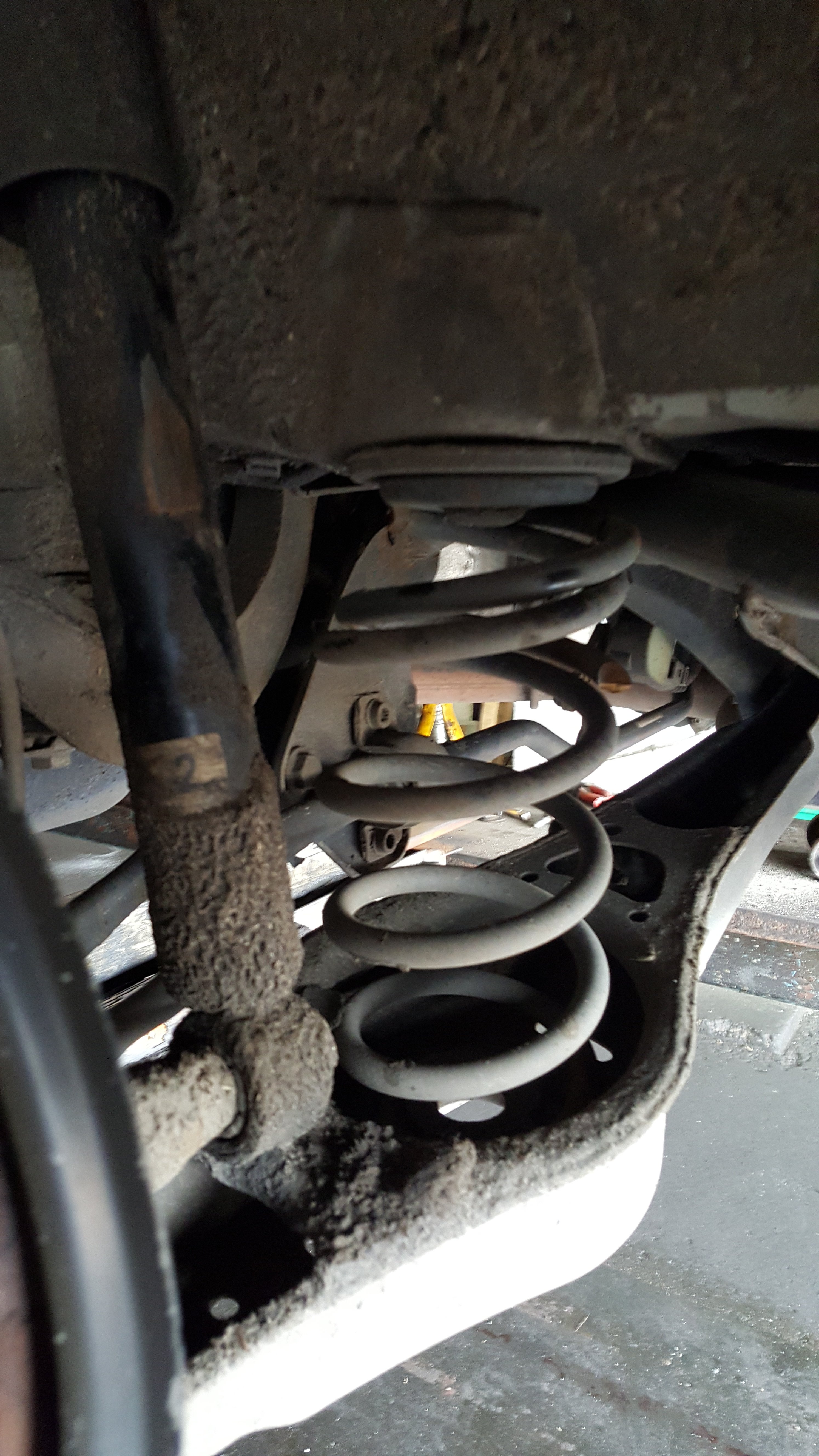

You mean springs like these, nsr spring broke after damper failed (never knew damper was leaking)
Sort of,
I really meant the springs could be a bit stiffer/thicker - although they would be less fragile
On a Passat (II) in the past the Estate springs made the saloon springs look like they should have been fitted to a pen! On the Superb I think the spring are the same for both. Are there any coil or gas spring  assisted shocks available? I fitted something like this to my dads Volvo estate a few years ago - you had a pressure gauge in the boot where you could set the height with a tyre inflator pump
Saying that when unladen the ride is pretty good  - although my Superb I was better , but rolled a bir around corners
Actually your photo shows the issue (ignoring the broken spring!) -  You can see where the suspension pivots further inboard on the car. Basically  the wheel would be at a very different angle between the top and bottom of the suspension travel
Edited by bigjohn

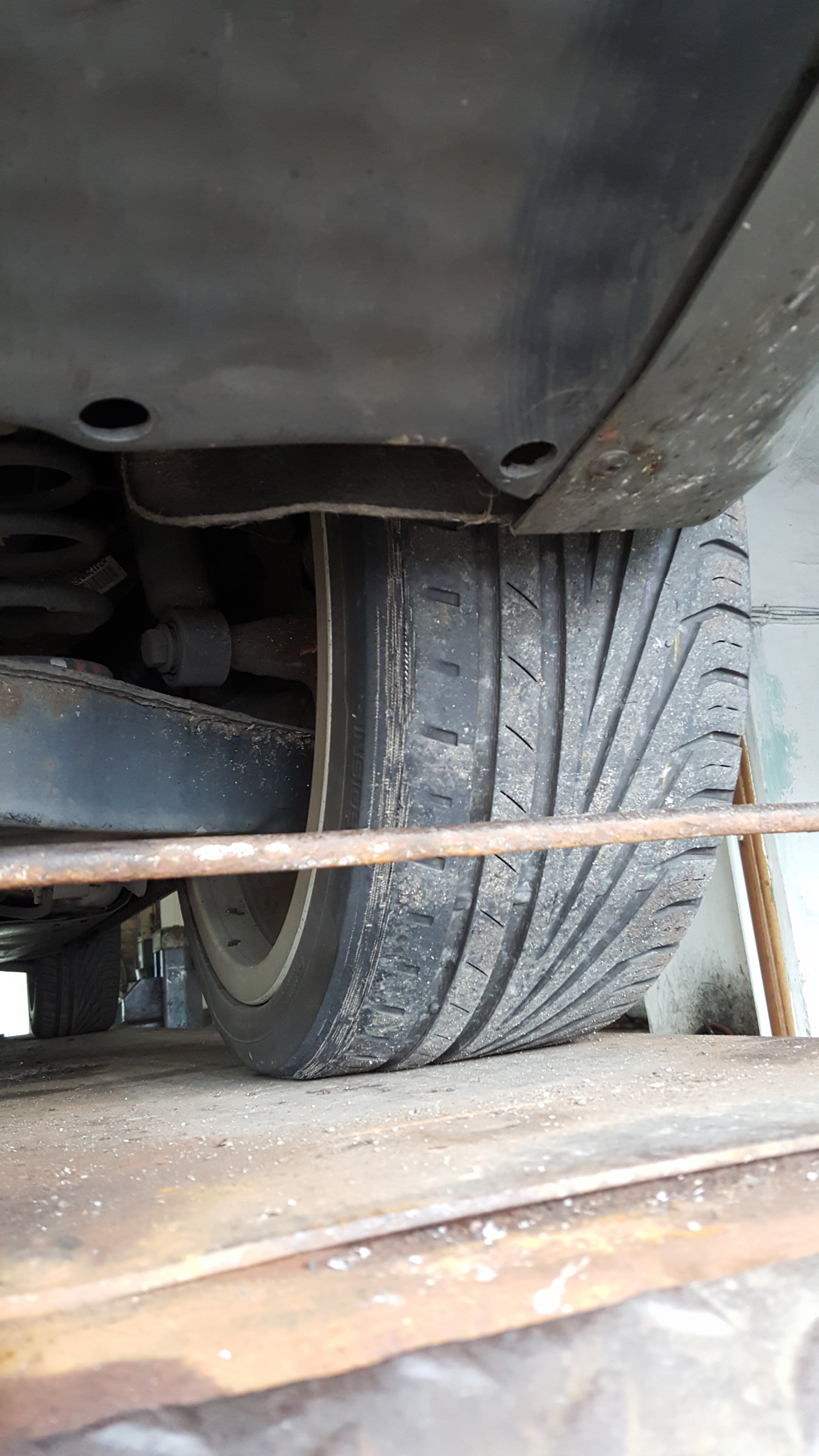

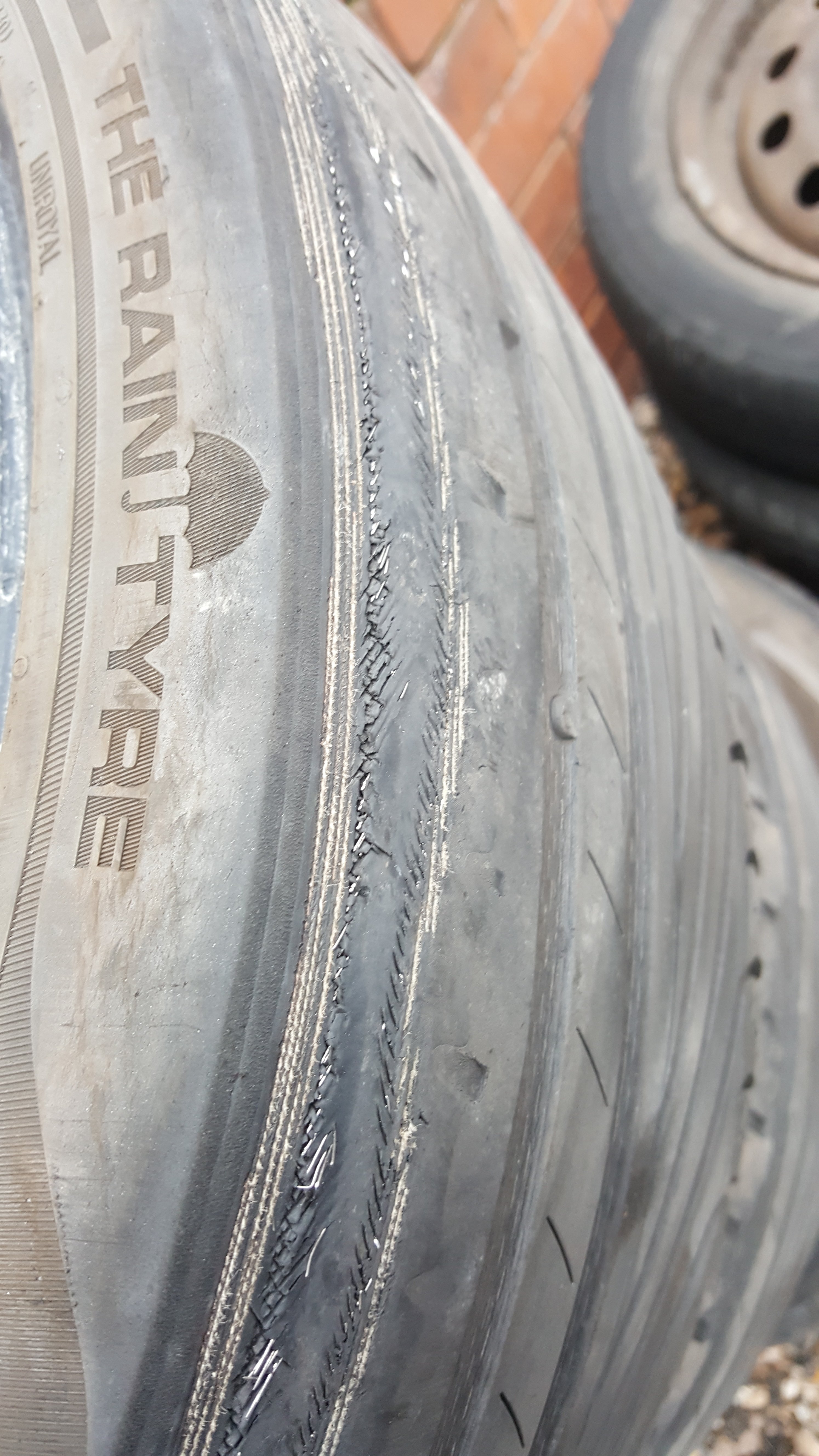

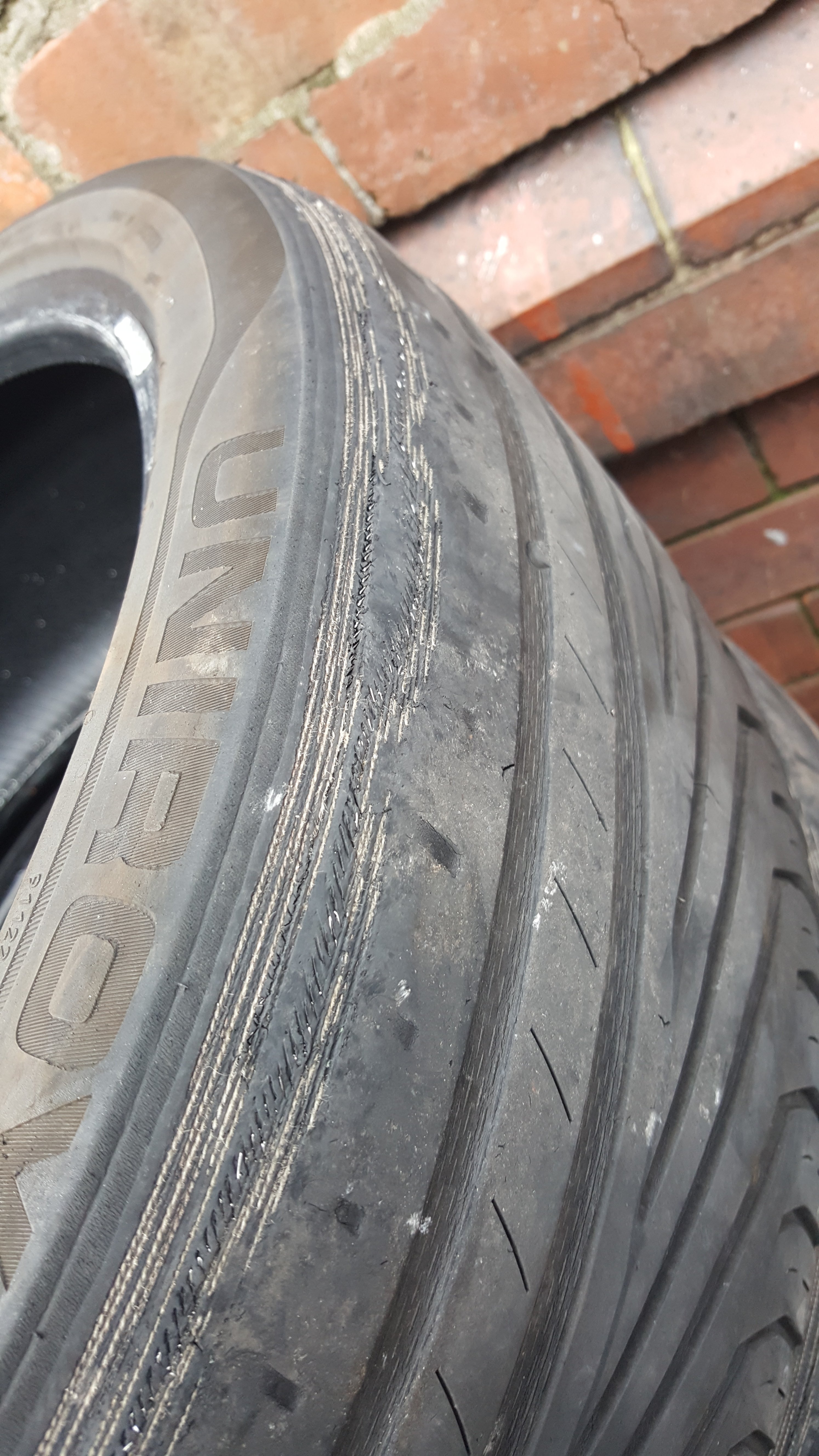

Btw rear tyres off and this is what they looked like .20170818_164909.thumb.jpg.050b4de098e6780eb2818e39263328d1.jpg20170818_164903.thumb.jpg.0982b31e38f897992b2792921bcce85f.jpg
