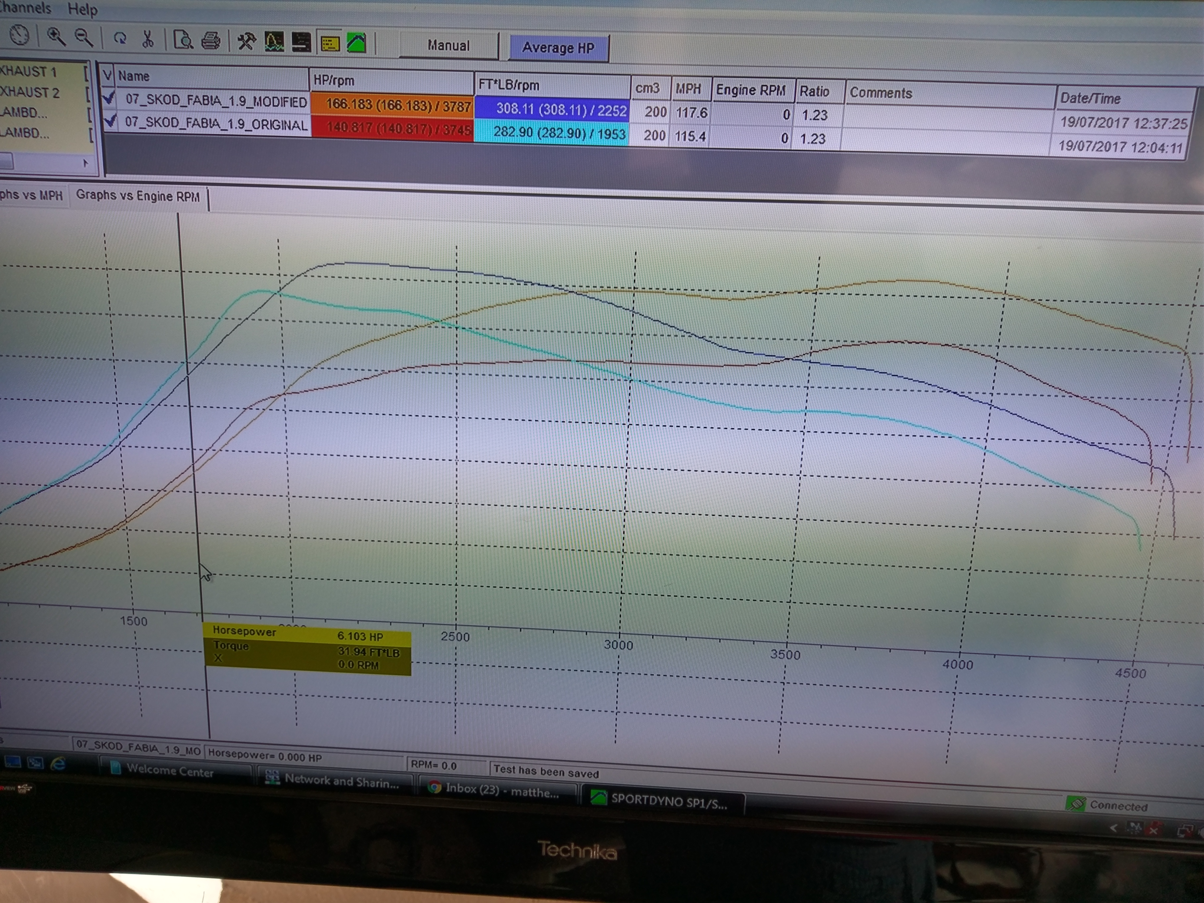

yip iv tested it on rolling road max air flow and standard paper same out put .dave your money
I changed mine on a rolling road too (K&N panel). It made a massive 1.1 bhp extra!! This of course could be just the difference between a clean and dirty filter. Still happy that I did though.
