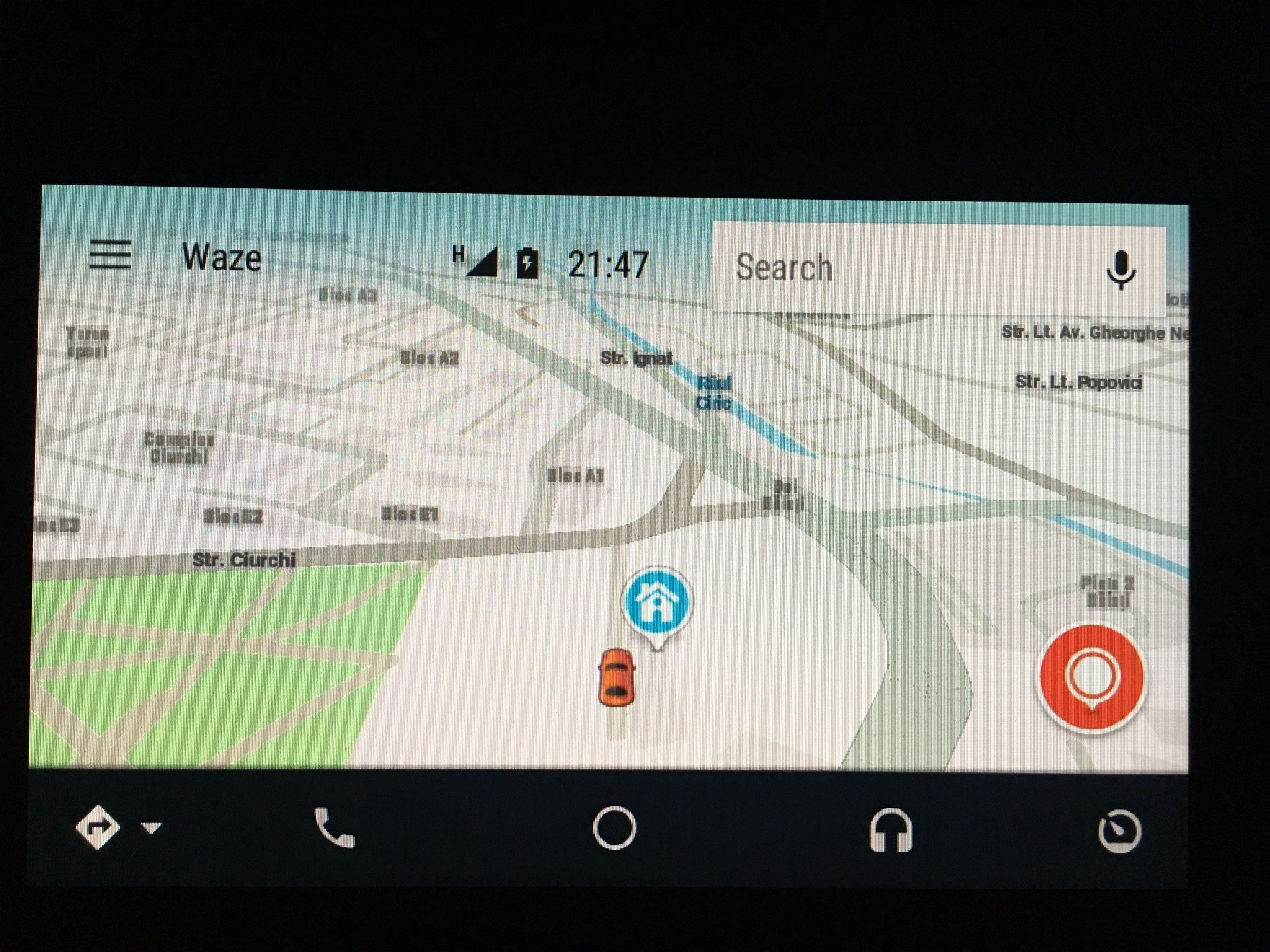

You might be right, the resolution might not be 720p but it still should not look like this.
I remember at one point in the past I did not had this issue! But don’t know what changed, except updates to AA and Waze.

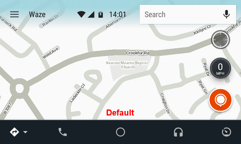

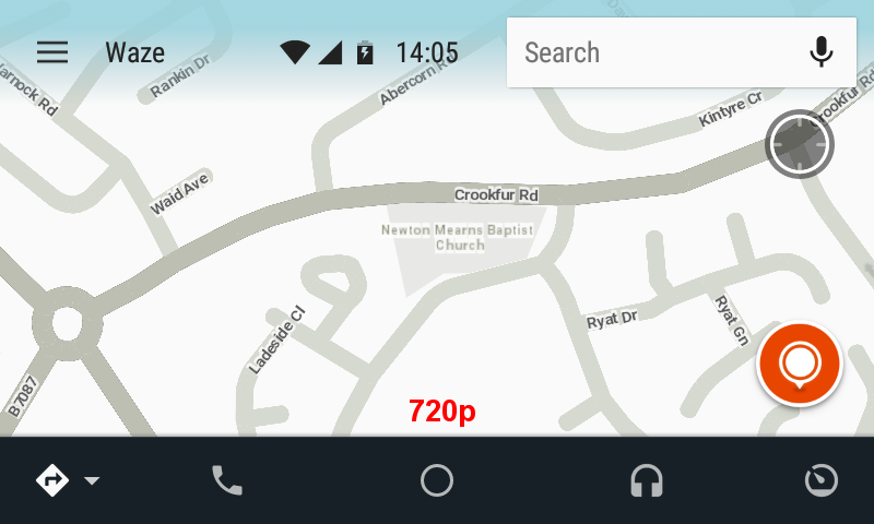

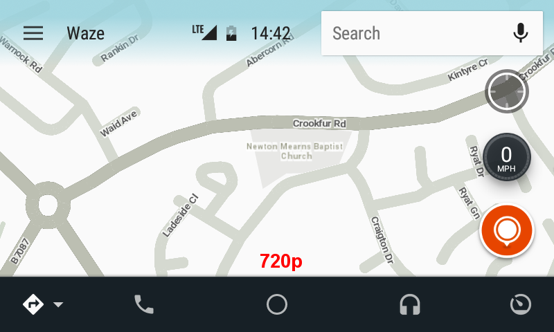

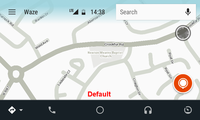

I have done some testing and the 720p (or 1080p) setting no longer seems to have an effect… if it ever did? Android Auto 3.4.582533 on the Nexus, 3.4.582534 on the Note 5 and Waze 4.40.0.4 on both.
Google Nexus 5 - SD 800 - Adreno 330 – Stock Marshmallow 6.0.1
nexus5.png.474d3ff8a5d049c6a105bc3d3b30004c.pngnexus5_720p.png.a903dc7273eac741edc11b0c2b7f5657.png
Redmi Note 5 (global) SD 636 - Adreno 509 – MIUI 9.5/Oreo 8.1
note5.png.dd5b88c8c06e4e0e3af0401201bc5b2c.pngnote5_720.png.aca9558027abba603870cc763cb056b9.png
All screenshots are 800x480 so it confirms the actual screen isn’t capable of 720p (1280x720) but I would have put money on the image sharpening up after enabling 720p in the past… I must be going mad :D
