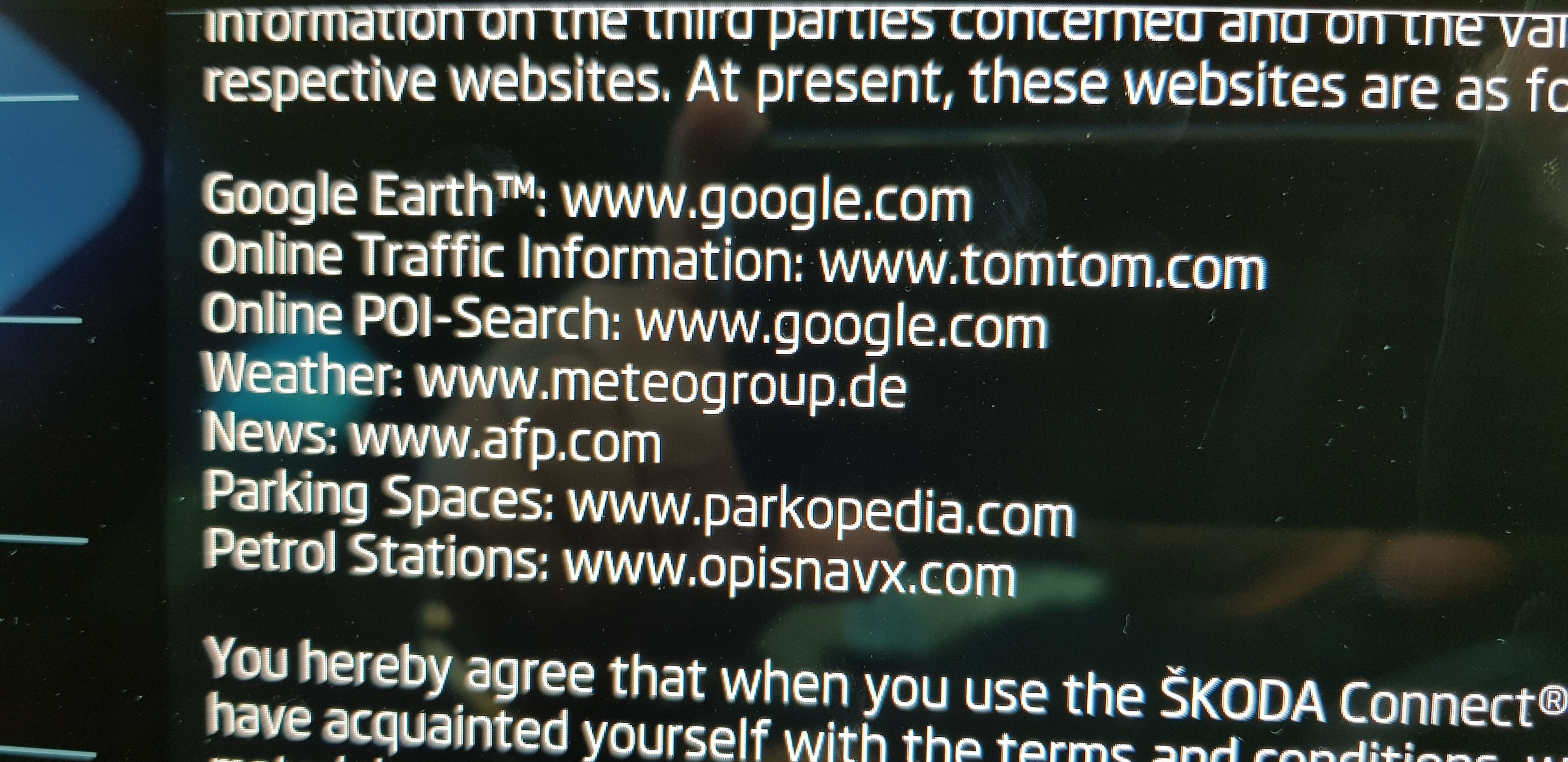

If you connect the Columbus to a hotspot on your phone it also downloads TomTom traffic data from the Internet. Otherwise it just uses the traffic data picked up over the radio.
Thanks. Funnily enough I was just in terms of use and noticed they use Tom Tom, although when using the hotspot on my phone I didn't notice a difference between data and radio. I'll give that another bash. It would still be useful if it factored in traffic to the router finder. Shame!
