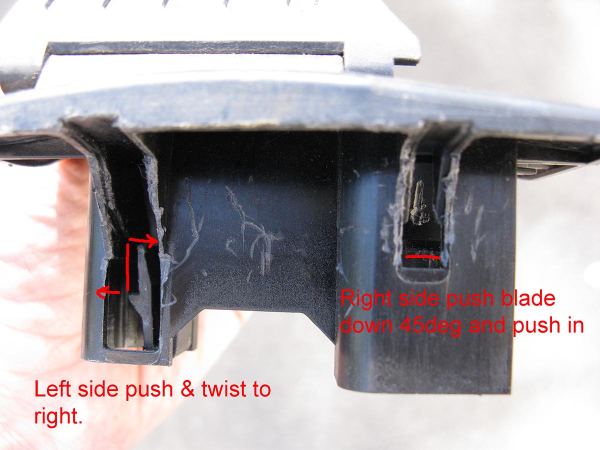

Well what a pita this is to remove! Not only do you have to dive in at about 45 degrees with a screwdriver, but the left and right floor locking clip requires a different action to unlock the clip.

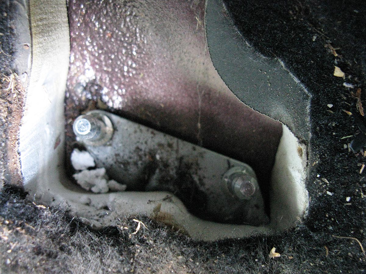

Poke a chisel between the rear edge of the pedal and the carpet and try to pull it up so you can lift the pedal a little on its clips and see inside the gap. Start with the left floor peg. The floor pegs are steel with a mushroom head. Push a 5-6mm screwdriver blade vertically into a moulding slot you might just see, which is part of the accelerator pedal. Twist the blade gently clockwise or push a little to the left whilst pulling the pedal upwards.
After releasing the left peg, move across to the right peg. With the screwdriver blade vertical, the release clip needs to be pushed inwards, NOT sideways like the left peg GOTCHA! You can see the evidence of my first attempts of just poking about and getting nowhere!
