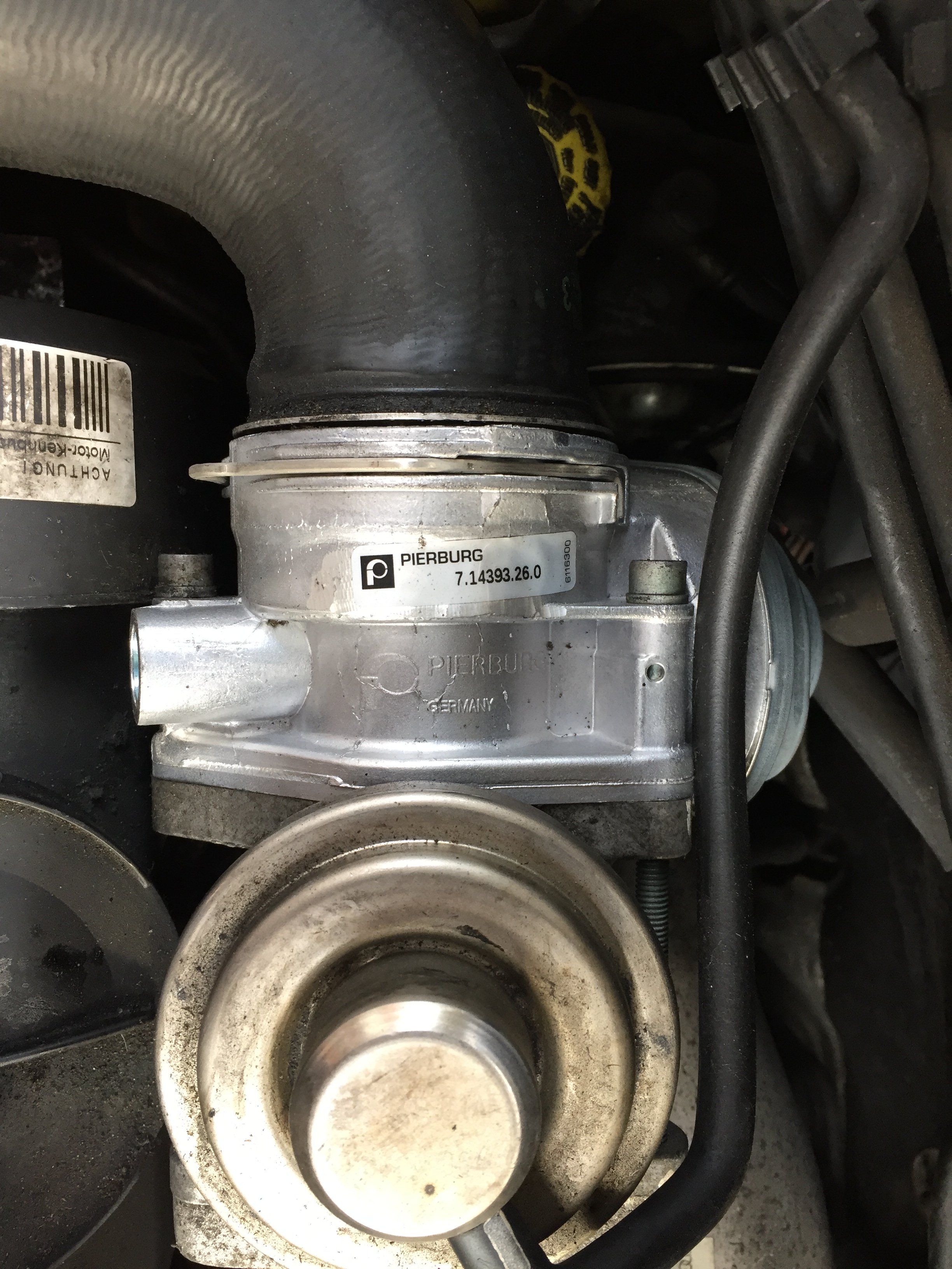

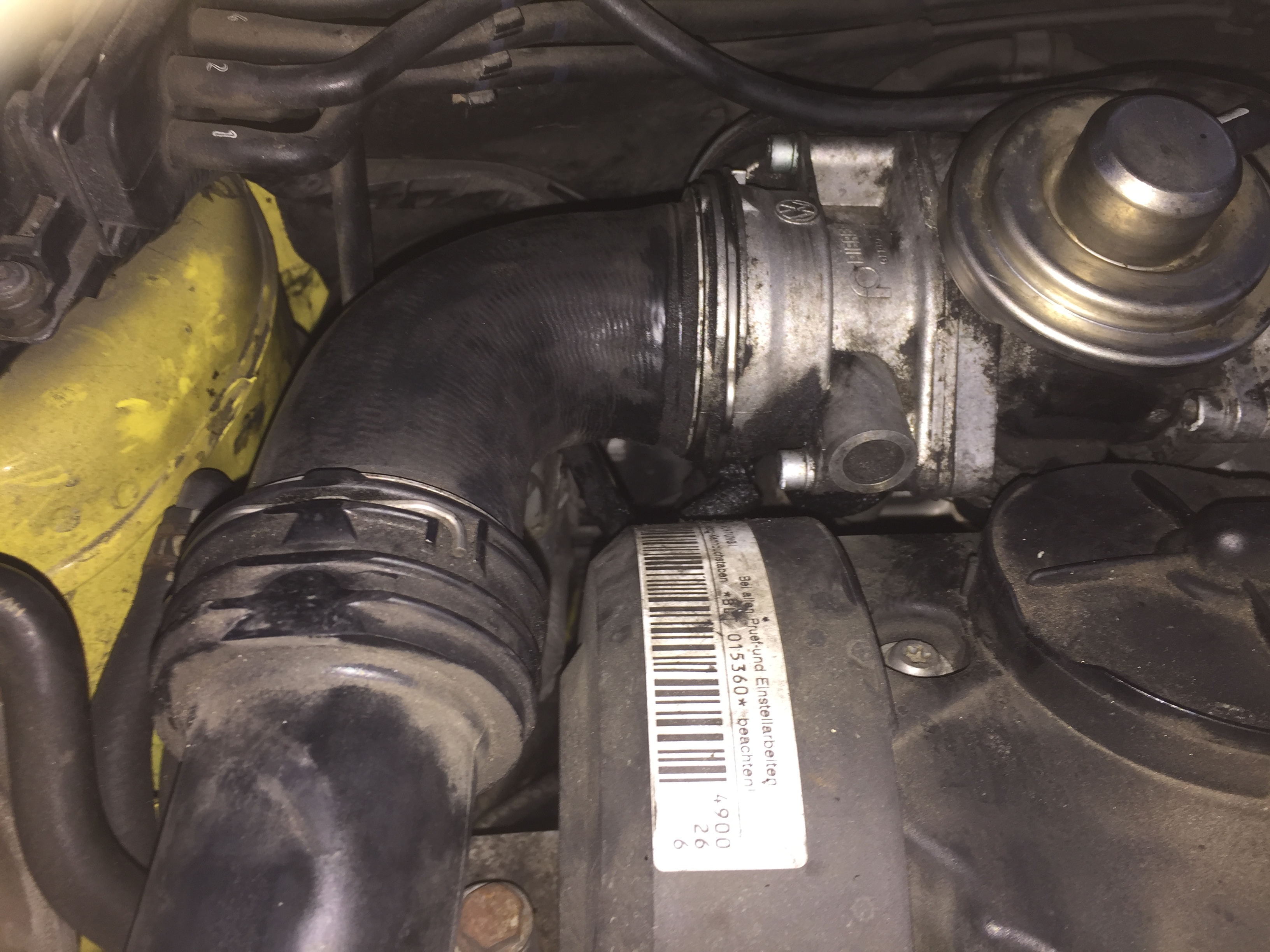

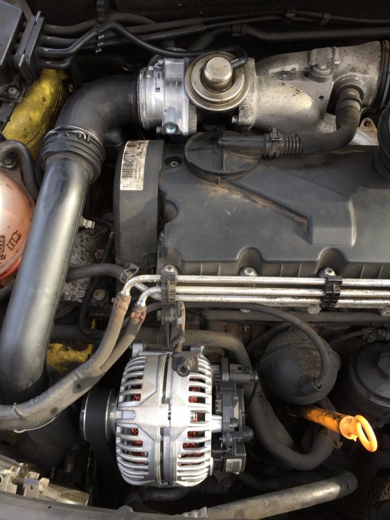

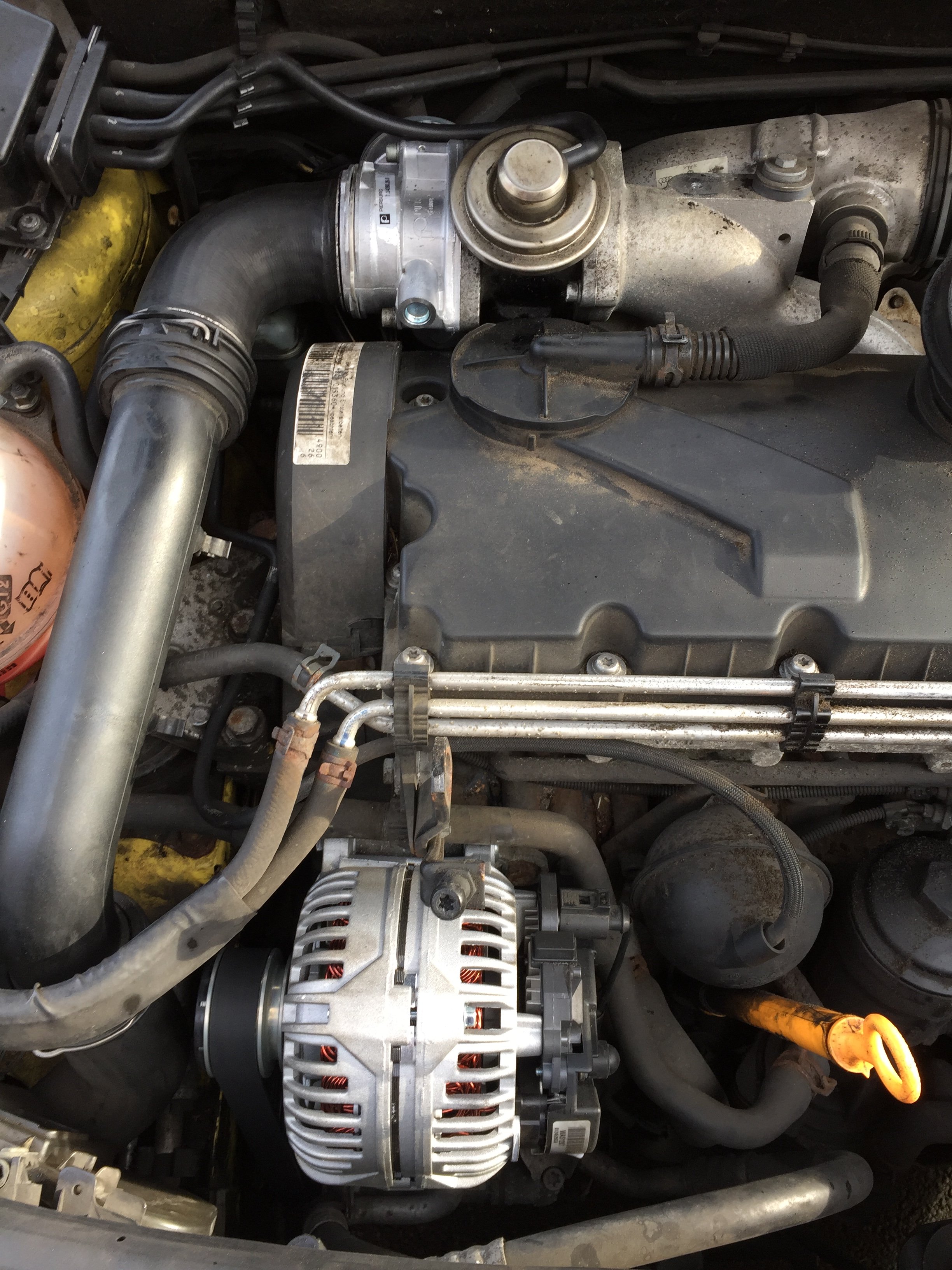

Photos attached/below show the new alternator I needed and also what i think is the throttle body/position sensor next to the EGR valve. In the past the hose to the intercooler had always been working loose but now it seems to stay in place.
Since I got it back though I dont get the turbo boost I used to pre-issue. Even on a hill in 3rd from about 2000rpm I put my foot down and the engine revs ok but the amount of boost feels totally different from how it used to be i.e. a lot less.
I am wondering if the electrical issue from the alternator to the ECU that was causing my faults damaged the turbo in some way.
Is this lilkely or a possability?

Its not a throttle body, Its the ASV (Anti Shudder Valve) Wonder why that was changed??
So that the inlet pipe would couple properly, it was probably worn out and they couldn't get it to seal.
I had the amber engine warning light for a while which would not reset and the fault was P1200 (if i remember rightly) on my OBD code reader which was linked to throttle position sensor. I assumed that bt changing the ASV this was resolved, though as you can see below it would not seal to the pipe and kept popping off no matter what i tried.
