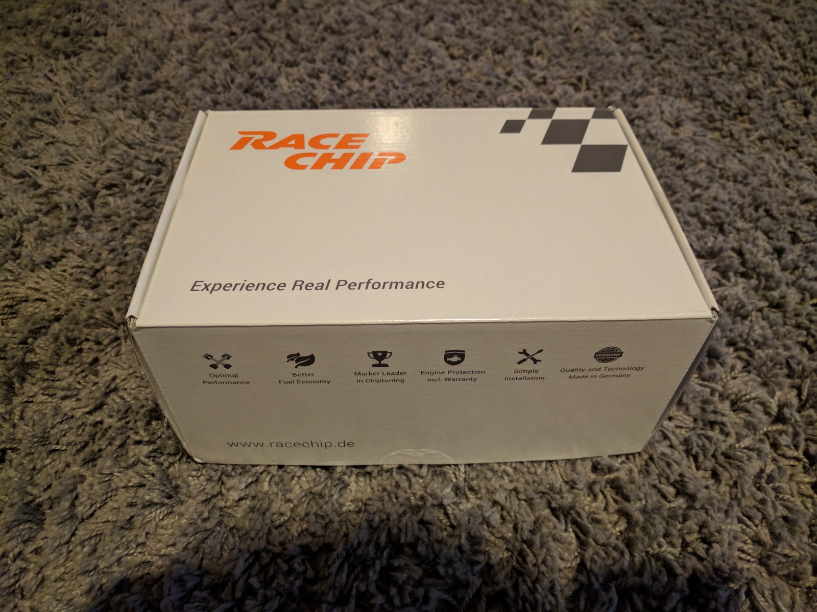

The package came well presented in a Gucci looking box as can be seen below, and comes with a wiring harness , the chip itself, an information/installation booklet, a terminating plug ( to be used if you want to remove the box but leave in the wiring) and finally some cable ties to secure.

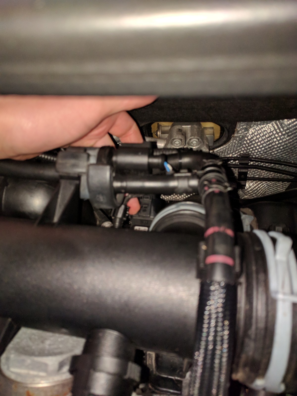

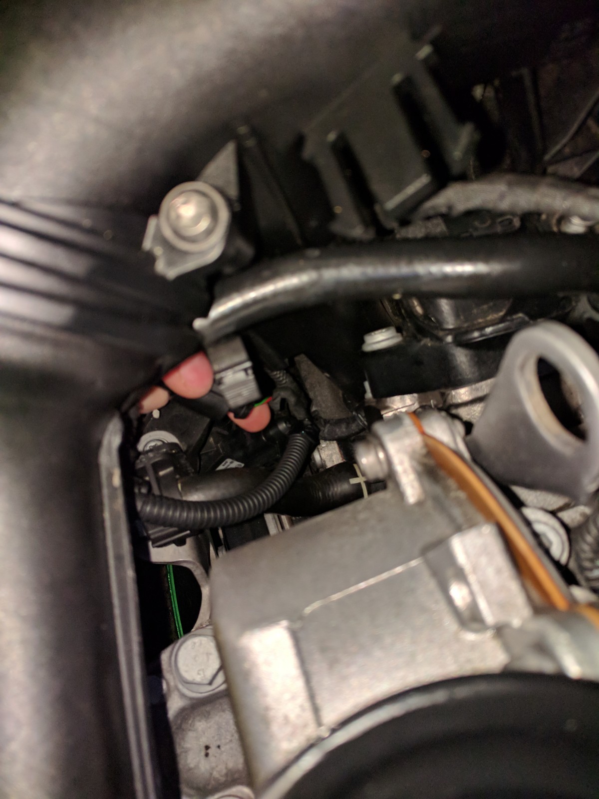

Installation was simple once I checked and double checked they were the correct plugs . The wiring harness is labeled A for the left most plug and B for the right plug looking at the engine. A was a little tricky to remove the stock plug but you can get one hand either side of the air pipe and down to remove the plug.  It's self explanatory when you do it so don't be too worried about mixing it up. The stock plug plugs into the harness and the harness plug clips onto the engine , same both sides.

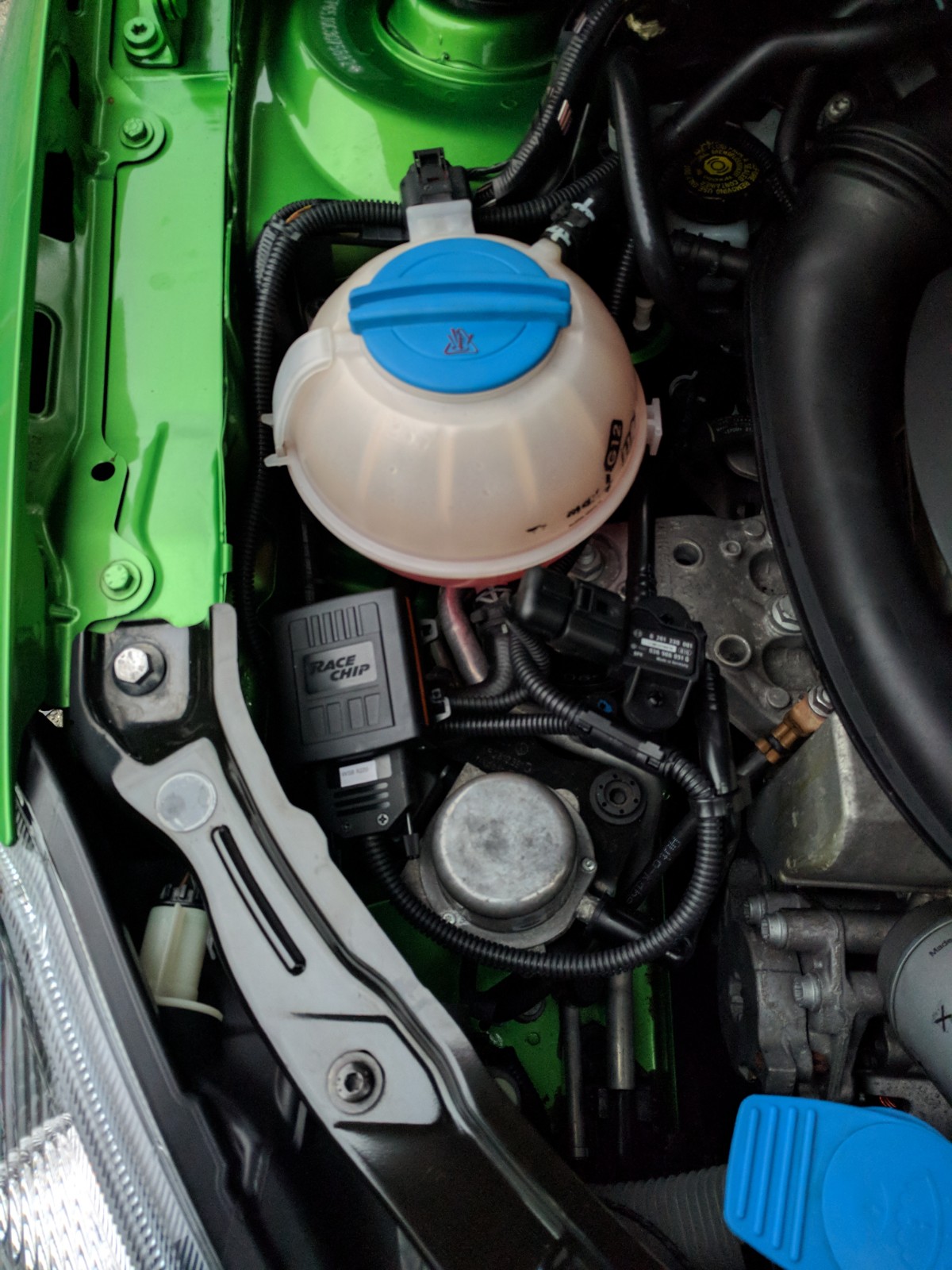

Once installed I just cable tied to surrounding pipes and the box somewhere away from heat and moisture . The length of the harness sort of guides you to a perfect position for the box anyway.
