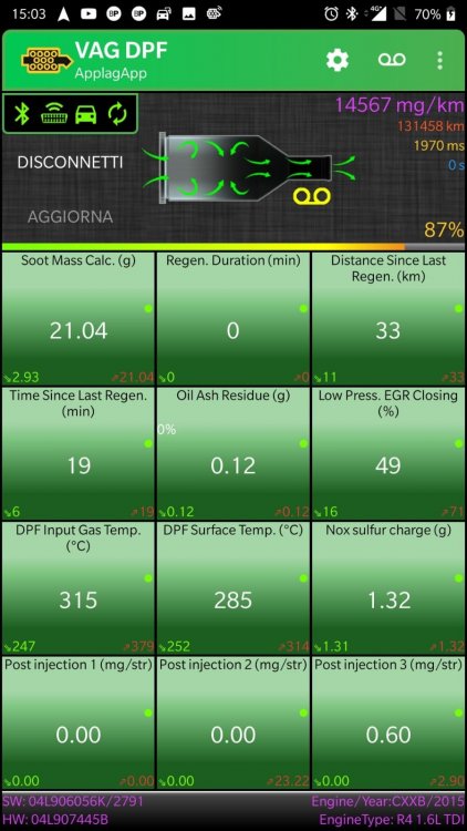

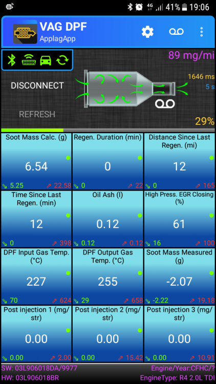

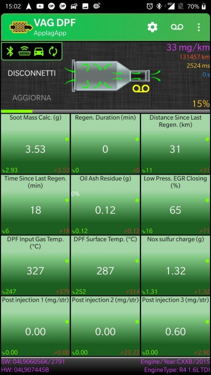

  • Just checked my car, as expected it's identical to the OP's and only has one pipe connected.   @REH17 - are you able to log values whilst you drive using your OBD dongle? I should have some

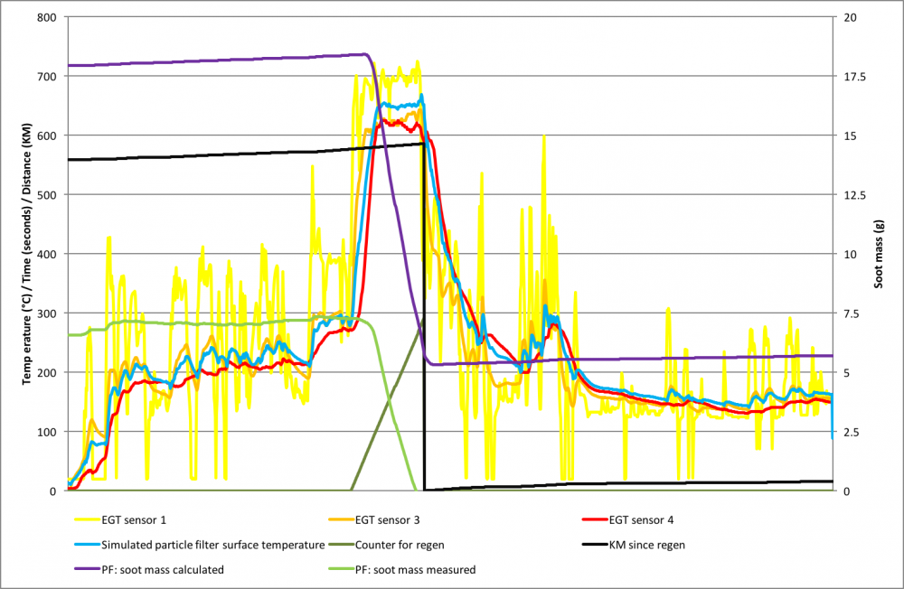

  • Basically, something is causing your car to create soot more quickly that I would expect. Once the active regeneration soot threshold is hit at about 18g, the regeneration process appears to be perfor
