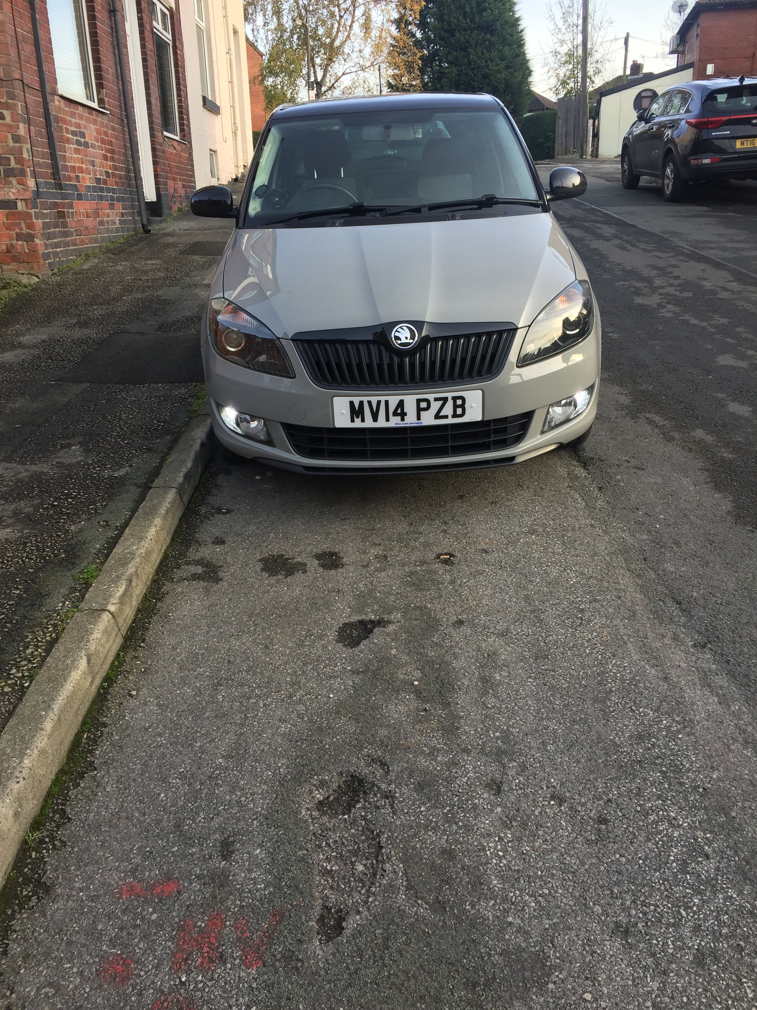

I have a 2014 Fabia Reaction (all the looks, none the power) and I am looking to improve the aethetics of the vehicle with white LED DRL’s instead of my silly looking yellow ones.
What bulbs do I need and are there any tips you have for getting the drls open?
thanks

Someone will know, but as it is i like them as they are, they are not offensive like those on a vRS where others think you have Fog lights on because they look too bright to just be DRL's.

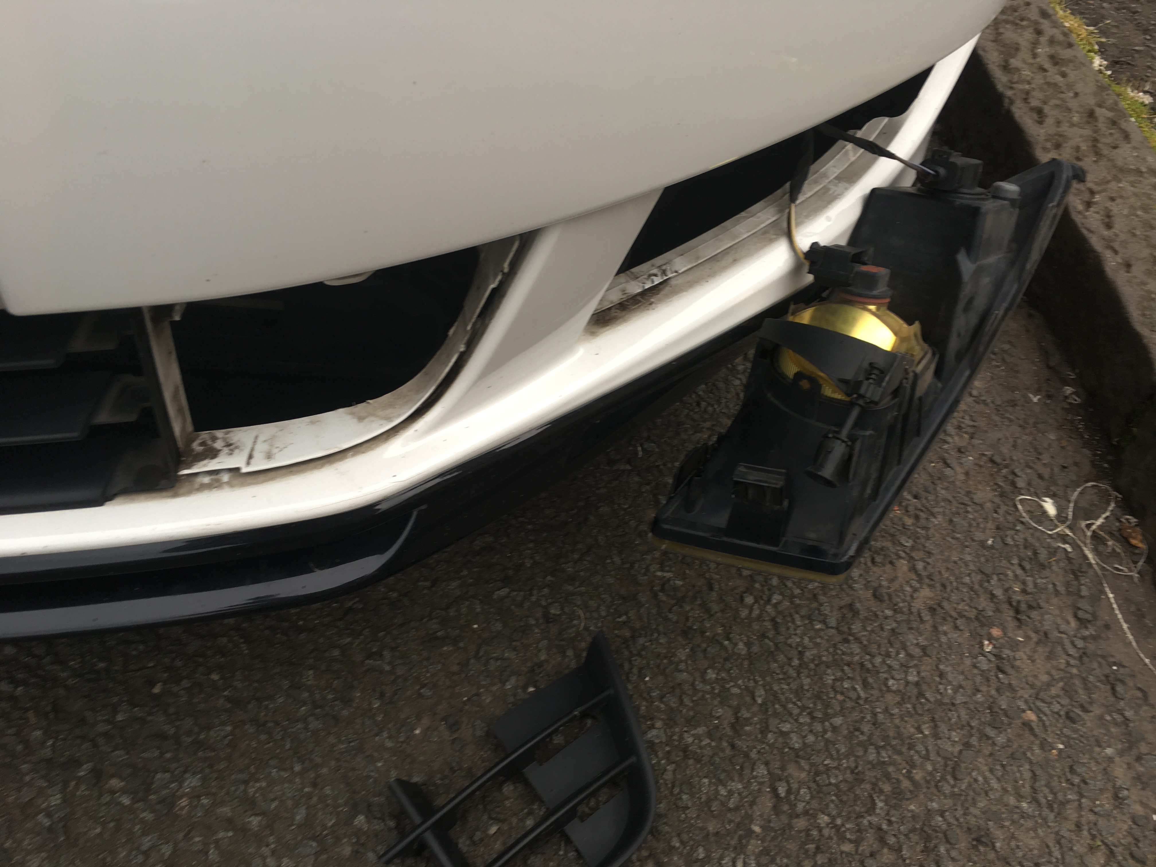

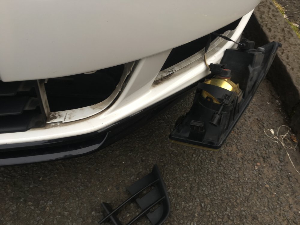

pull the buttom grill nearest to the fog light then reach in you’ll feel a clip push it and it will pop the whole unit out
Exactly what i needed thank you so much!
Bulbs just arrived, 10minutes later they have been fit!
thank you again!
