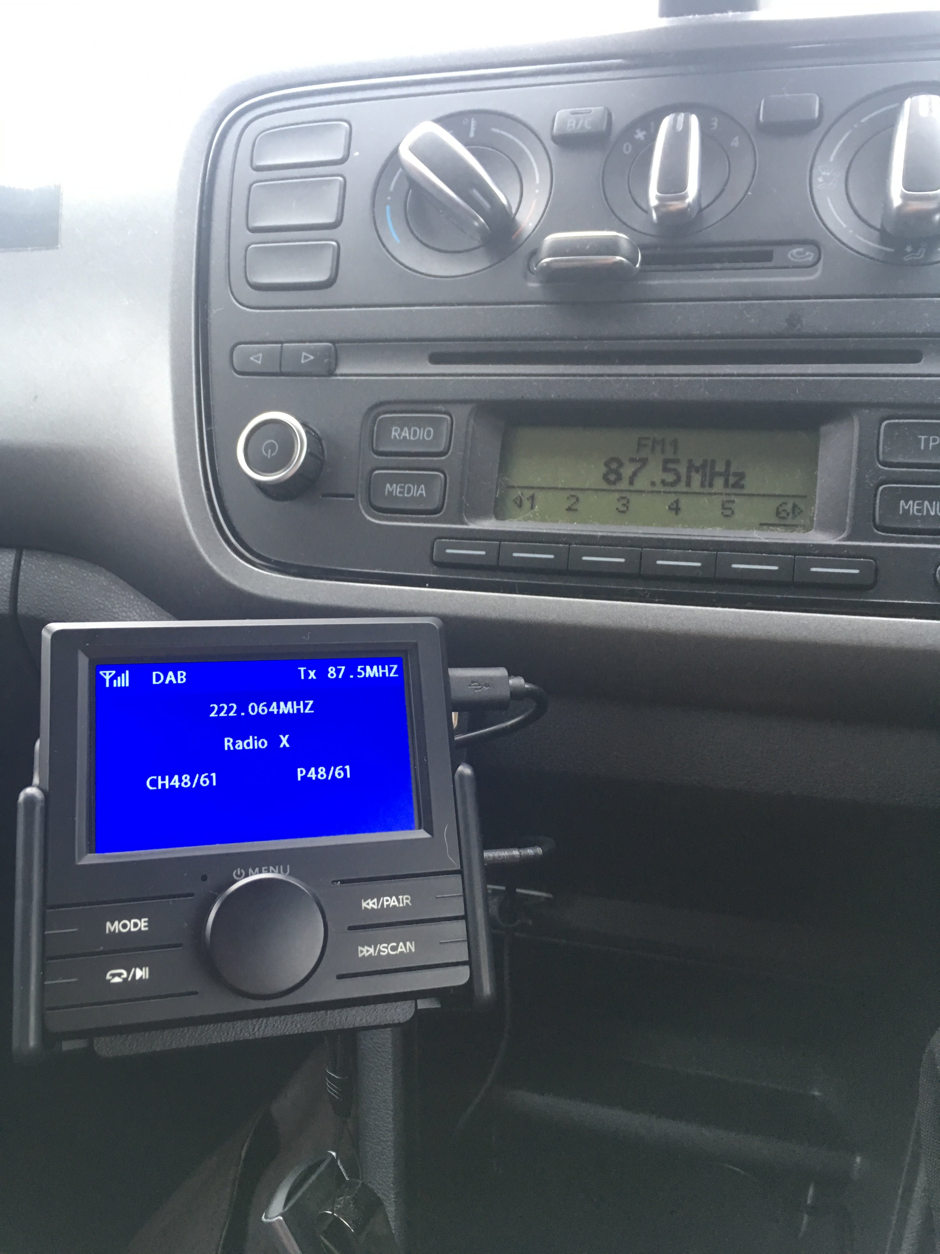

I've completed a DAB Adaptor installation in my Citigo and it's been flawless since install.
The kit I picked up only needed some very easy work. After removing the A PIllar trim,  the aerial needs to be stuck to the metal, then to the windscreen before running the cable inside the refitted trim and through the dashboard.
The excess wire is the most annoying part but some careful adhesives around the dashboard and it's as well hidden as it could be.

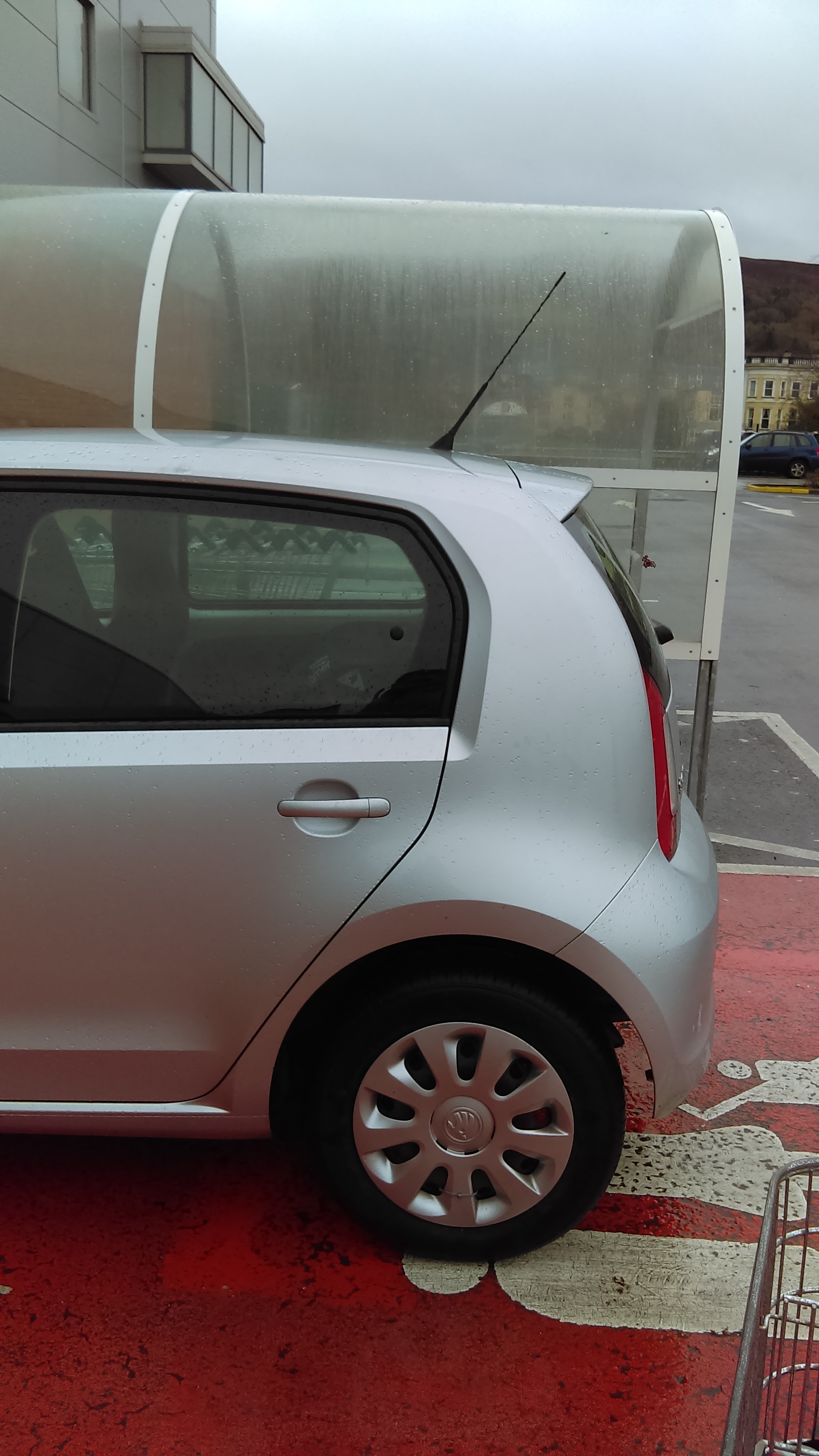

My wifes citigo came from the factory with the longer whip aerial.
Standard am fm unit and no signal problems, where my old mk1 octy would be a bit dodgy in certain stations in certain places hers has never had a problem...
Also, the longer aerial makes it look even more like a remote control go kart. Which is what its like really :D
Can you post a picture of the car with long aerial?
Will do tomorrow, its pretty dark now :)
