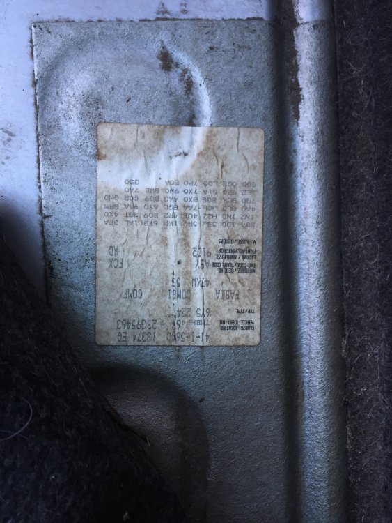

Gearbox code is on a sticker inside the front of the service book and also on a sticker under the boot carpet.
Cheers, I’ll look into it I’m assuming the code relates to the part requirement?

FCX is the gearbox code then.
Yes the switch is definitely part number 02T945415P
