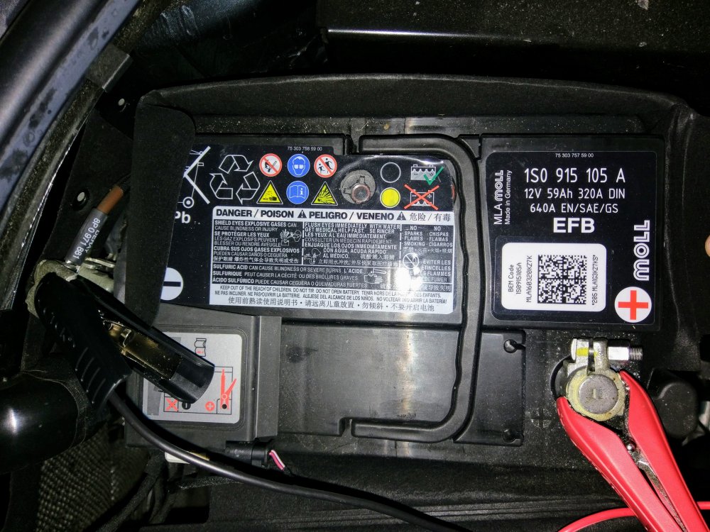

I'm charging the battery now and when doing so always connect the negative lead to the earth post of the car chassis, not the negative terminal of the battery (see photo).
The photo attached shows the battery. I can't see anything date-specific.  The car was built to order in April 2016.
The DashCam is permanently connected to USB, not 12v, so shouldn't draw power when ignition is off.  But i've now disconnected it to see if my problems go away.  The car is locked when not in use.
That looks like an 027 sized one. Easily upgraded to an 096 sized one. There is a bit of a write up for a golf MK7
However mine has an 096 sized 69Ah and it throws up warnings quite a bit too but nothing really wrong with the battery, I think it is just a bit over sensitive to be honest.
In fact infotainment is bleating that the 12v is almost flat just now. Haven't had my meters on it yet but it starts just fine. Although some things stop working. Bit of a cold snap always gets batteries, combined with less daylight, more lights and things like heated seats, heated screen, especially with a few short runs. These cars take a bit more power to run than a 70s Escort
Can't go much bigger than the one I have but will be having a look when the battery needs replacing. It did get the bigger 180A alternator though which is helpful.

The Date code should be on the -ve terminal and be week and year numbers  in 4 digits.
I think the 2D code shows 20/03/16 so might have 16/12 on the -ve terminal. Therefore original battery for April build.  (Guessing mid April!)
