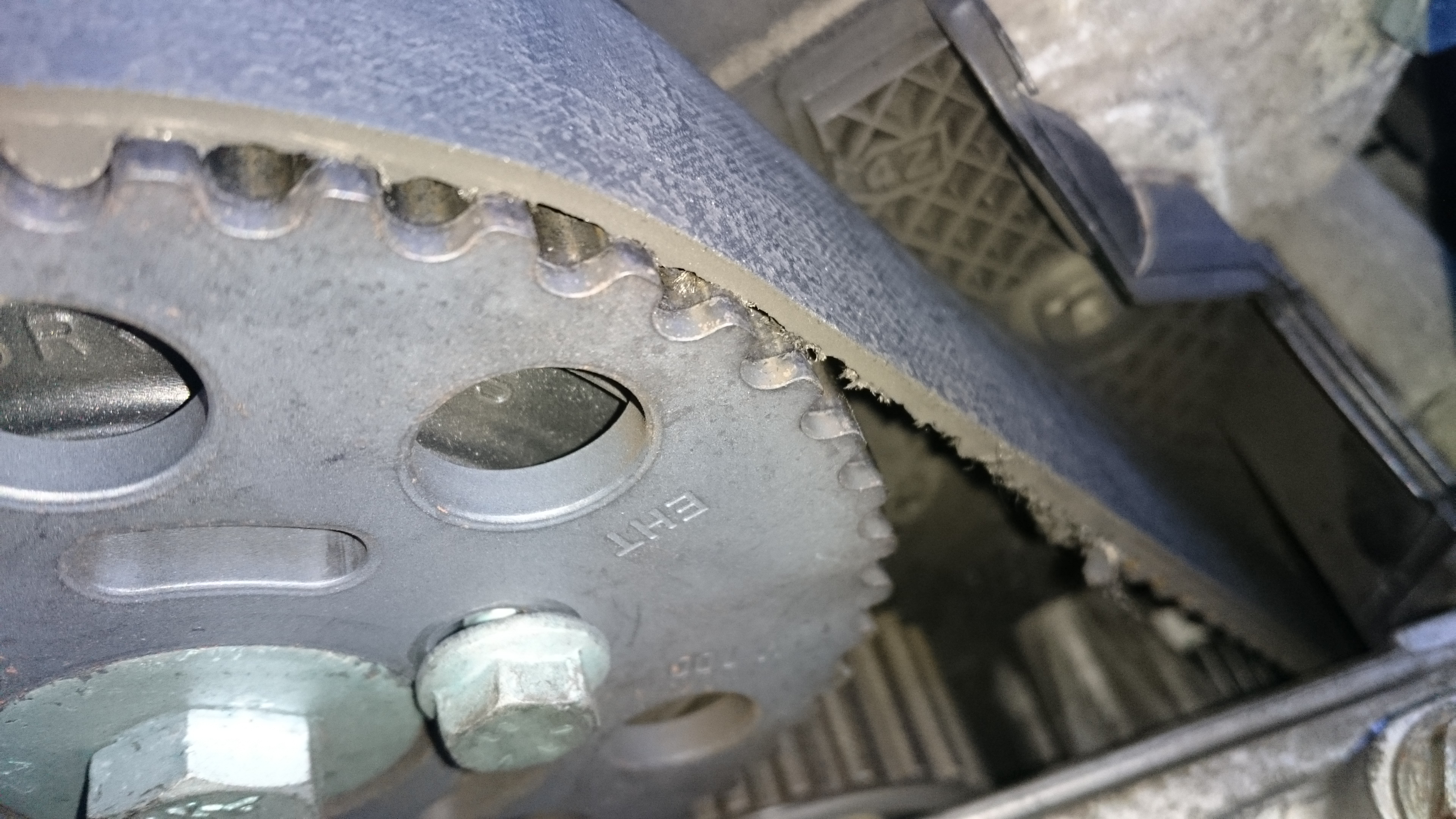

Found the problem....
Half turned the engine a few times to move the the timing belt around and discovered quite a few stripped Teeth on the belt.
Relieved we've found the issue but a little apprehensive as to what other damage may have been caused.
Timing belt kit was done back in February this year.
Thanks for all your input
Chris

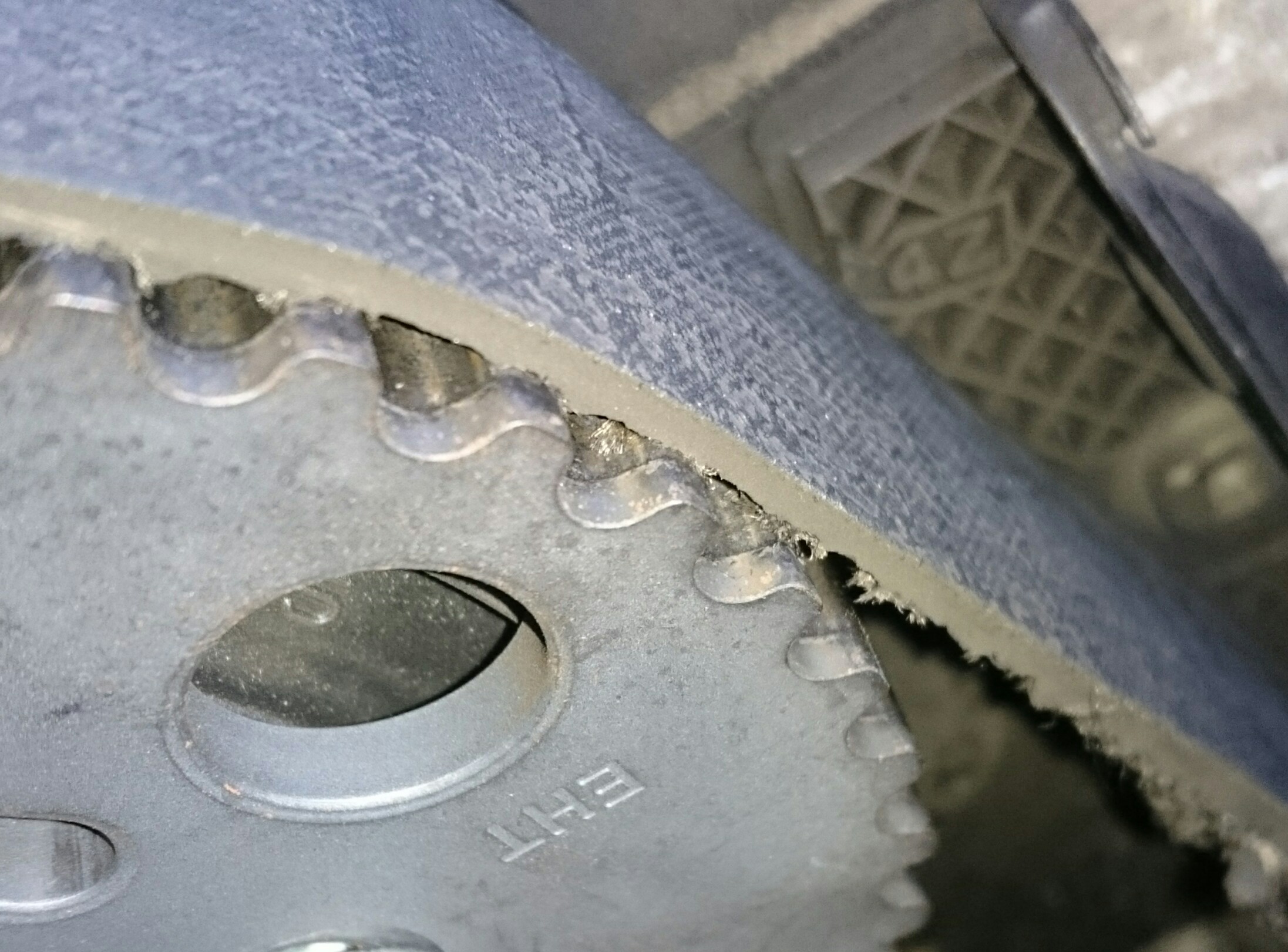

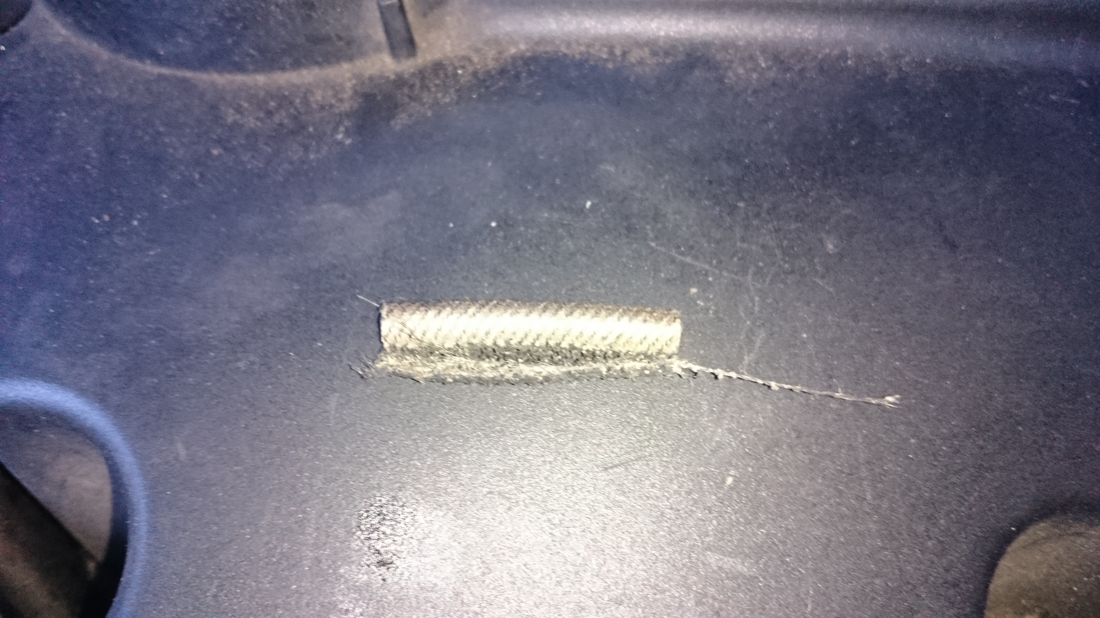

Anybody care to comment on the state of the outside of the belt?! It's like this all the way round,  almost looks like its started to melt... Or had something rubbing
Nope, it just looks like a nasty cheap belt, if it doesn't have the VAG markings and part number it's not a genuine belt.
Jeez, not even my 184k original cambelt looked that frigged on the non driven side when I did it earlier in the year.

Water pump siezed or tensioner issue? Something's caused that belt to go doo-lally.
