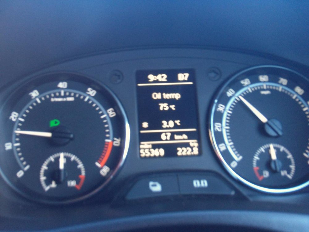

My oiltemp was around 95deg with an outside temp of -10 deg. This was on flat roads. The temp would rise abit in inclines.

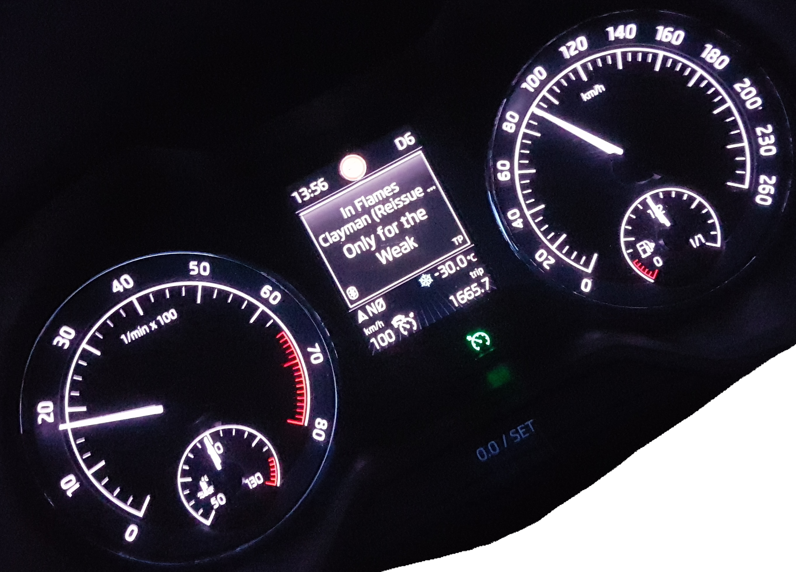

Forgot to check the oiltemp when the outside temp dropped to -30...

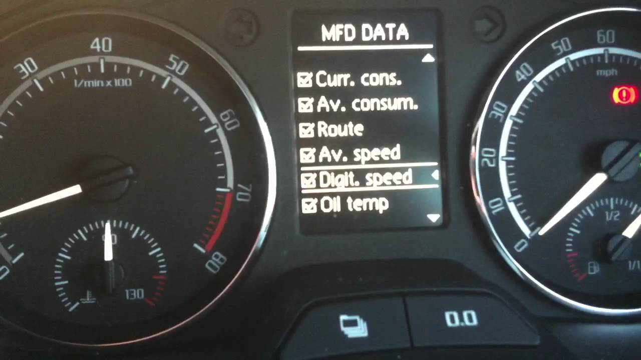

Have you checked that the oil temperature display is still selected in the info-tainment system?
Yes, that is a good point. No idea why it would be an option though.
Just for that reason to give options for those that want the option on what their displays shows.
Some have no interest if viewing everything as they scroll through.

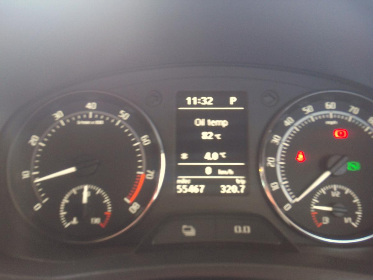

I'm on fixed duration annual servicing as my mileage is only around 6000 pa. No idea what oil is used. I rarely am forced to do regular cold runs, being retired, but heading up into the Pennines in a freezing winter has resulted in around 80C for the oil and just a smidge under the 90C for the coolant.

Although it would be interesting to see what the 1.4 TSI does up in the north with -30C and below. One of my colleagues told a cool story about Citrus (Citroen) or was it a Raccoon (Peugeot) with a small engine up in Finland trip where car decided to show outside temp as "--" and turn off air heater :-D
