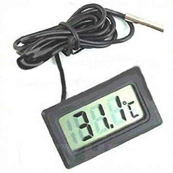

The ones i have are like this. Had 3 for about 10 years and still never broken.
£3 from Amazon.
Used behind a battery or at air intake to check temps, used down dip stick tubes and sometimes just in vehicles that do not have thermometers just to check what the temp really is.
Even used on pushbikes or motorbikes to get ambient temps.

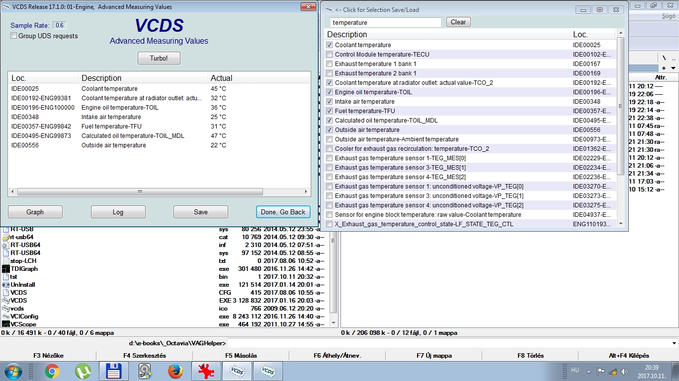

The bluetooth obd scanner is still on the way, but I've managed to borrow a VCDS interface. Here are the temps logged today's evening (the engine was used afternoon, so it had not enough time to cool down to ambient temp):
I think the engine oil temperature-TOIL is the real value, because I started the engine and it also started to rise. The Calculated oil temperature-TOIL_MDL hasn't changed at all.
