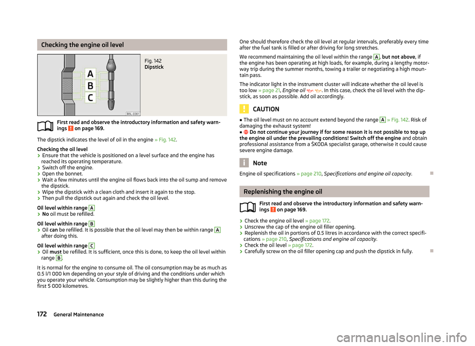

Are you checking the Oil at Operating Temperature parked on the flat after a few minutes, as you should.
This will be the correct oil check.  A Stone Cold check will have the oil level higher.
Are the brake pads new, so not much of a gap between pads and discs, or just some rust build up on the discs.
Have them checked.
Contact Skoda UK Customer Services and get the Service Record from the System,
and tell them off the issue with the SKODA SECRET SERVICING DEALERSHIP.
http://skoda.co.uk/about-us/recall-actions
This is not from a Citigo Owners Manual, check the one you have.

Thanks loads AwaoffSki.
Yep, the diagram in fact looks pretty identical to the one in my Citigo manual.
I've now managed to get the car booked in for a check on Monday, back at the service centre of the dealer.
The oil was about as far above the top kink in the dipstick as the bottom of the A section is below it (my dipstick looking like the one on the left, except the textured section on mine fills the whole of the 'kinked'/indented bit.
I will now see what happens on Monday, and follow your advice if it doesn't seem like they're sorting things and being genuine.
I did the oil check after about 4 or 5 mins after use (is that close enough to the suggested 3 mins?), though it had only been driven a couple of miles.  I then did it again after about an hour of being parked with same result as far as I could tell.  4 or 5 mm over the level it looks like it should be in diagram.

Oil level should be lower when oil is cold. And when oil is warm oil level shouldn't be over the top limit. You have to wait a couple of minutes that oil has enough time to return to oil sump before checking oil level.
These 1.0 MPI engines have timing belt. Both engines are same size. Power difference is just programming difference.
That is just wrong.
If you think after a few minutes warm oil is out of all the journals and the head and down the cylinders and in the sump again,
you are going to have certainly all that oil and more after you stop a 'hot' engine and it has several hours to drain,
there is not less oil in the sump Cold compared if you check 12 hours later to what is there as it drains down warm in 5 minutes.
The Engine oil does not increase in volume at 90*oC compared to at 15*oC, when it has gone around the engine and then back into the sump into which the dip stick dips.
(put 3 litres of engine oil in a cooking pan, mark the level cold,  them heat to 100*oC and see just how little there is in an increase from that mark.)
When cold and all the oil is in the sump there is something very odd if the Cold Check dip has the oil surface in the sump not higher.
Try it again tomorrow.
Cold dip before engine started, then operating dip maybe 16 km later.

For sure oil expands when it gets hot, as any fluid. And when oil is hot it will return in 2-5 minutes back to oil sump.
If you start and stop an cold engine, that's when you shouldn't check the oil level. Because it takes some time before oil return to oil sump.
Edit: If you top up to upper limit when changing engine oils, there for sure is too much oil when engine gets warm. That's what they often do, and that's probably the reason why there is too much oil in engine in this case too.
Edited by Emil
Too many overfilled and underfilled vehicles out there from PDI's and Services.
When talking Stone Cold, that is an engine not started and the oil pump raising cold oil.
'Warm' is a Translation error in Skoda Owners Manuals where VW , Audi might say 'operating temperature' and SEAT says 'Hot'.
Some owners manuals from VW Group / Skoda clearly say only the 1.2 44Kw engine is checked cold,
for a 1.0 litre Up!miiCitigo read the owners manual, see what translations are used to any language.
None of it is rocket science or difficult,
but sitting ticking over does not get modern engines to operating temperature.  If checking cold, check cold un-started engines.
Edited by AwaoffSki
In our language (Finnish) I often say "warm engine" meaning it is at operating temperature. Not just a coolant but oil too needs to be warm.
No operating temperature is Coolant at 90*oC and oil will be 80*oC or so.
'Warm' is the error, the confusing, the **** up!
even with 'Factory trained technicians' or so called.
Drain off or suction off engine oil (1).doc
Oil changed @ normal operating temperature as well.
Edited by AwaoffSki
No, operating temperature is when engine is warmed up. Also oil even though you cannot often say how warm oil is, when engine is warm.

Can you just go to the car, open the bonnet, do not start the engine or move the car and see where the oil is on the dip stick?
If it has a Long Life Cam belt it is a belt and not a chain.
Okay, yep just done that.
Without any pre-wiping of the dipstick it appears a good 5 mm above the top level of the kink in the dipstick, or in other words 5 mm along the continuous long straight section.
My dipstick is like that on the left in the manual's diagram, except that the textured section shown as B ('oil level within range') fills the entire length of the kinked bit.  There's no untextured section of dipstick (as in A or C in the diagram). So not obvious to me where A or C are actually supposed to be,.
Also, the dipstick also has a little knob of yellow plastic just a few inches up from the kinked section.  All the way up to this there also appeared to be some amount of oil residue of some kind - that is, it wasn't completely 'dry' looking before wiping, but distinctly less 'wet' looking that down at the bottom area previously described.
Then I wiped the dipstick and re inserted.  This time it reads as about 2 or 3 mm above the top kink.  Car currently facing direction that is probably very slightly uphill.
Thanks re. cambelt too.
Edited by Ben70
To me it sounds like you have too much oil in the engine, unfortunately. I hate when they do that at service. It shouldn't be hard to fill correct amount of oil.
