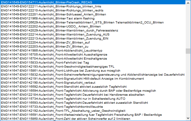

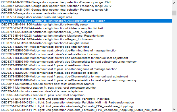

Hi there , I want to enable the HBA....
High Beam Assist
09 Cental Electrics
Security access 31347
Adapation
Assistance light functions Menuesteuerung Fernlichtassistent
Change to Present (Enables setting on menu)
The problem is that inside the Adaptation there is no Assistance light functions Menuesteuerung Fernlichtassistent
i Get only this list
What ta hell???
i have also this list , is there any chances the correspont change , is changed to something else??
High Beam Assist
09 Cental Electrics
Adapation
What ta hell???
Does your car have a camera near the rain/light sensor on windshield? If not no HBA support
Yes....... It does
i found it ,
its not Assistance light functions Menuesteuerung Fernlichtassistent
its
Fernlicht_assistent-Menuesteuerung Fernlichtassistent
