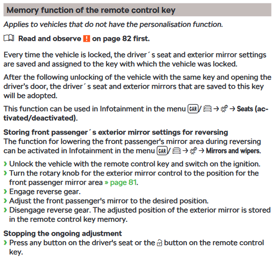

According to the manual, there is a presider to have the passenger's mirror, lowering in reversing.
Tell me if this helped.

I did the presider as described in the manual

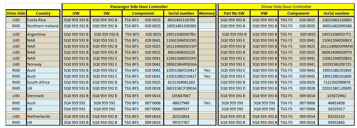

Cheque if your model is this one.
SW:5Q4-959-592-E HW:5Q4-959-592-B ---
Door Elect, Pass. ;Component:TSG BFS 011 0032, Coding:00150020D000040000001100
Edited by RedleH
My coding:
SW: 5Q4 959 593 F HW: 5Q4 959 593 F
TSG FS 006 0246
Coding 00150920D000020000001100
I hope this graphic can be helpful

Ok now we have different hw and SW versions as well as difference in coding...
