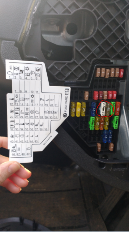

I just checked the fuse box and (presuming I read the card correctly) the fuse looks to be fine.  I believe it is the white 25A fuse circled in the attached image.
(side note - does anyone know why one 25A fuse is white and one is clear/brown?)

Looks like you have the correct fuse.
