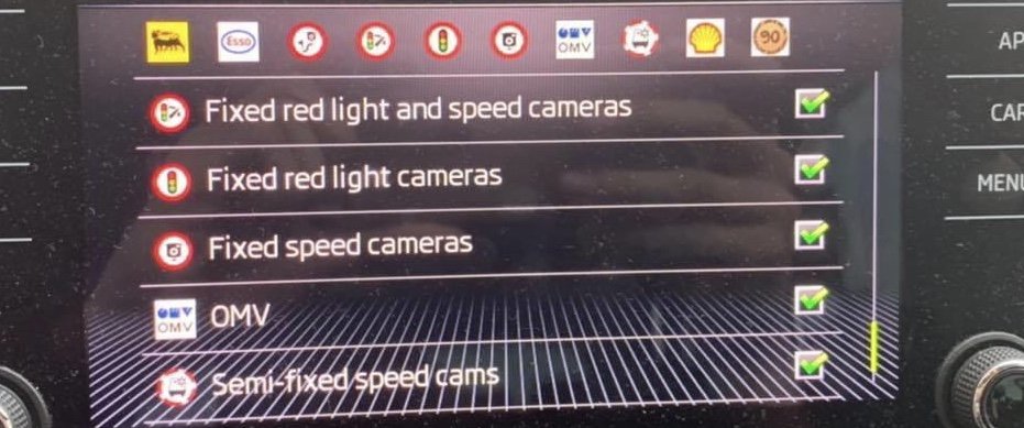

I did a bit more digging and used a tool to view the DB3 data and this is what I saw under the poicategory table. Warnmessage field is empty on all 3 categories:
Just wondering if this should have a value?
Cheers,
Paul

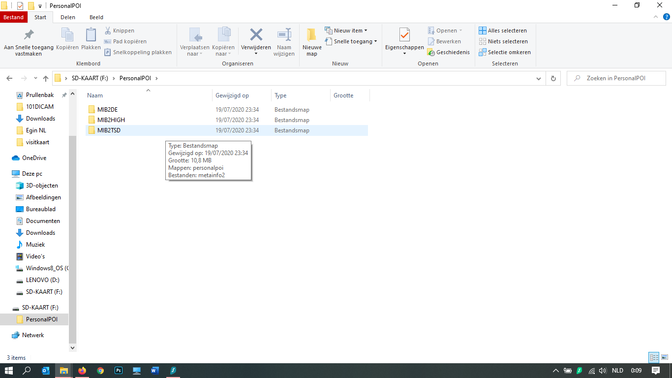

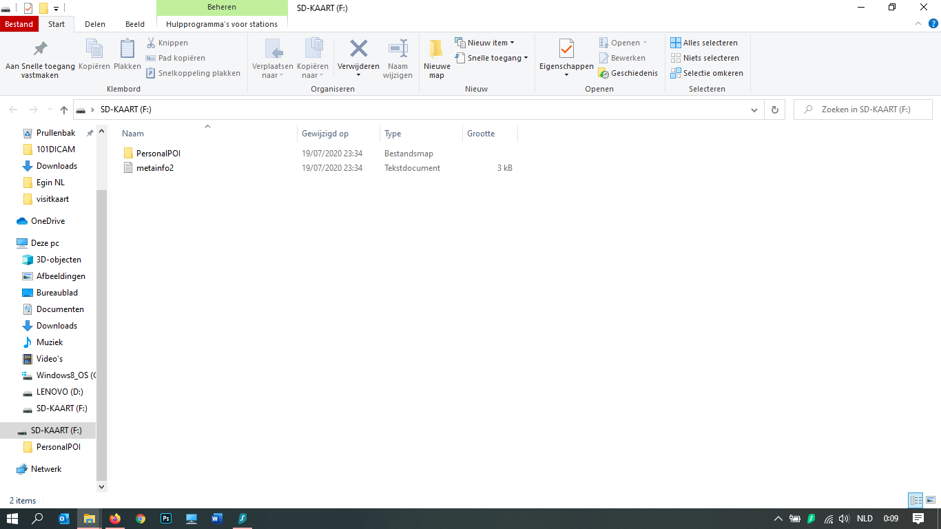

hello
pls can someone help me, i have done all the ask stap's but still not working for my vw tiguan car 2019.
i have also a video here https://streamable.com/16jhsv
