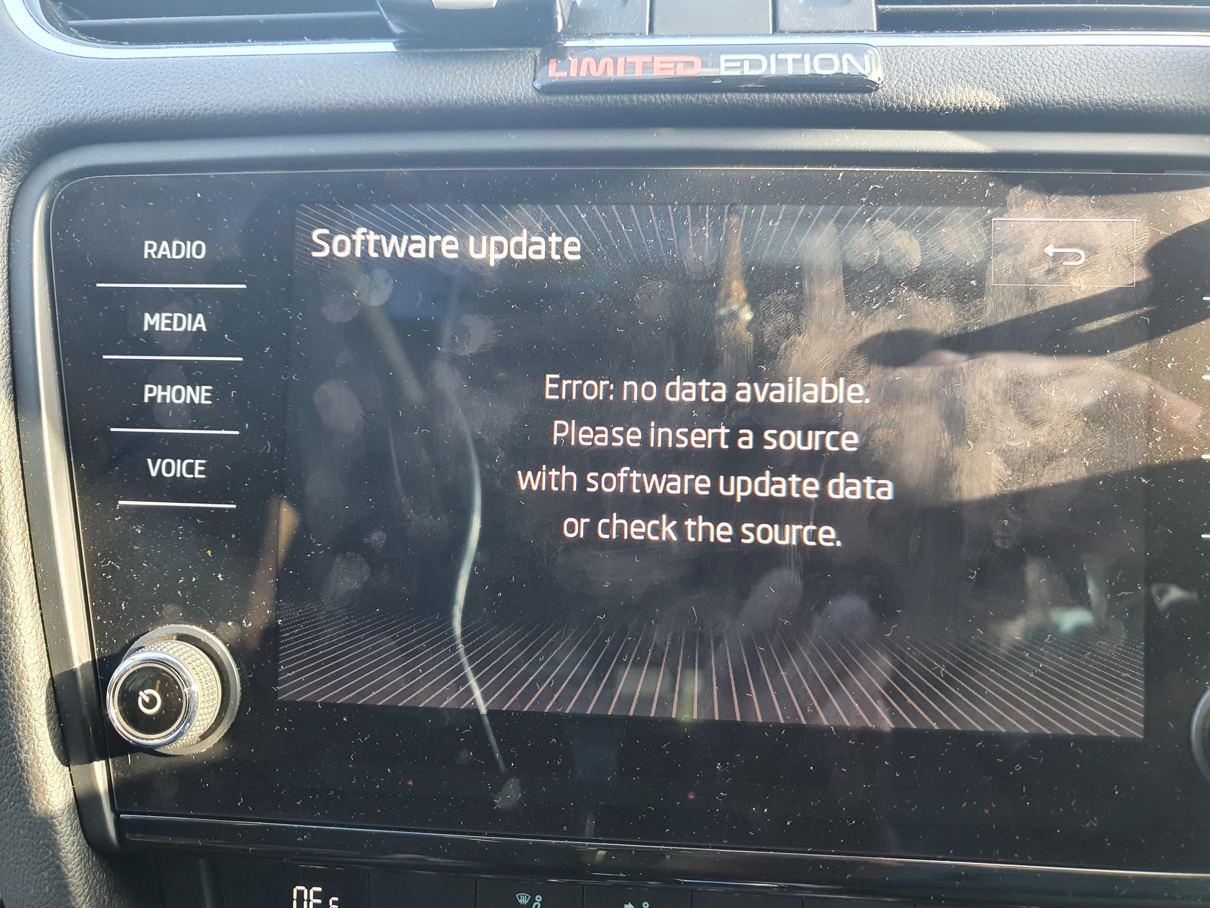

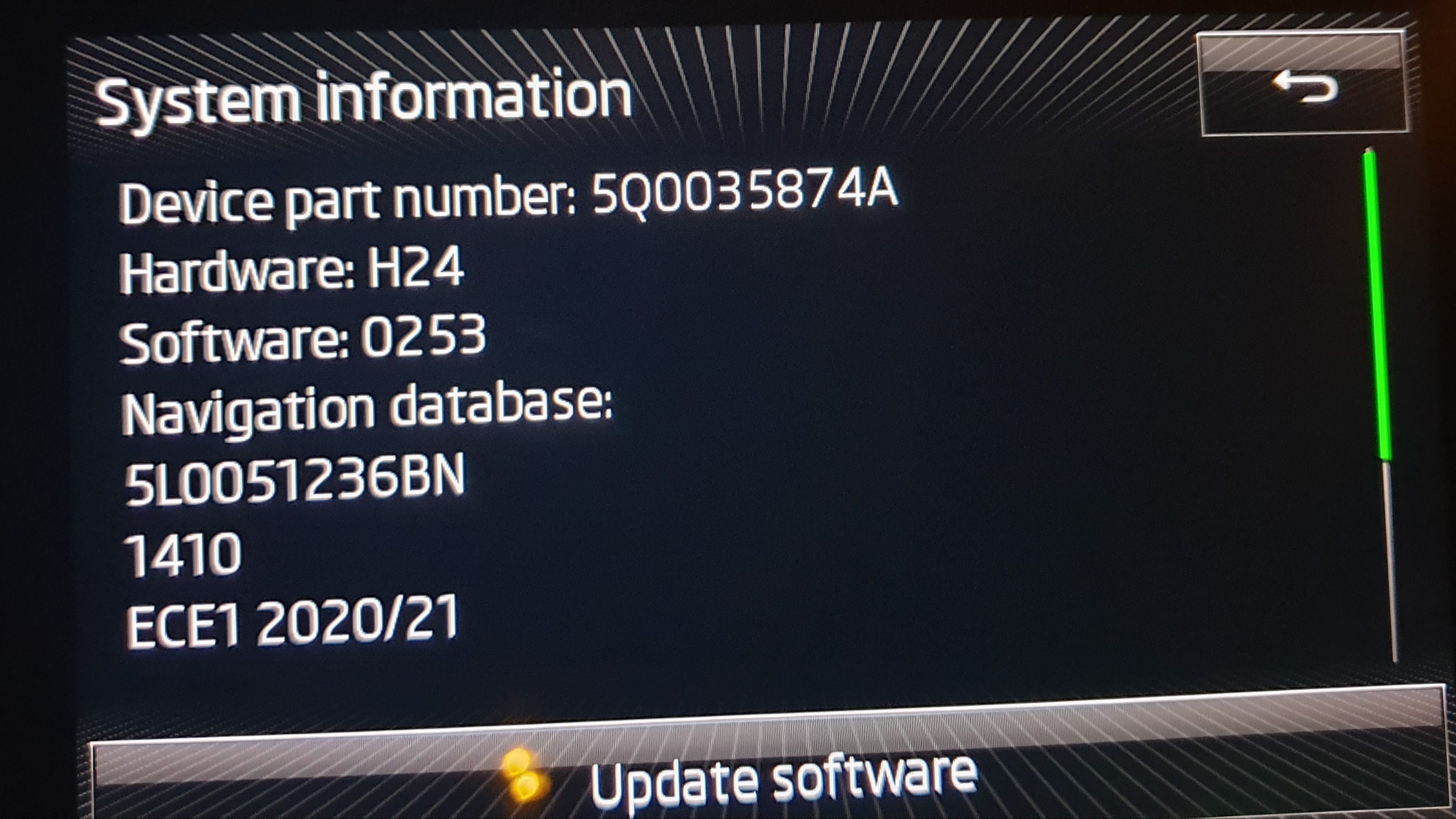

I try ur but its not working in mine
Please see the attached pictures
@Rayhan
Your unit is a slightly earlier model than mine but it's definitely an Amundsen so I don't see why they shouldn't work. From the display message on your screen it means that your unit hasn't recognised the files. Have you followed my update instructions properly? You must only use a SD card - a usb stick will not get recognised. And have you extracted/unzipped the downloaded folder? You could also try using a different SD card if the previous steps haven't worked.
I try everything but no luck still same massage come I use SD card

Sorry - I can't think of anything else. Are you opening the extracted/unzipped folder and then copying the contents? If you are copying the main folder it won't work.
