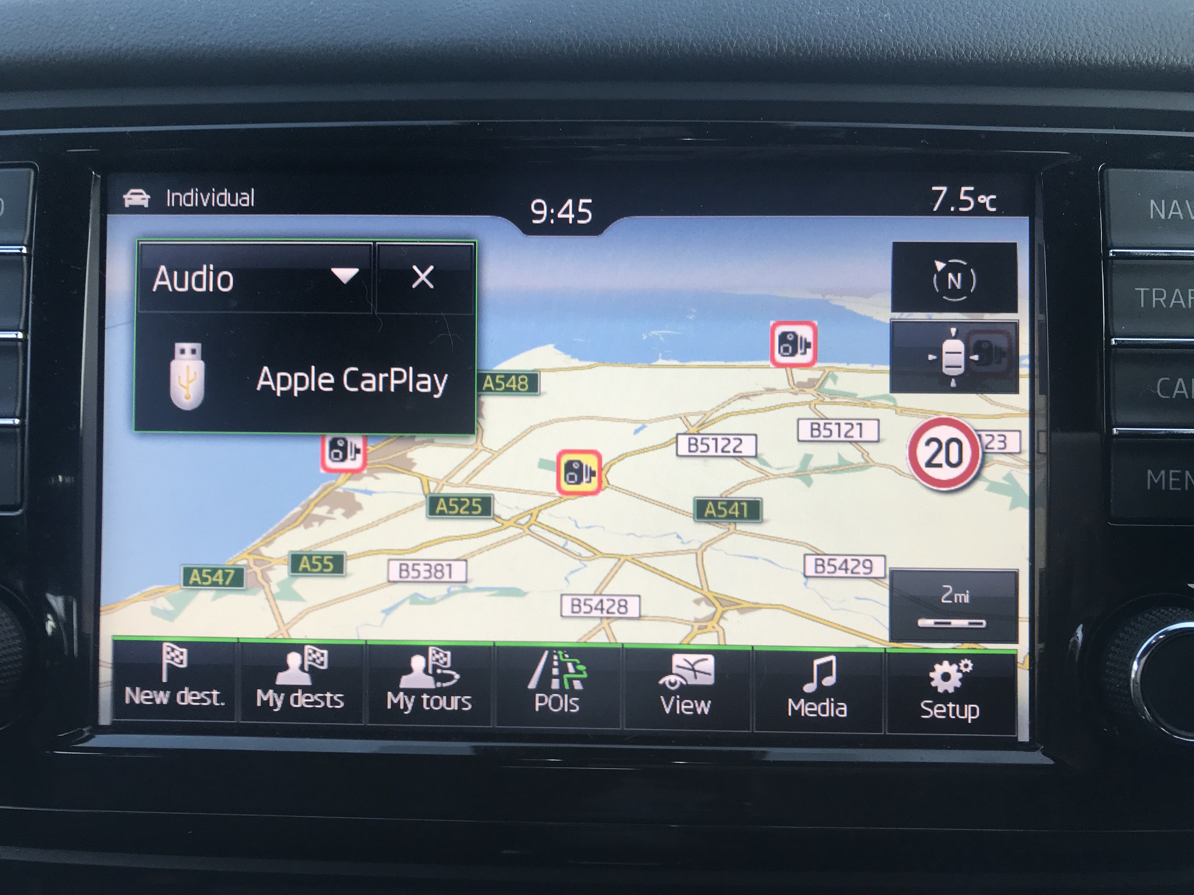

Hi, once again here's my current updated latest customised version ( December, 2018 ) which I'm offering to share if any forum members wish to use them. For info purposes this version contains UK only speed cameras which are split into four poi categories i.e. Fixed Speedcams, Average Speedcams, Variable Speedcams and Redlight Speedcams with my own choice of icon for each one of them. Remember to Install them as I explained in the first post in this thread i.e. after extracting the zip file remember to place only the PersonalPOI folder and metainfo2.txt file onto your sd card ( Note: a usb stick will not work! ). Also, remember to select/tick the relevant poi categories and the poi audible warning alert after performing the update or they will not display on your map or alert you. I hope you find them useful.
UK Speedcams December 2018.zip
This is such a cool thing you are doing and thanks for sharing with us. I wonder if you can have these speed cameras just on the map without the alert? I am not a fan of audible alerts but it would be nice to have the cameras on the base map and appear as and when. Kind of like Waze when I approach a camera it tells me on the map, but it isn’t audible. If I downloaded these and ticked the poi alert but not the audible alert would they appear on the base map? Also, is the download process the same on a Mac? Many Thanks :)
Yes - they will just appear on the map as a poi without an alert as long as you don't tick the alert setting in the nav announcement menu. I'm not sure about using a mac but I would imagine there'd be no difference. Just remember to use a sd card, only place the extracted files i.e. PersonalPOI folder and metainfo2.txt and finally go into the poi categories menu - scroll to the bottom of the list and tick them. Any problems just let me know.:)
Thanks a lot, will have look now, see if I can get it to work :)
Seems to work just fine and a very easy process to load onto the nav unit. Also works just fine on a Mac. I've just got to drive past some speed cameras and see if I've done it right :)
I'm glad you sorted it :). You can zoom in/out and drag across the map just to check if they are displaying if you don't want to drive anywhere. just to let you know as well - the audible alert is pretty low and unobtrusive if you decide to try it out. It only makes a kind of " gloop " noise and it briefly slightly silences any audio that is playing. It also does it when the nav display is not being used - handy if you're in an unfamiliar area and you're not using the satnav.
