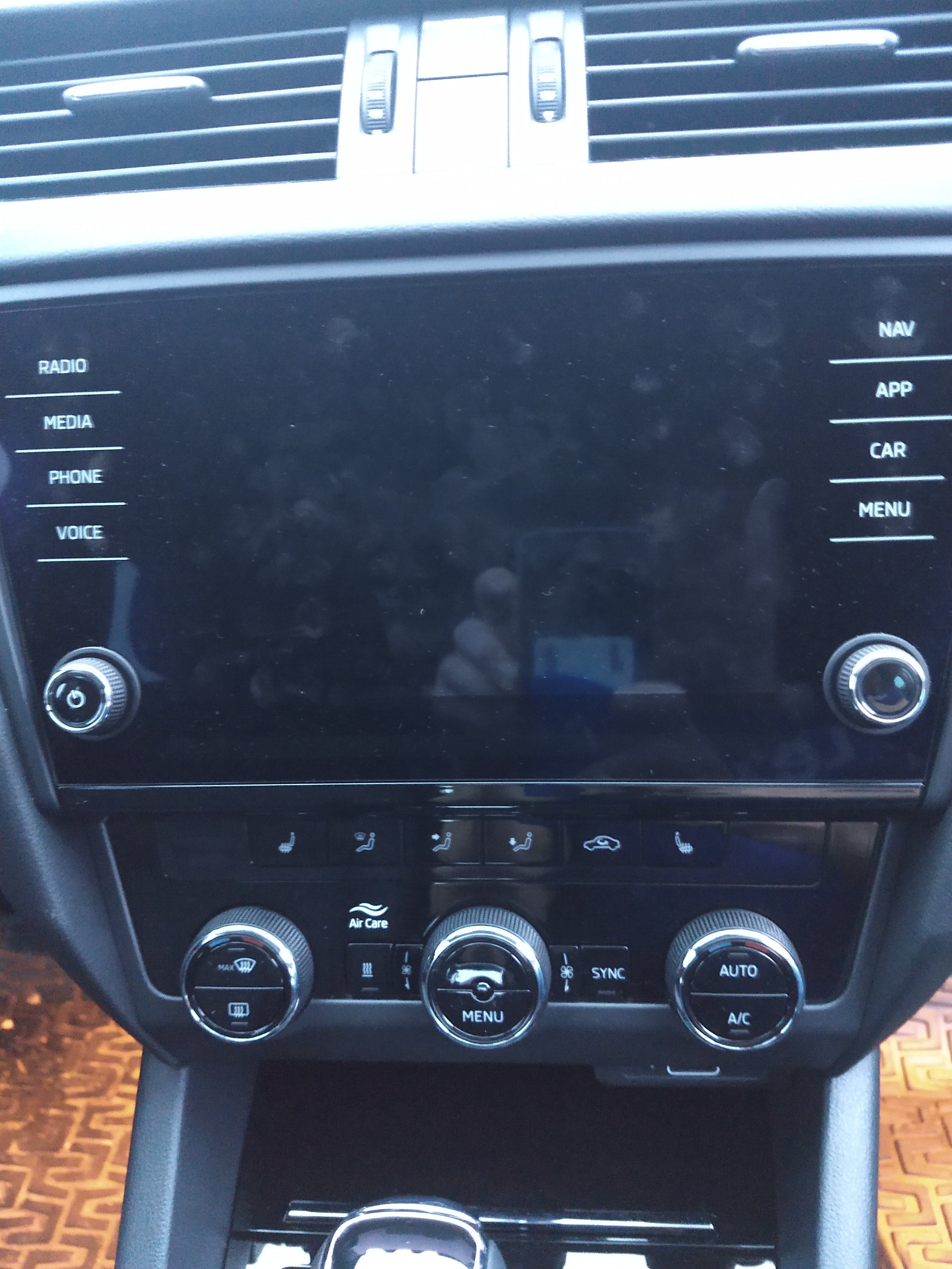

Might be a good idea to post a picture of your Amundsen...
37 minutes ago, PetrolDave said:
If you have a 2020 Octavia then you don't have an Amundsen+, you have a MIB2 Amundsen.
If you have a 2021 Octavia (new shape) then you have the latest (MIB3?) AMundsen.
Googled pictures and my Amundsen is an mib2
