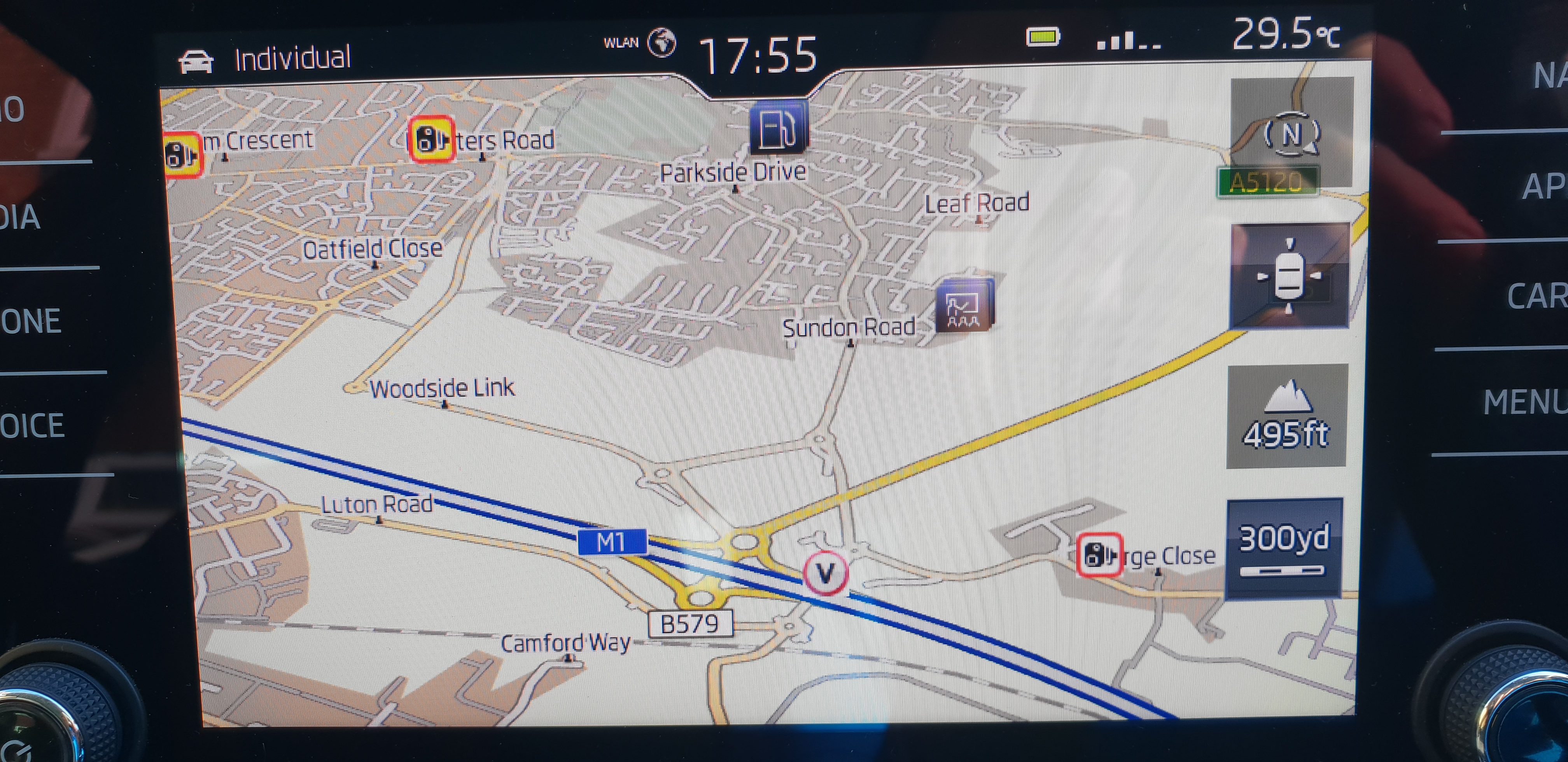

I have managed to load your latest version of Speed Cams (June 2018) onto a new Amundsen and all is working fine on major roads etc, however, there doesn't appear to be any Motorway Speed Cams is that correct?
As I have time left on my PGPSW subscription from a previous car (Nissan, no problems loading POI's on that car) I thought I would try using the Skoda portal to convert the files as per instructions and whilst it sent back, what was supposedly the correct files to load onto my unit, I keep getting an 'Error' message each and every time I try to update the software.
Your files appear to be the only ones which work but it would be good to have the Motorway cameras, perhaps they are there but not showing on my unit for some reason?

With regards to the issue of no Motorway cameras - I freely admit to borrowing a third party database which to the best of my knowledge displays any static i.e. fixed gatso cameras if indeed there are any on the motorways. Perhaps there are none or the database does not cover it. I can say with certainty though that It certainly displays the average and variable speed cameras situated on different stretches of the M4 in South Wales. If you're referring to mobile cameras - I deliberately omit these from my compilation since unless I use a very up to date database and update my files on a very frequent basis they wouldn't really be very effective. Hope this helps.

Regarding the motorway cameras I'm not sure what type are installed, however, I had the pleasure of driving halfway round the M25 and part way up the M1 the other day and the only camera that showed up on the map was the variable camera at the Dartford Crossing?
I'm due to drive the other way round the M25 and down the M3 shortly so I shall see if any cameras appear on the map then.

Thanks for posting this update... Works a treat.. and much better with the addition of those hidden ones on the M1!
