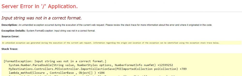

@bigade1 Back in now and still the same Im afraid. This is the same error that it throws back at me no matter which file type I use.
I have tried three different file types now uploading a single Gatso file every time but still this error pops up:@

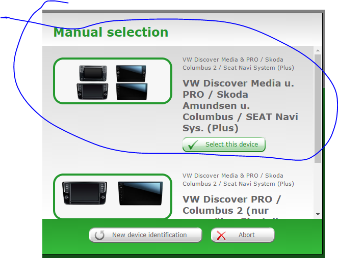

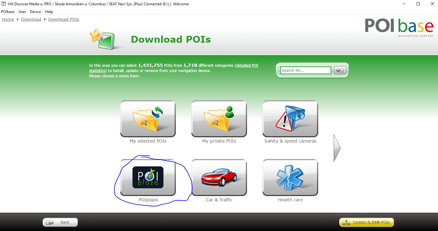

when setting the poibase program up select this one, you'll need an sd card inserted.
then hit download and select poiplaza
next add which cameras you want then synchronise.
when done you can add to the nav.
