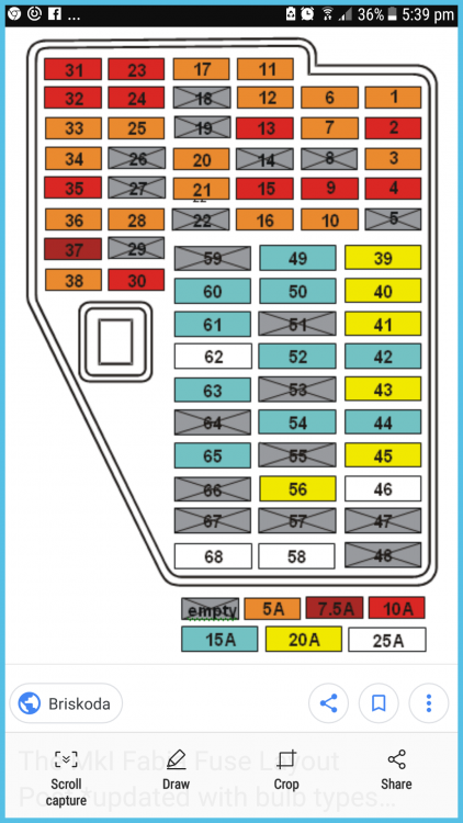

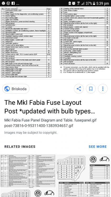

Bugger. Rear wiper is a mini fuse and I've lost the mini fuse piggy back adapter. Any idea if any of the full size fuses are ignition hot.Screenshot_20180220-173936.thumb.png.9eb200420334fbb2da2ade1d2e784888.png
Buy another adaptor if needs be, I'm sure it will be a couple quid at the most.
Edited by retro
  • Sponsor
No.52 should do it.
I couldnt find any big ones that worked so just bought a mini adapter.
I used fuse 68, the fan/blower motor. It's ignition switched as you need, its 25A, and if it blows the fuse you won't be left stranded. Just hot/cold until you can replace it
